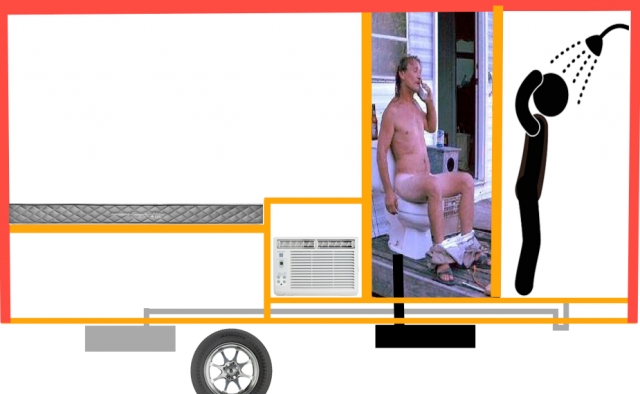

I'm thinking about raising the floor just enough for a 1 1/2" pvc to go over the floor then down into the tank. That well mean I will have to cut the floor under the shower, let the P Trap hang under the floor, come back up over the floor pass the cross member and drop down to tap into the tank.
Tomorrow I may be able to draw a sketch explaining all gibberish above.

I will be combining Don, Hank, Iconfabul8 & McDave's Ideas to solve the Tanks dilemma.
I will raise the floor by about 2". Drop the shower p-trap through the original floor bring it back up above the original and under the new floor, run it just pass the axle an drop it into Tank. I will not have any 'Driveway Drag' because the tank will be about 4' from the tail.

Postby Hader » Tue Oct 25, 2016 9:12 pm
Hader
Posts: 306
Images: 84
Joined: Mon Jul 04, 2016 5:00 am
Re: Another way to skin a cat.
Postby Iconfabul8 » Tue Oct 25, 2016 9:46 pm
Cool! That looks like it should work. Get a few pictures, cuz I still have to go through this.

Postby McDave » Tue Oct 25, 2016 10:58 pm
Hader wrote:Image
See, now this is what happens when you spend too much time in the "planning phase"...Idle hands and all that..
I like it.. :D
Postby Hader » Tue Oct 25, 2016 11:26 pm
I like it.. :D
McDave
I just couldn't think of another way to explain it.
Hader
Posts: 306
Images: 84
Postby hankaye » Wed Oct 26, 2016 9:34 am
Hader, Howdy;
Dang Hoss!!! Post a warning!!! almost spit coffee all over the laptop . :? :lol:
hank

Postby Hader » Wed Oct 26, 2016 10:06 am
hankaye wrote:Hader, Howdy;
hank
I promised Iconfabul8 to make a sketch for the plumbing, and thought what the heck let's add a bit of fun.
IMHO it makes it more like a college learning-aid or court exhibit.
