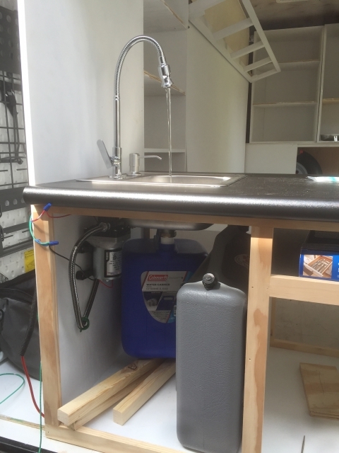

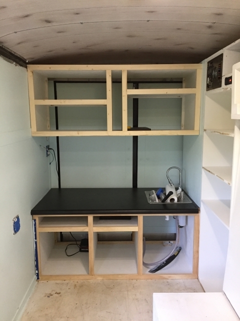

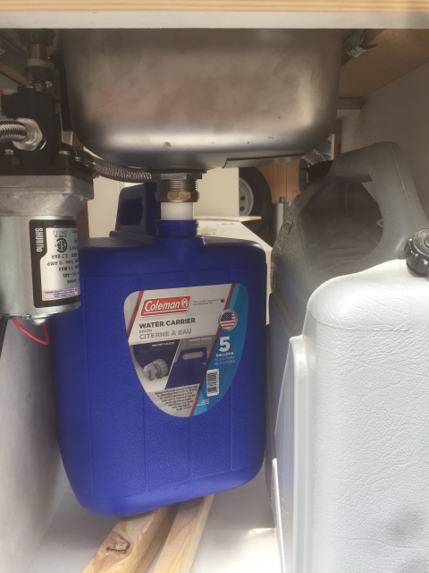

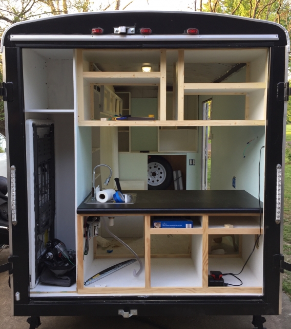

Lynne worked on priming all the new stuff while I tackled the kitchen sink. (there's an "everything but" joke there somewhere, but I'm too tired to think of it) The idea is that we'll pump water from one of two 5.5gal jerry cans and use a shorter 5 gallon jug to catch the waste. This way the water will be easily removed and stowed wherever I need it to be for weight purposes, and I don't have to figure out any water tank installations...which is nice. We're using a shurflo revolution on demand 3gal/min self-priming pump we picked up on sale at Amazon. Here's a pic of the pump and water containers:
I've got the waste container propped up because I forgot to buy a small piece of discharge hose last time I was at the store and didn't feel like making a special trip.
So after about 3 hours, we can successfully pump water from one bucket into another. Hooray!
Oh, and the wiring is temporary for trial purposes. I'm going to install a lit switch somewhere behind the faucet-just need to figure out a few other things to decide where.

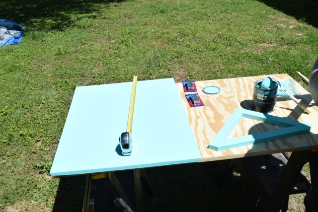

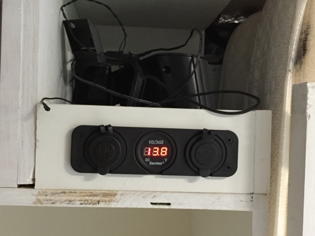

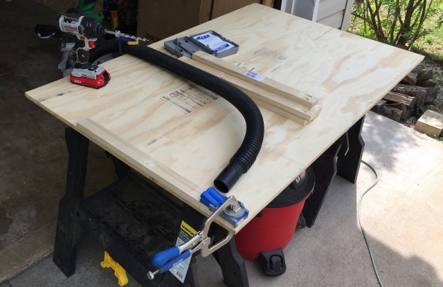

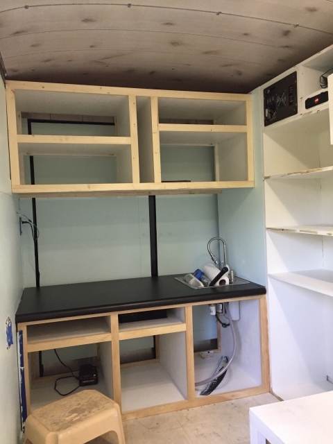

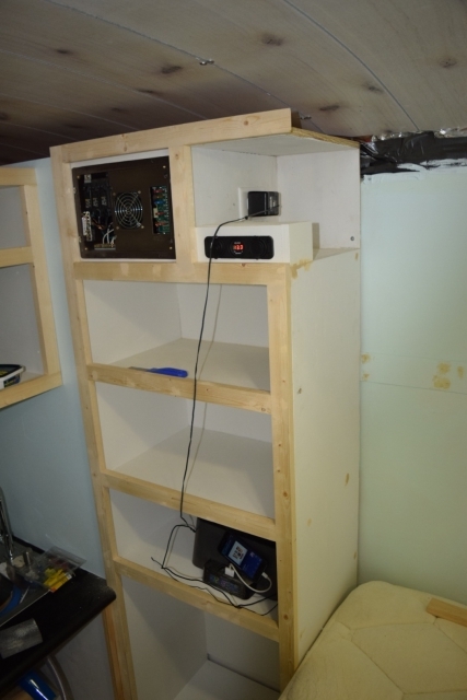

We had a busy weekend with work and Easter things, so we only got a few hours in on the trailer. Lynne worked on giving it some color while I worked on face-framing the upper kitchen cabinet and installing the 12v receptacles/voltmeter.
The shop vac worked nicely to keep the sawdust out of the wet paint and mostly out of the garage.

I also realized while measuring for the face-frames on the middle and front cabinets that my bed board and legs are a little too long to clear the extra 3/4" from the boards, so I took the leg off and will need to cut it down to rebuild it this week. There's not much worse than having to take apart something you already spent your time making, so hopefully it goes quickly.

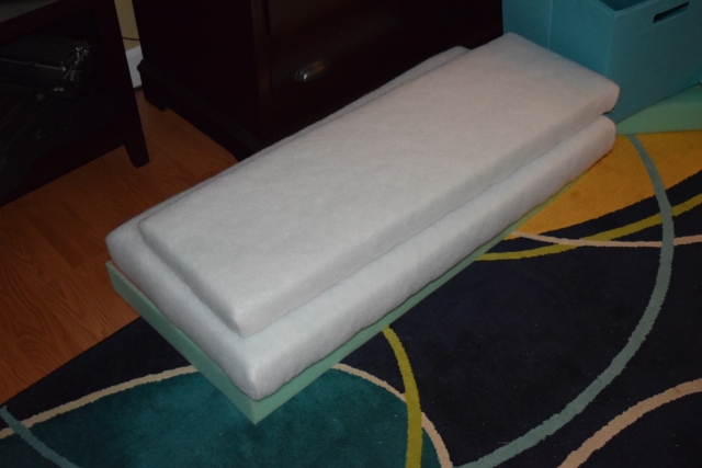

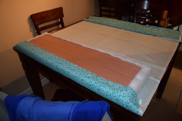

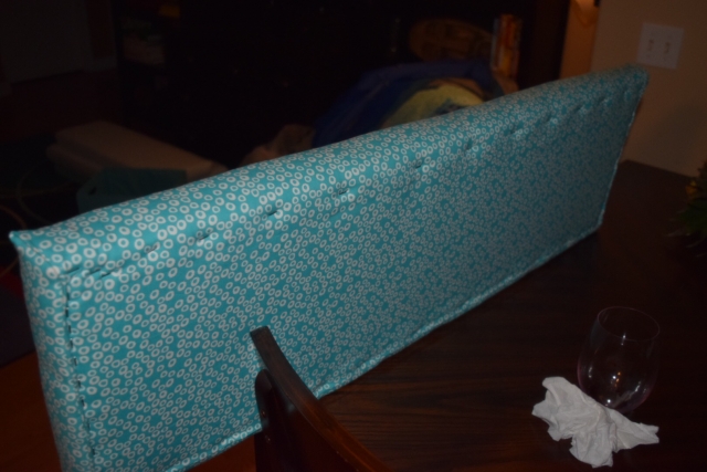

With a visit from Lynne's parents and a couple of concerts to attend, the weekend off didn't see as much work done as we'd hoped. We did manage to get a few things done, and we definitely took advantage of her mom's fabric and cushion expertise to get some cushions made for the bench.

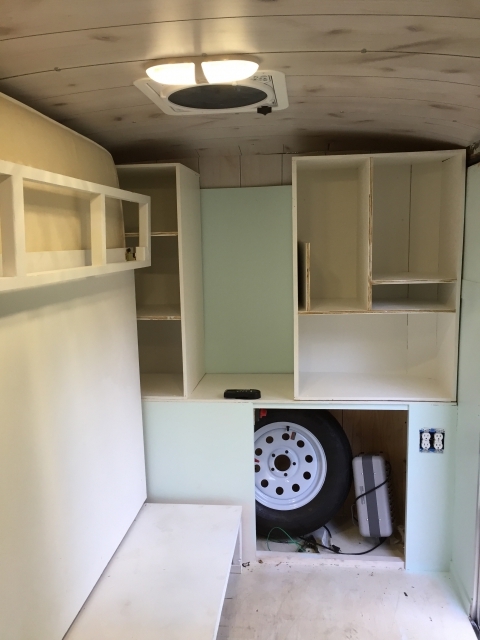

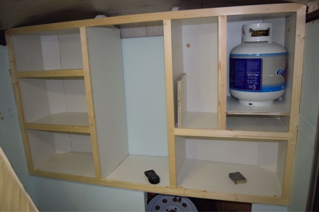

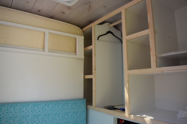

With the girls inside making cushions, I worked on yet more cabinet facing. I think I"ll make this in my sleep for a few months...
It got a little tricky with the curved roof and the odd middle shelf, but I think it turned out pretty good considering.
I also had the chance to put in the closet rod for the hang-up clothes. I just cut and drilled a hole in a couple 2x4s and put a wooden dowel through them. I didn't drill the hole all the way through, so I could put a screw in the end to hold it in place

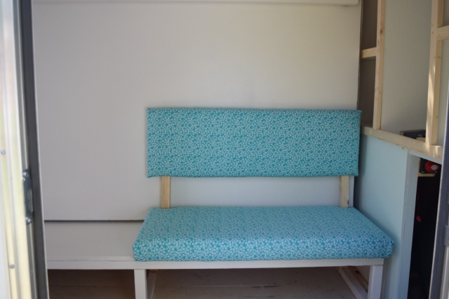

We also tried out the cushions to see what they'd look like. We plan to staple some industrial strength Velcro to the both the cushions and the bench to hold them in place.

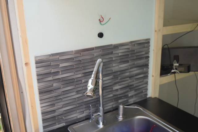

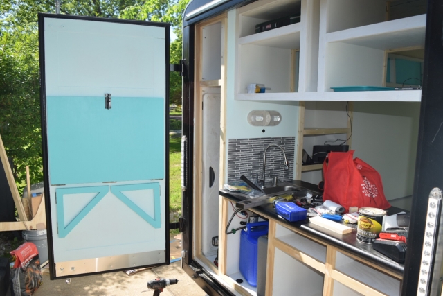

I put the tile back-splash in and drilled a hole for the pump switch.
With that done, I installed the fold-up table inside the trailer and built the triangle supports.

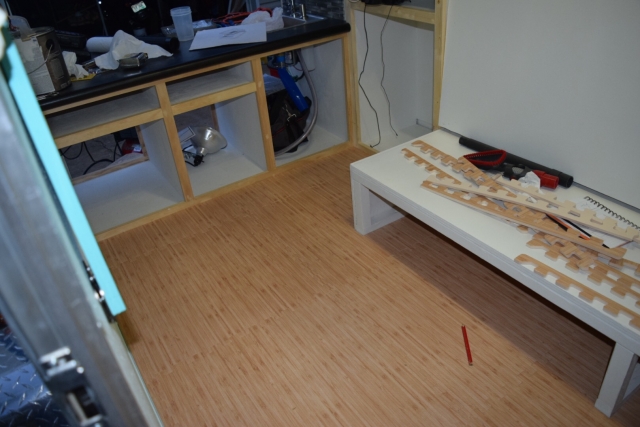

Lynne got home and worked on some painting and I decided it was time to put the floor in. We decided to do something simple, and like the idea of foam exercise mats because they seem pretty cushioned, would be easy to put in and replace if damaged, and seemed like they'd help insulate a bit. I have no idea what the R-value is, but surely not bad right? We found some wood printed mats on amazon.
I think it looks pretty good, considering the material. Plus cutting it to fit with a box knife was pretty cake...

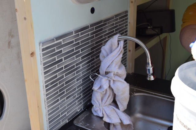

We grouted the tile back-splash (which was a PITA with the faucet installed) Next time, I'll know to wait to put the faucet in until after the tile, but no way I was going to take it out and put it back...

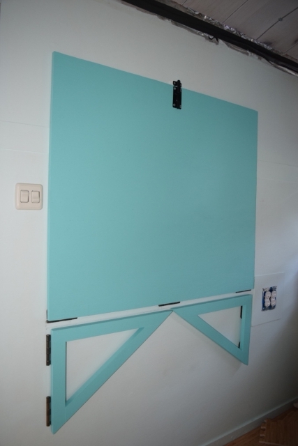

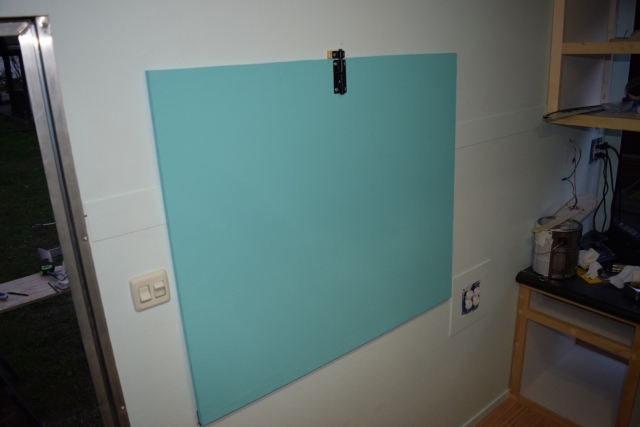

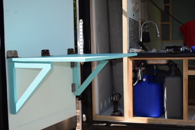

We finished up the interior table and got to work on the fold up table on the back door for extra counter space. With a little extra room (and smaller dimensions) I was able to make the rear table out of true 3/4" plywood, so it was much sturdier for slicing, dicing, and other food prep duties. For the supports, I used left-over 1x2s from the cabinet facing and glued and tacked them together with a brad nailer, then installed a couple hinges on each to allow them to fold against the wall when they aren't in use. We got most of the hinges at the Habitat ReStore for $1 each, so I probably used more than it needed, but what the heck - better safe than sorry right?

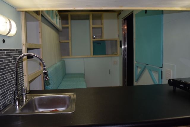

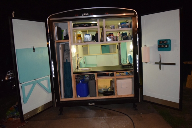

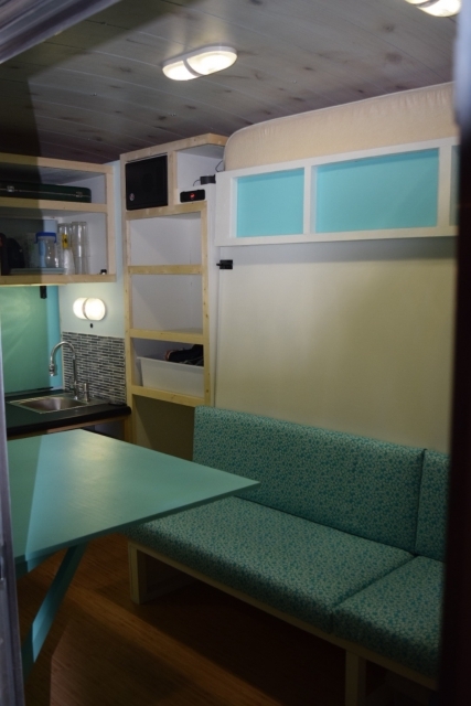

Lots of cleaning, small details, and packing it up a bit for our trip saw us finishing up after dark. We took the time to take some pictures though before we headed inside.
We still need to build and install cabinet doors and need to do lots more painting, but we're pretty happy with how much we've accomplished before our trip.
Here's what we've got to work with for its maiden voyage to five national parks and two national monuments...
