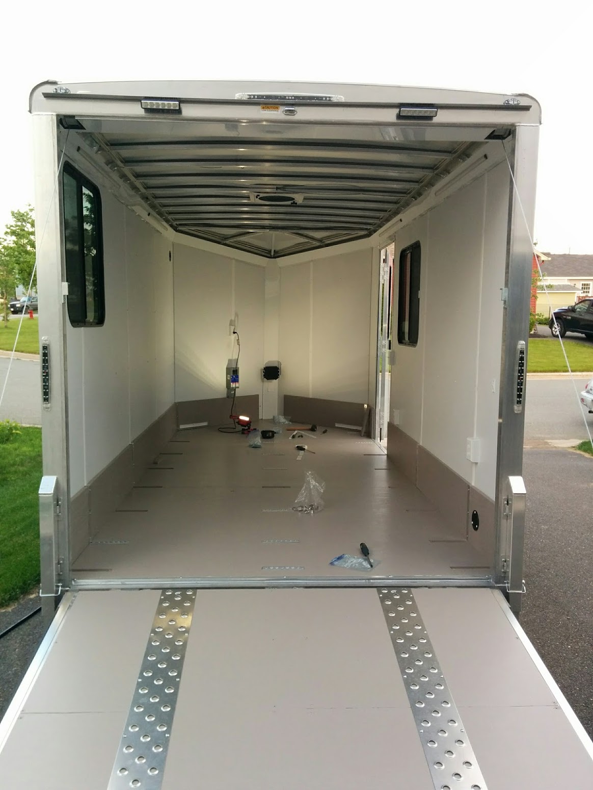

Attaching image, not sure what is up, there is usually no issue with hosting from Google Photos.
Currently with wires hanging down everywhere, final stretch before the weekend.

Postby Vspec » Mon Jul 03, 2017 8:28 pm
First weekend report:
I finished running the wires but ran out of time to connect everything to the distribution block. First and second night, I ran a single circuit with a 12v PSU (mostly the fan) but by the third night all was hooked up and it was glorious!
Next step is to get the e-track loft bed built/installed, even with the inflatable queen widthwise, the cot was too long and taking un-necessary space.
Also gotta streamline the setup/teardown routine. Luckily with the double axle and rear stab-jack, the trailer is pretty stable.
No more progress for a few weeks as vacation calls!
