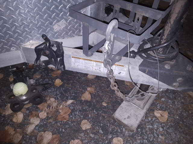

Dano-Mich:
My NEO tongue is 2x4 on 7'x16' trailer:
I've never had problems using WD hitch. We've driven over 35,000 miles in 3 years towing our CT all over Canada and USA.
