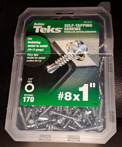

I'm trying to put up some furring strips on the ceiling. The screws I'm using must not be the correct ones because "it ain't working!" I've tried the Teks Self-Tapping Screws #8x1". What have you tried that worked for you? Ideally, I wouldn't want to pre-drill if I did not have to.

I'm not sure that it is dulling the screw to any noticeable degree.
I'm using a corded, plug in drill and applying way more pressure than should be required. (As a side note, I've got the strength of 10 men... even though they are very old and very tired men! :-)
I did try a tiny pilot hole to help get things started and it didn't make any difference.
Those who attached furring strips, did you use a screw with a sharp point or one of these self-tappers? And did you have to prep the spot with a pilot hole?

Postby tylerjd » Wed Feb 21, 2018 7:28 pm
Pic of the screws I used (with a pretty normal plug-in drill):
The pine furring strip took a pilot hole to prevent splitting, but no pilot hole for the metal.

Postby hankaye » Wed Feb 21, 2018 8:13 pm
tylerjd, Howdy;
Looks like they coated the cutting edge of the screw when they did the treatment.
Take them back and see if they offer any without the coating ... orrr you could burn
through the strength of 6 of those feeble old farts and wire brush off the coating
from the screws you have. Idle hands and all that crap you know the saying ...
If the box store doesn't have anything else try Fastenal.

Postby Padilen » Wed Feb 21, 2018 8:33 pm
Self tapping screws aren't the same as self drilling. Some are both.
