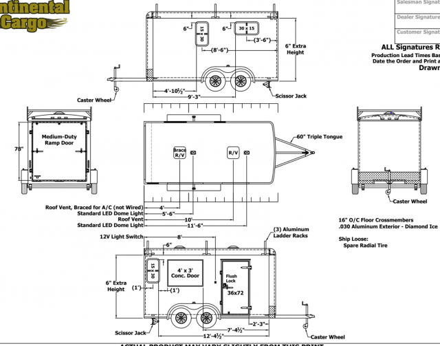

Just got my CAD from the dealer... :D it's missing the jack on the front end, but I think other than that it's good to go! 6" Extra on this trailer gets me 7'3" in the middle and 7' flat on the sides. I'm 6'6". Sprinter Van cant beat that!!
The concessions window is my attempt at having more "windows" while being more secure/stealthy.

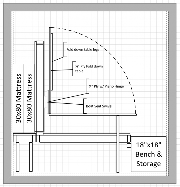

Spent a few hours trying to design the bed and table system.... wanted a queen size fold-down bed, a bench to comfortably sit at / work from, and a table that would fold down from the table and reach the bench at a comfortable height. It took way more math and measuring than I expected. Notably, the table had to be narrow enough to not be in the way when the table folded down and had to be mounted high enough to be at a comfortable height. I've been staring at it for a couple hours now... but I think it all jives. It's absolutely inspired by Glenlivets CTC http://tnttt.com/viewtopic.php?f=42&t=46134
I tried to have the table just fold down across the "aisle" if you will but the length required made + the height of the top surface (table height) made that not work. Stumped. Remembered seeing someone build a murphy bed with a boat seat swivel as a hinge point... so attach a boat seat swive, to the bottom of the bed, a piece of ply attached to the other side. That piece of ply has a piano hinge on it and then the table surface attached to that! The table will be stored "sideways" and when I want to use it, rotate it up, and fold it down. Feeling pretty good about my design! Please poke holes in it tho!!
I tried to draw everything to scale and I think it's all pretty close!
Looking into the trailer from the rear:
Side view as if the passenger side trailer wall were removed: Shows both the stored (horizontal) and the ready to fold down vertical orientation of the table

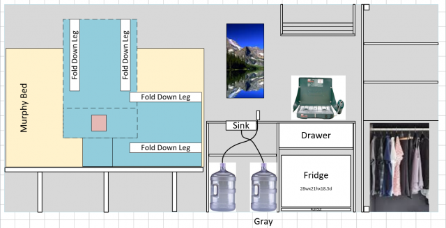

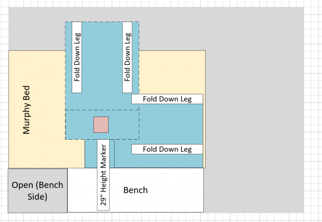

Postby sodatrain » Wed Jan 10, 2018 8:28 pm
Been working on refining the designs. Here is where I'm at:
Bed / Table Side Detail - Bed folds down, two mattresses side by side = a queen. Table on the underside of the bed that rotates and extends to the bench.
Bed Platform Detail: top looking down
Interior Drivers Side:
Interior Passenger Side: Semi Transparent layer is a concessions window
Thinking about building this as the bench: https://www.remodelaholic.com/diy-stacked-plywood-bench-tutorial/ - easy to build in advance of picking up the trailer.

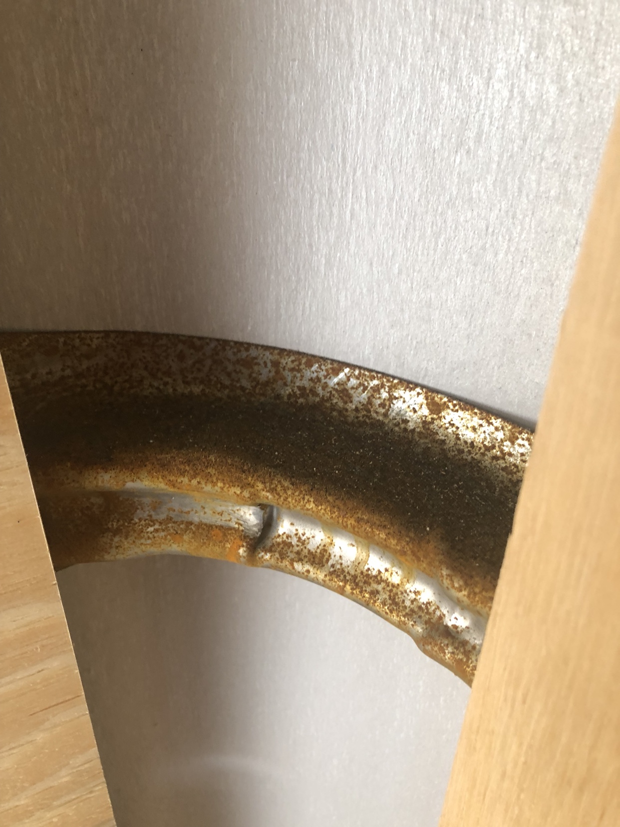

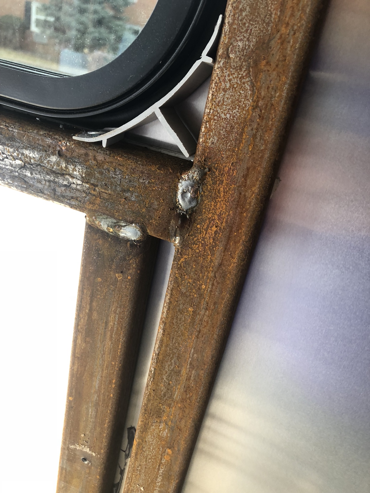

Starting to take plywood off and seeing lots of frame rust... That seems bad. Is it?
Most of what is visible has been sprayed and looks nice.

I think that rust is just surface rust.. They really don't paint that stock steel going into the walls. Both my CTC's had that type of surface rust when I took them apart to insulate.
While I had all the interior plywood off, I sprayed the 3 sides I could get to with Rust Oleum Stop Rust paint.. It should be fine if you do that.

I wouldn't worry about the surface rust too much. When I picked my trailer up at the factory I noticed a bunch of unskinned trailer frames sitting out in the field. So I can see how it happens. Once covered and dry, it isn't going to keep rusting. It is however a little unnerving to buy a new trailer and find rust. :(
