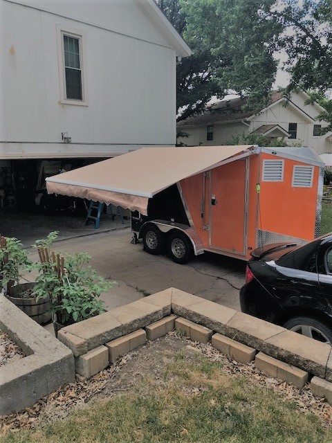

Got the fabric mounted correctly. Wasn't really too hard, also fixed a couple of small things while I was working on it. I have the same issue with the door hitting the arm when deployed. Just live with it for now. It opens about halfway before it hits the door. Or, open the door, then deploy the awning.

You could probably take some of the angle out and improve that somewhat. It looks to be very steep pitch. You may want to set it up so that you or the tallest person can just walk under the front rail without head contact, safely. Let that dimension determine the pitch when deployed. That was where I started because I am accident prone, really. Then if you need to elevate the roller assembly to clear the door you could basically just block it up 1-3". Just try to keep the pitch around 80 deg to the wall to ensure drainage vs pondage. Water is heavy at the end of a 8ft lever.

Thanks again for the help. Aleko didn't have an awning in orange and black, so the sand color was the second choice. Looking at the adjustment on the arms it's already at max for raising. Came from the factory that way. You say "block it up", do you mean some poles or supports on the end? I thought about that and still may do it. I just have a bunch of small jobs to get done on it before Sturgis, may get back to it. I think I did every possible thing wrong getting this awning on, but I did learn from it. I did order some magnetic screen doors for side and back door. Not too expensive and some folks have pretty good results with them. I like the "nauga" reference. I call it imitation vinyl.

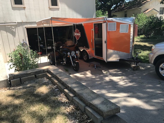

The Tri-Glide fits nicely under the awning if we need to. Pretty much all set for Sturgis.

That does fit nicely. It's just so handy to have shade/shelter ready to deploy. If you are in Kansas I am sure you are aware of how fast the weather can change in S.D. at rally time. In over 20 yrs of attending I have been caught in storms every time at least once. Some are very severe, Heavy rain, wind at 50+, large hail and possible tornados. And then it will be 102f until sundown, then 40f till sunup. We haven't really had much heat this year but many severe storms. Then again this could be the year for perfect weather, yeah, that sounds like a plan. If you are riding when it looks like a storm is headed your way, try to find a Bank drive thru or some other type of cover and just wait it out. It can be brutal and scary to ride through a storm and I have seen some badly damaged scoots from hail as well.

Yea, I got some telescoping poles from Cabella's. I really like them, well made. They prop up the far end of the awning perfectly. It will be about a 10 minute setup time.
