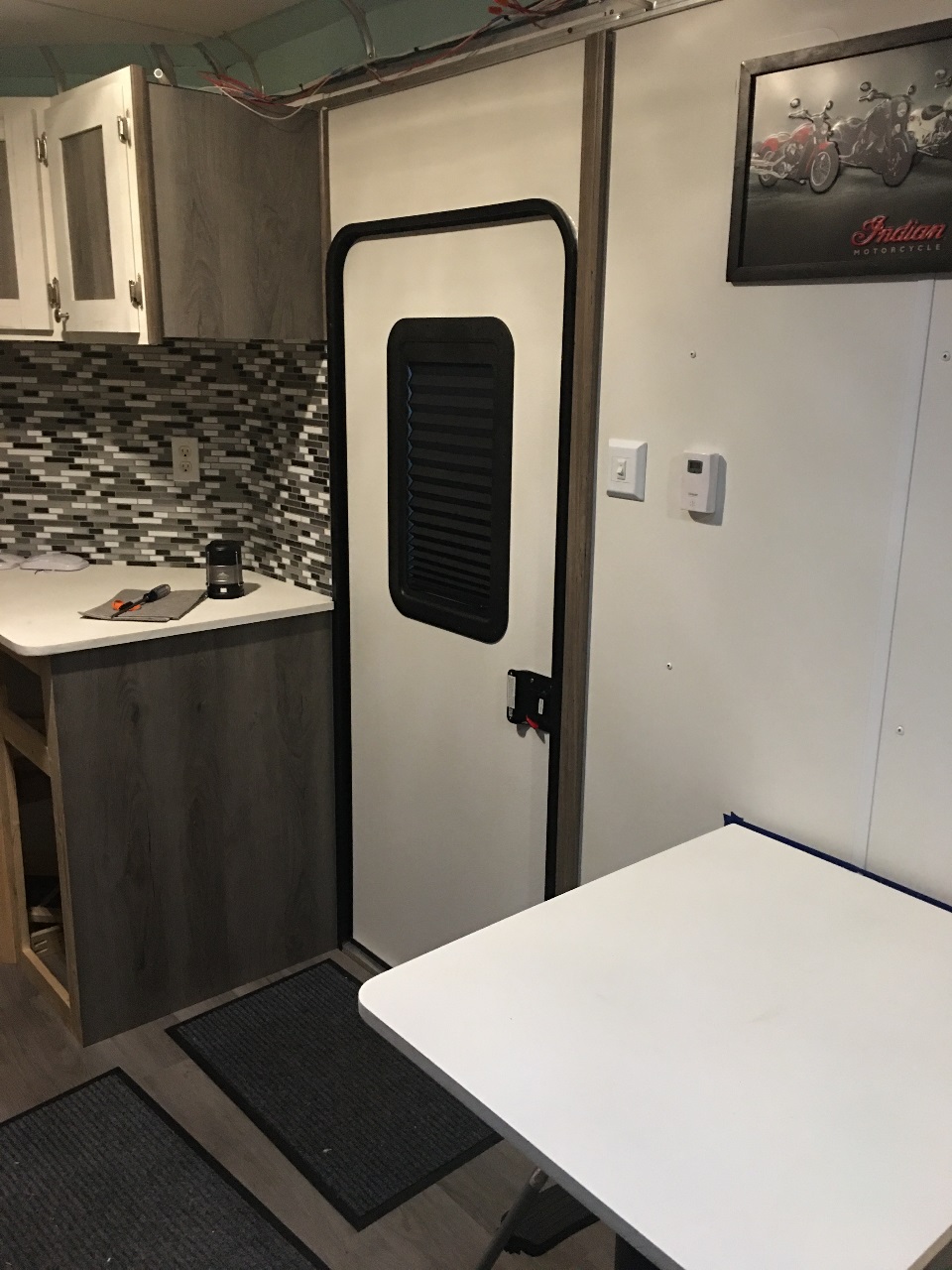

Postby chiefvintage » Sat Feb 15, 2020 7:26 am
A few more pics of my progress so far:
chiefvintage

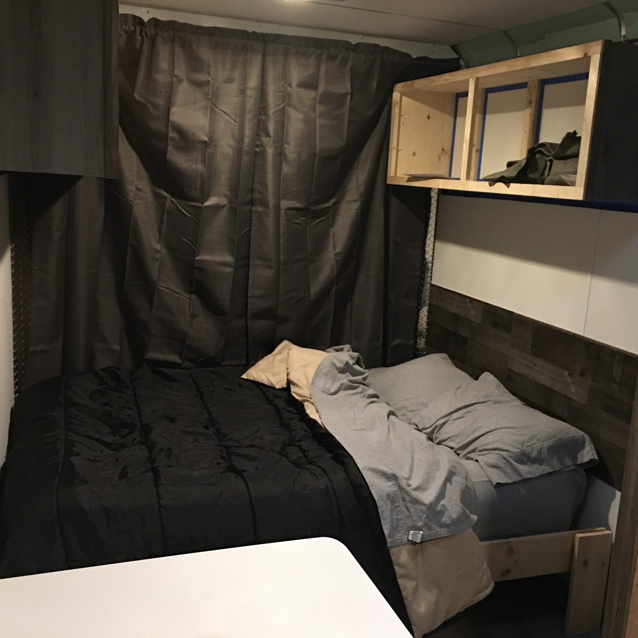

Re: 7x17 Cargo Trailer Toy Hauler
Postby chiefvintage » Sat Feb 15, 2020 7:28 am
And a few more:

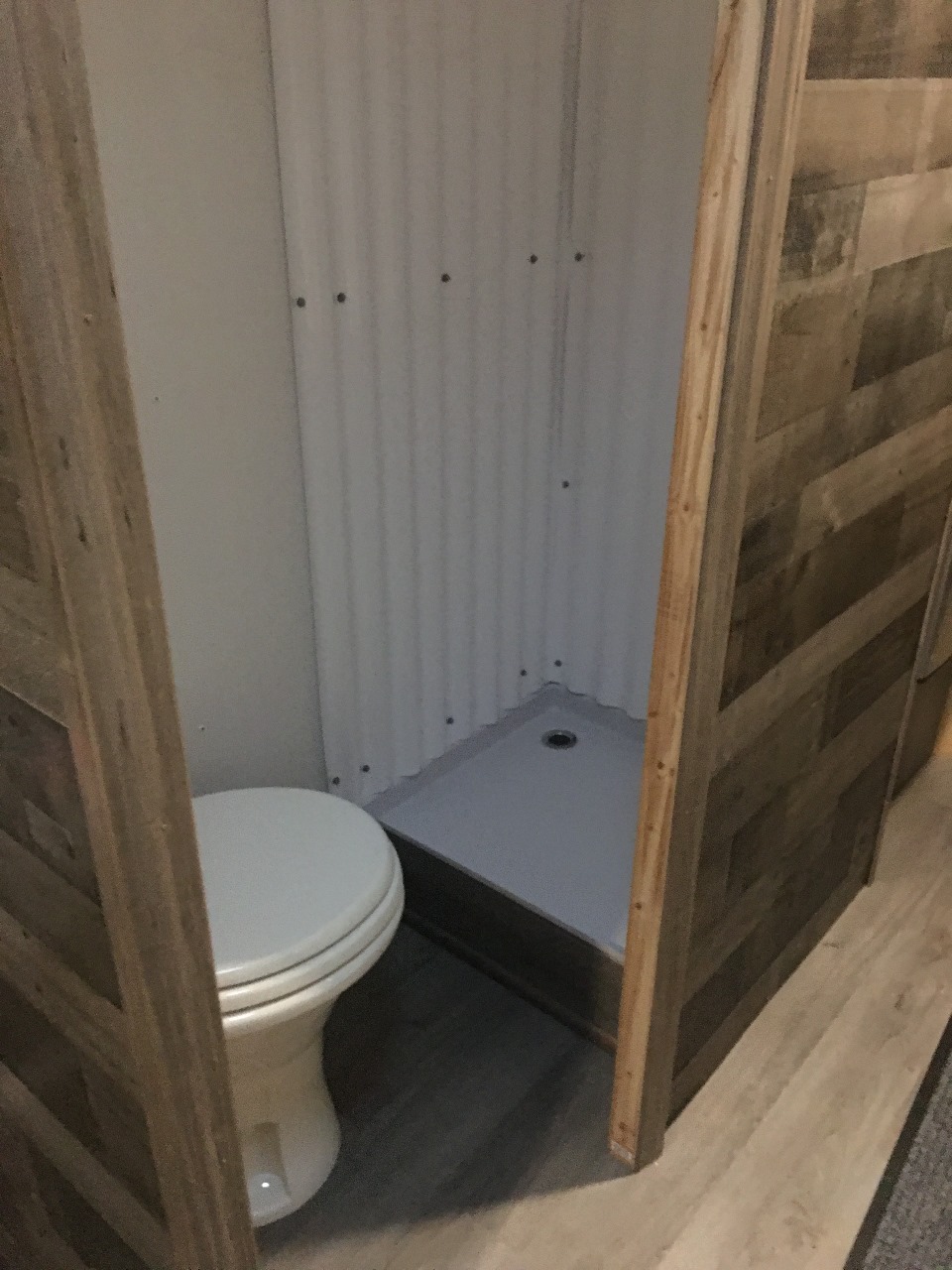

Postby chiefvintage » Sat Feb 15, 2020 7:30 am
Last one:

Postby McDave » Sat Feb 15, 2020 12:12 pm
Wow! Super nice job on the décor. I really like the kitchen cabinets and backsplash. Great shower too. You have been busy this winter! Excellent progress. You will have a great trailer for riding season. Congratulations. :applause: :thumbsup:

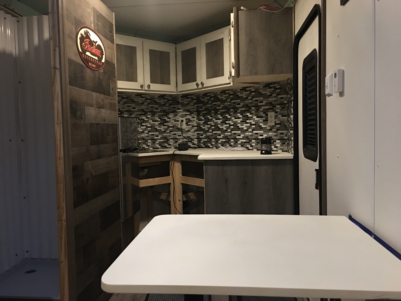

Postby chiefvintage » Sun Feb 16, 2020 4:00 pm
Entrance shot
