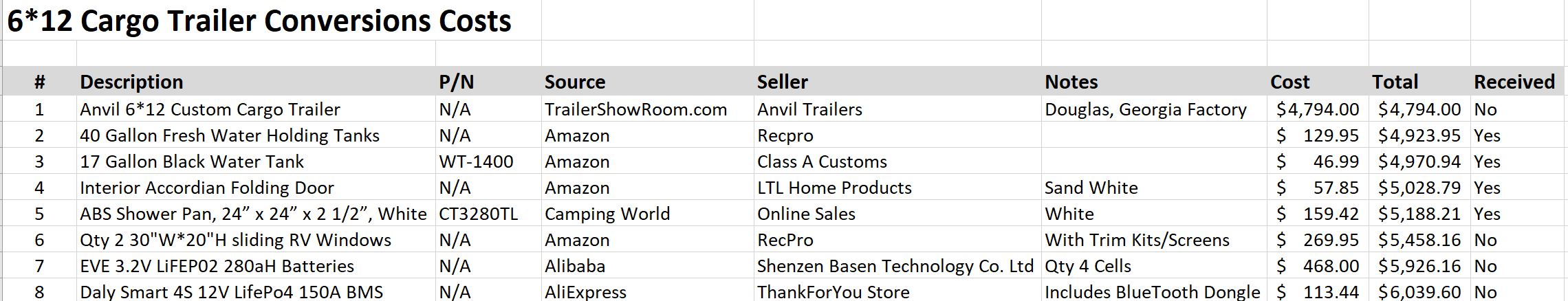

Postby flboy » Mon Jan 25, 2021 9:51 pm
Ordered so Far. I will Update and repost as I go which should result in a full list. I am trying to figure out how to draw up build plans on the computer... maybe can get some help? with anyone familiar with the Software packages. I have a pencil sketch I could share... Not sure I want to spend the effort needed for me to draw this up on the PC.
