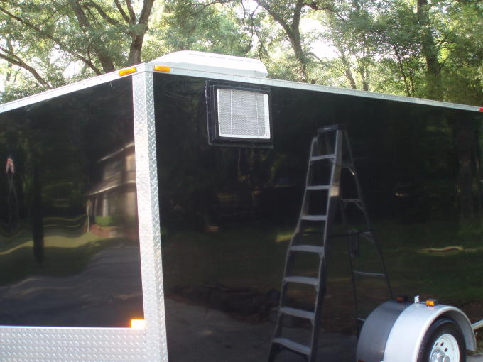

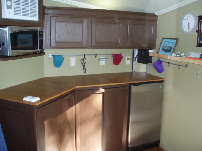

Postby Archam » Tue Aug 23, 2011 8:41 pm
Here is a picture of the KZ travel trailer 5k a/c installed in my CT. Works Great!
http://tnttt.com/album_ ... c_id=79634
http://tnttt.com/album_ ... c_id=79636
Walmart AC Unit 89.00
Shroud from KZ 33.00
Refrigerator roof vent 30.00
cabinet work homemade

That's what I was talking about, built into a cabinet up high like they are suppose to be.
Barb has one up high mounted on a shelf with rollers she has a big door up high just open the door and roll it out.
I like both ways maybe through the wall with a window awning over it to help shade it from the sun?
