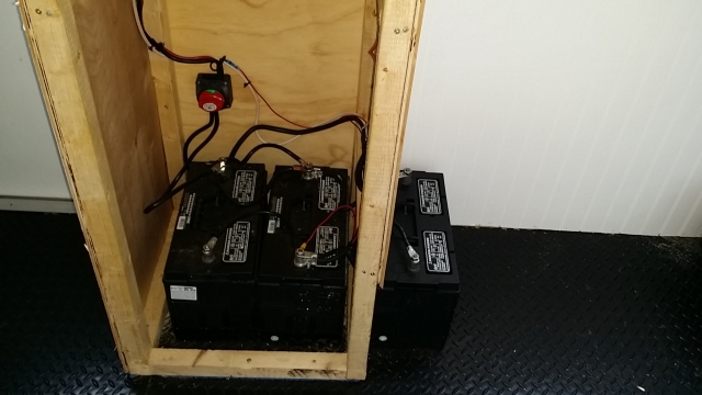

Re: 7'*18' V-Nose Cargo Trailer Toy Hauler Conversion
Postby flboy » Tue Jun 21, 2022 7:59 am
Staryder61 wrote:Thanks Don, looking them up, there are so many to choose from.. when you get a chance, could you post a pic. of the ones you're using.. Thanks again.
This is what I have. Got them from SAMs in December 2018. They are the 215aH version. I have 4 of them in a 12v configuration for 430aH with 215aH which is useable at the 50% discharge limits.
Sent from my SM-N970U using Tapatalk
Postby Staryder61 » Tue Jun 21, 2022 11:23 am
Ok Don, Thanks again, that helps :thumbsup:
