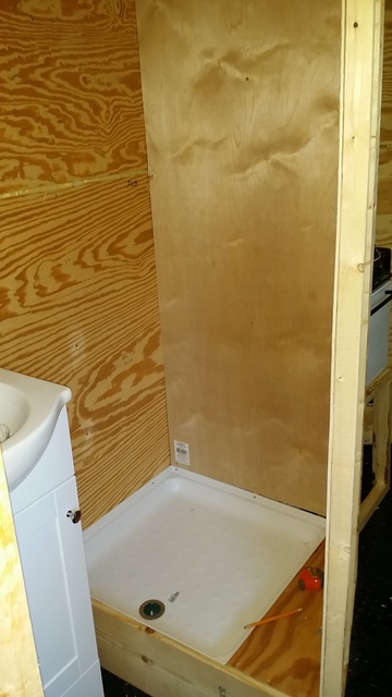

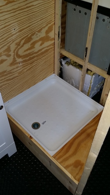

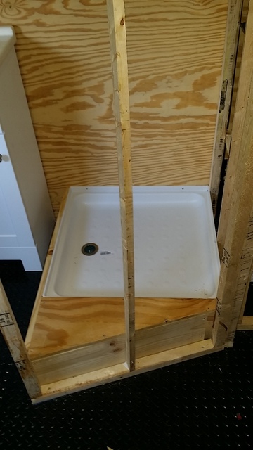

Worked on the shower today and did some paneling. I bought FRP (Fiberglass) Paneling to waterproof the shower walls, but I got the backer board up, the shower drain in and the "wedge" built". I will waterproof that with some linoleum and then seal the to the shower with a 3/8 inch metal strip. I'll take some pics when done... it is hard to explain what I have in mind.
This wedge area adds space to the shower and entry into the shower. I did not want the whole shower 34" wide as it would have taken too much space out of the kitchen area. I can move around in this "odd shape" well. The Shower curtain will go across the entire front.
Will glue the FRP Paneling on and trim it out. It will extend over the backer board down into the shower to seal. This is going make a nice shower. It fits me well :-)

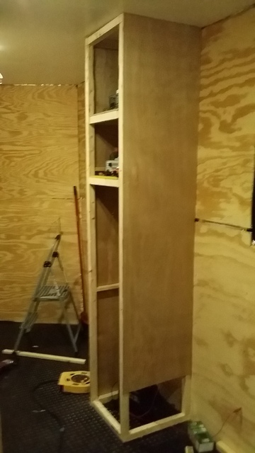

I paneled the entry closet so I can finish the electrical work and install switches and etc.. The 1ft. gap on the bottom is to connect up the battery compartment which is in the closet and will partially be under the dinette seat (room for 4 batteries... will install 3 to start) . I will seal all that up and vent outside when done.

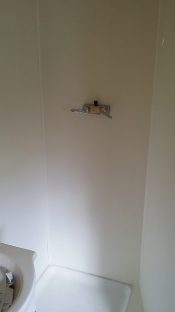

I got the shower walls up to the point I just have trim work, some caulking, glue cleanup, and to hang the adjustable shower pole that you can see setting on the corner. After I wrap the bathroom up this week and get the electrical mostly hooked up, I will start on the kitchen. We'll see how far I get this week. Not a lot of time in the evenings. Just an hour here and there.

Postby flboy » Mon Jul 25, 2016 9:43 am
The shower walls are in. I glued FRP paneling (it is fiberglass reinforced plastic ) on to the underlayment. You can get 4'*8' sheets at Lowe's or Home depot. I also decided to use a piece to cover the plywood Triangle that I incorporated into the shower for some extra elbow room.
The FRP was easy to work with. It cuts well with a razor knife and is waterproof.
You probably can't tell from the pictures, but the FRP paneling has a nice non-slip texture on the front side.
