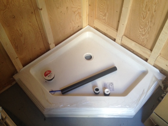

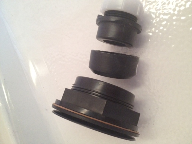

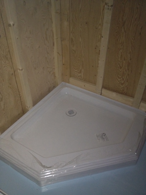

OOPS Big problem when dry fitting the shower pan
Thats right, I gotta get the saw saw out to cut out the pesky tongue cross beam right under the shower drain,
what do you need that for anyway :cry: :cry: - damn I hate when that happens. :x :x
photo 2-1.JPG (97.33 KiB) Viewed 2538 times
Just kidding, none of you guys thought I was really gonna do that :D :D :D SUCKERS !!!
photo 3-1.JPG (94.2 KiB) Viewed 2538 times

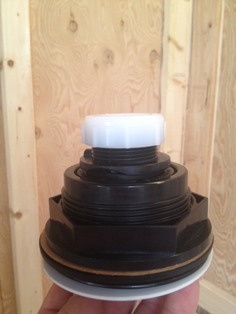

Above is the solution to the standard 2" shower drain configuration.
photo 4.JPG (75.82 KiB) Viewed 2538 times
This is a 1.5" reducer & then a second reducer to allow a 1.25" metal standard sink drain to be installed,
giving me just enough room to clear the cross member by what old carpenters refer to as a C*#^t's hair
I might even have to notch the wall studs a little bit to get that much - clearance.

I found this shower pan for only $112 on sale and its SUPER light 2" foam on the under side.
this time I will most like not install the glass tiles, at least not to start with.
I will use the short front wall for my shower fixtures & will use the short right side wall for some of my 12v electric switches
you got it.... OTTCT will have a fully electrified shower wall ..... NOW he is really nuts -O- off the rails.

Postby OverTheTopCargoTrailer » Thu Jun 27, 2013 9:29 am
The Jedi plumbing master has landed

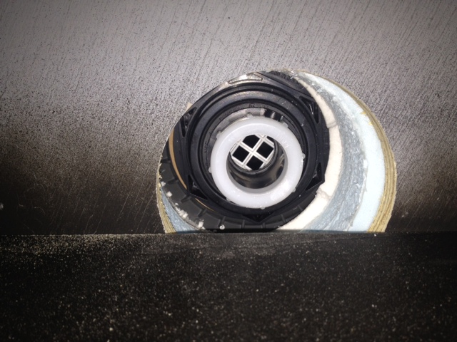

At the bottom most picture it can be seen that the shower pan sits on-top of 1.5" of Dow blue board foam ,
the shower will also have 3" foam on the walls, so I will be ready for hot showers at ice station zebra.
The bottom of the pan has additional 2" of foam So that is 3.5" total foam under my shower.
You won't find that in your standard RV.
Click on the "ABOVE" picture to see the blue board, to this date I have not seen a cargo trailer with foam on-top of the 3/4" plywood,
although I have myself put it under the trailer - where it was not effective due to thermal bridging.
Now I have enough room to install a 1.5" black plastic drain or a 1.25 silver metal sink drain
I do have to say the shower pan is bigger then expected.

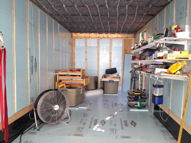

Postby OverTheTopCargoTrailer » Mon Jul 01, 2013 11:31 am
Since Im ready for my test, I can see today won't be so hot :x :x :x normally I can feel the burn when stepping outside already.
tomorrow should be over 100 however
photo 1-2.JPG (141.46 KiB) Viewed 2340 times
Remember this is the first layer only, more insulation is coming !!

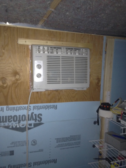

photo 2-2.JPG (109.79 KiB) Viewed 2340 times
Here is my Temp ac install & test method, I have an idea for a new system install method
:twisted: :twisted: :twisted: :twisted:

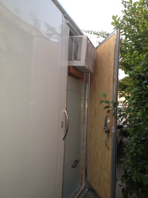

photo 3-1.JPG (110.08 KiB) Viewed 2340 times
http://overthetopcargotrailer.blogspot.com/
View from the inside, see if you have wood studs ANOTHER ADVANTAGE !!!

Postby OverTheTopCargoTrailer » Mon Jul 01, 2013 7:59 pm
Today my first AC test was a grand slam, it was 101 outside & inside never over 81 deg :D :D :D :D , my cargo door is still uninsulated as are all the wall studs and 20% of the ceiling. The inside is mostly empty & I had myself, a big fan , tv and DVR running - that's about 150 watts worth of heat load all being cooled by 500 watt ac unit. With the trailer loaded & the other 50% insulation installed I should be able to keep interior at hopefully 70 deg.
:beer: :beer: :beer: :beer: :beer:
Posts: 1628
Re: OverTheTopCargoTrailer 7 x 16
Postby OverTheTopCargoTrailer » Tue Jul 02, 2013 10:47 pm
Today my 2nd AC test was a grand slam also, it was 96 outside & inside never over 78 deg :D :D :D :D , my cargo door is now insulated as are all the wall studs but not the last 20% of the ceiling.
Without me in the trailer & only the fan running temp was around 70 deg !!
So you can see that warm body & a few appliances can quickly kill the AC by 8 degrees.
