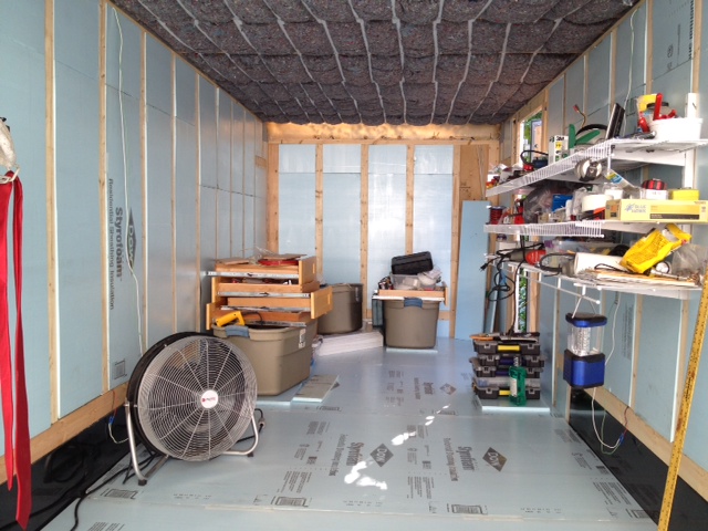

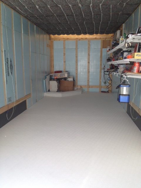

World record, most insulated trailer floor, no thermal breaks :D :D :D
Here is the finished floor , 3 layers of 3/4" Dow foam board & 1 layer of white plastic something ?? for $28 a panel from lowes
CLICK - to enlarge picture
there is still another 1.5" layer of Blue Dow foam board coming for the walls,
OTTCT is ready for global warming :beer: :beer:

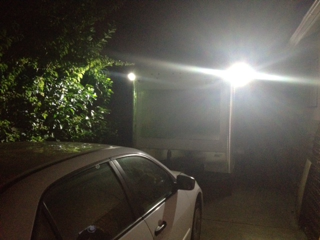

Here is the new front flood light, don't sneak up on OTTCT 2.0

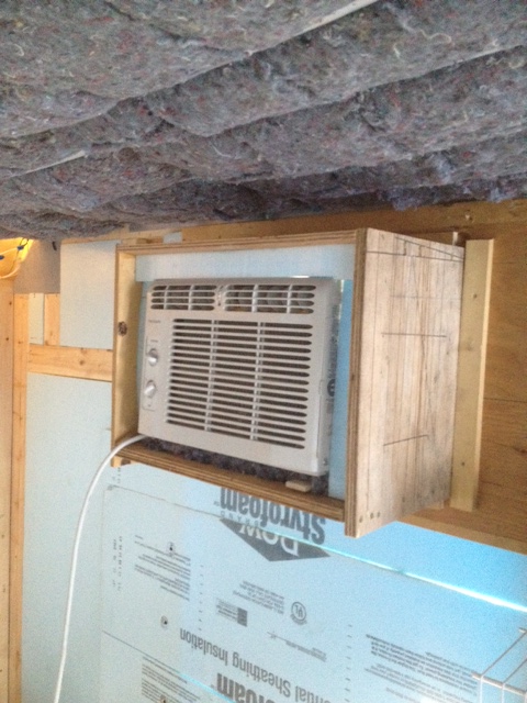

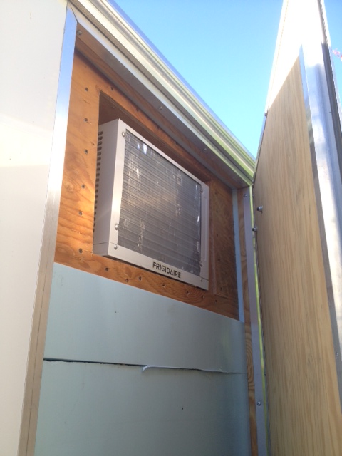

I moved the AC around again and built a new box installed across the top of my 32" door
NO HOLES IN THE EXTERIOR !!
Sorry I only posted pics to my blog with iphone, it's easier if your listening mike :D

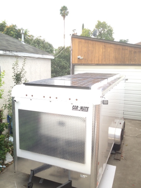

I finally got around to putting the 5 panels on the roof, raised about 1" high , covering 85% of my roof surface,
Before the panels were up the interior roof temp was around 104 deg - when it was 78-80 outside full sun.
Any bets if that roof temp will go up or down ? Remember the panels are now shading 85% of my CT roof,
But those little suckers get pretty hot also, I bet they will hit maybe 120 deg in the sun at 80 exterior
So place your bets HIGHER OR. LOWER ??

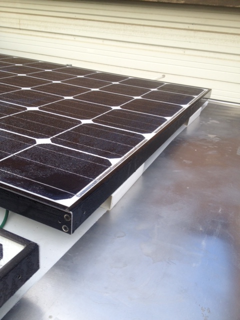

some shims to support the solar panels
p 2-4.JPG (122.05 KiB) Viewed 3198 times

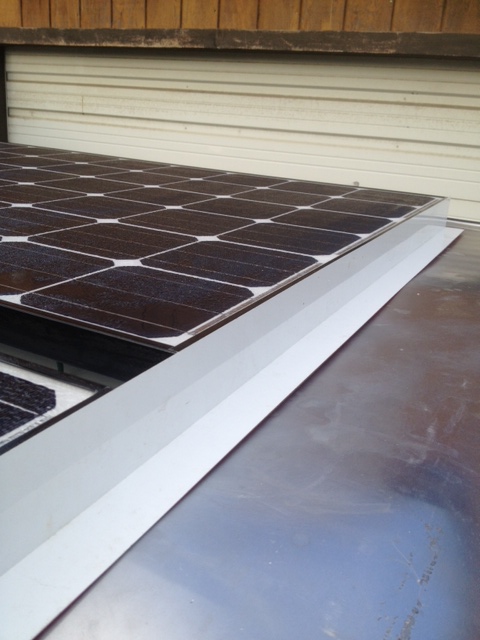

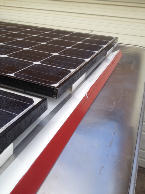

The VHB tape on the metal strip
p 3-2.JPG (111.37 KiB) Viewed 3198 times
The attached metal strip

Here is the final look :D :D :D
I now have 1530 solar watts installed
