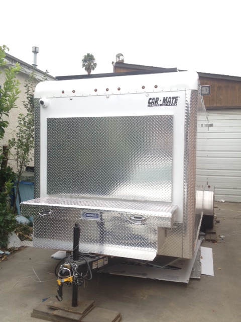

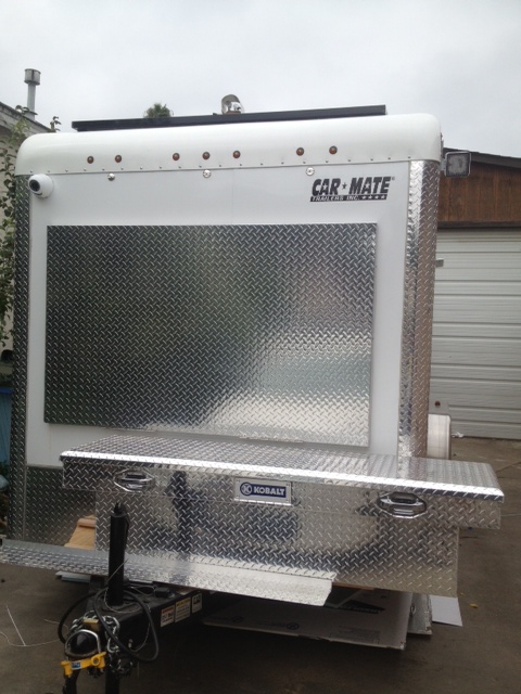

Postby OverTheTopCargoTrailer » Thu Aug 22, 2013 4:22 pm
Do you guys remember the JUMBO truck tool box....
well its back and now it slides back & forth 8) 8)
NOTHING is IMPOSSIBLE @ OverTheTop
p 4-1.JPG (129.33 KiB) Viewed 1848 times
photo 1-5.JPG (131.57 KiB) Viewed 1848 times
photo 2-5.JPG (144.28 KiB) Viewed 1848 times
It slides right & left
the project still needs a little TLC, but you guys get the drift, this should be good until my
Alzheimers kicks in and i forget to slide the box while turning,
on OTTCT 3.0 I'll be sure to get the longer tongue and or auto slide motor.
If you boys and girls are extra good , I may throw in a picture with my Solar Panel Down
Its not as nice as Mark519 box - but he would not make one for me, I begged him to no avail :cry: :cry: :cry:
