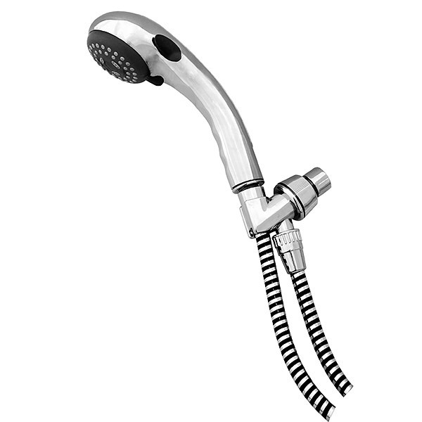

I may try this If I cant get it right.
American Valve HSHH HotStop Anti-Scald Handheld Showerhead
SHOWER HEAD.jpg (30.75 KiB) Viewed 2723 times
