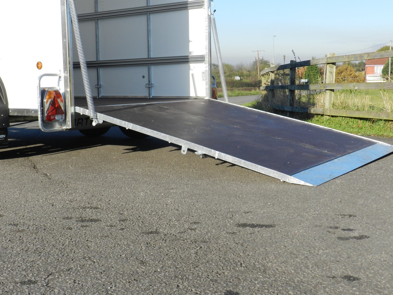

Tommy B wrote:horse trailer ramp hinges. Makes sense. Live stock up the ramp, no cable to mess them up. Same deal, different application. Common set up.
I got this one way or another Hate them cables
Picture in a minute.
Tommy,
The pic I posted earlier was from a horse trailer. That type of torsion spring system is common. If you have a trailer place in near they probably have some trailers for landscaping that use them on the rear or side gate. They are simple a they and don't have to be done as elaborately as it was on the trailer in the pic. I'm sure they used used all of those tubes because it is aluminum and they were worried about wear. The system can be made with normal butt hinges using a grade 8 bolts as the pin. A single stainless pin that went though all of the hinges would probably work better. The springs are cheap but I have no idea how to calculate the tension or number needed. I am sure the spring company could help with that though.
Lippert makes all of the components https://www.lci1.com/support-ramp-doors
Lippert also makes a complete hinge called the infinite hinge that used torsion rods that is supposed to be customer friendly in setting the tension.
If you don't mind having garage door type springs this is another option http://www.batesontrailers.com/product/optiopns-for-van-trailers/spring-assisted-loading-ramp-replacing-roller-shutter-doors/

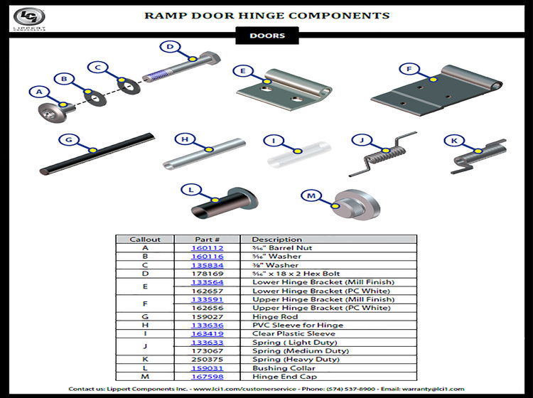

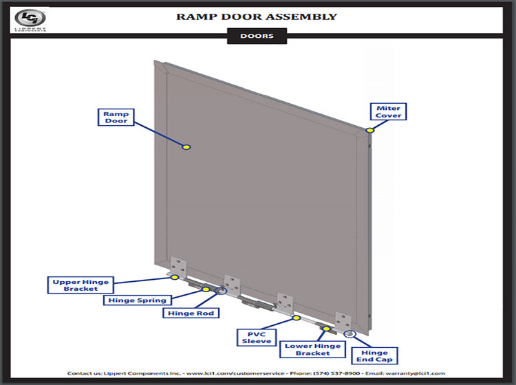

Postby Tommy B » Thu Sep 15, 2016 12:45 pm
Lippert parts. will total price if available.
Maybe this will help some else!
Will get pricing.

Re: HALLMARK 6X12 CONVERSION
Postby Tommy B » Thu Sep 15, 2016 1:01 pm
The individual components. Again maybe this will help some one else or give food for thought. :thinking:

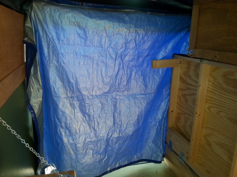

Postby Tommy B » Thu Sep 15, 2016 5:16 pm
OK I GOT IT!
Jeeze, any material you want to use. Mesh. Clear plastic., or combo. It simply fits. Should have tested this prior.
Velcro sides, what ever. I will live with sloped ramp, and cables. level ramp fall/knee hazard.
This was quick, so again imagine nice green mesh per previous picture, $23.00. Some Velcro. Stretched taught. I will post pics when done.
Tommy Out.

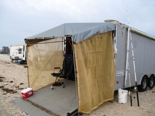

Postby flboy » Thu Sep 15, 2016 7:08 pm
Tommy B wrote:OK I GOT IT!
Tommy Out.
Tommy, no need to Velcro the sides (although that will work fine t0o... just more work to do the screen and the trailer). It is a steel frame around that door. Just sew in magnets and that will hold it very well... then you put in a slit for the opening and then sew in light magnets either side (opposing polarity) slightly overlapped. It really is that simple. I plan on buying the screen at Home Depot and then cutting it myself. You can buy magnets to sew in on E-bay or Amazon...
Also, you should be able to get in front of the pulleys and springs so the screen is flush to the frame. Put small slit on either side (magnet or Velcro to attach) to allow the cable to pass through. I believe they sell these already made for various size Toy Haulers... but they cost about $150.00 and up. You should be able to make one for <$25.00
Lastly, make sure you seal the wood on your ramp well if is going to be open to weather. It will ruin that plywood real quick. If a level ramp is important to you.... just get some chains (attach with a carabiner) like shown in other places to keep the door level and take them off when you want a ramp.

Postby Tommy B » Fri Sep 16, 2016 7:11 am
Absolutely!
Just like that. I will try this mesh though. I think I can avoid slits all together and use like shower curtain. I have something in mind. That green mesh will look awesome. ordering it today. That picture shows tan but I will get green. Tough stuff according to the info.
