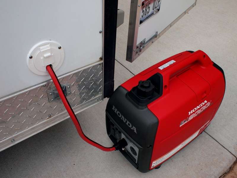

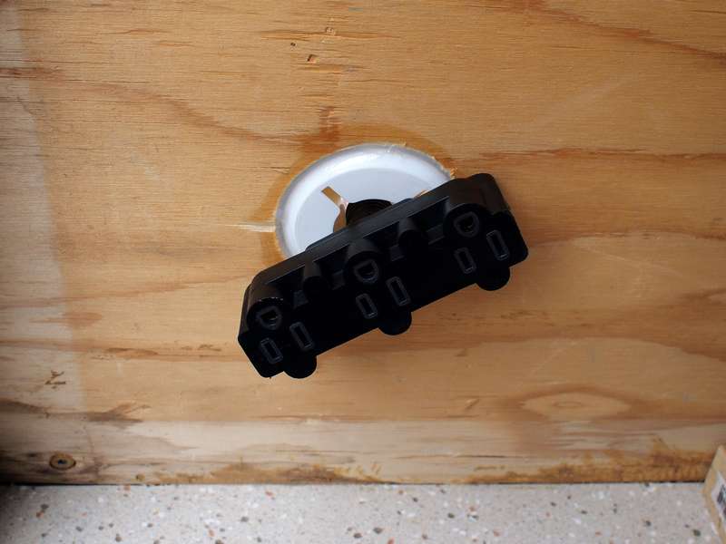

Postby d30gaijin » Sat Nov 12, 2011 12:57 am
digitek718 wrote:Glad the marinco inlet worked out for you..im still on the fence about the inlet..im leaning towards getting a basic 5 dollar cable hatch and and just running the shore power chord through..i know its not as streamlined, but it would also give me the option of running a standard 15 amp extension chord through it,hooked up to a battery tender for long term storage instead of powering the whole trailer and putting more miles on the converter. Decisions decisions
Digitek,
That sounds like the setup I went with at the rear of our CT to give us another option for getting power inside (see photos below). Very simple and very effective. I picked the cable port up at the local Camping World store for about $6, as I recall. The photo shows a short three outlet cord going to my generator. It's simple to remove the short cord and replace with a longer single outlet extension cord.
As GPW so often says here, "Keep it simple." If the cable outlet/penetration is all you need, and it works for you, then that is the way to go.
