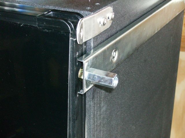

Postby Jeffmo63 » Sun Jul 18, 2010 12:02 pm
Today I am mounting the refer/freezer in the trailer. I am using a 7/16 bolt and a coupling nut and another 7/16 bolt through (from the bottom) the floor. This should be more than adequate and will let a little more cooling air flow under the bottom of the refer.

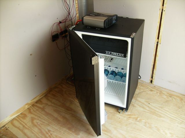

Postby Jeffmo63 » Mon Jul 19, 2010 12:58 pm
Here is my refer/freezer installed and operating on 12 vdc. Wiring to be neatly bundled when lighting checks out. Overall, very pleased so far.

Postby Jeffmo63 » Tue Jul 20, 2010 1:00 pm
Well, it has been 24 hours off grid with the refer/freezer. I am very pleased with this product. It holds temperature within a degree of 36 with the thermostat set at 3 1/4 and partially filled. This is about what the instructions recommend (3) and I could probably back off a bit. Battery is 80% and that is with the Fan-tastic vent operating intermittently. As previously stated I want to get an 80w solar panel and that may allow me to operate nearly a week under optimum conditions and careful use of lighting. 3-4 days is probably a consevative estimate. Leaving for the Oshkosh Airshow for 10 days. Will keep updating.
