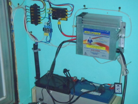

Postby pmspirito » Mon Oct 03, 2011 10:09 pm
Here is the 12 volt power center. The fuse block on the left is the incoming from the tow vehicle, thru the fuse, and out to the trailer lights, brakes etc. If something shorts out on the trailer running lights i will not lose the tow vehicle lights.
the small center terminal strip is for the brakes. I ran a separate cord to each wheel brake. The next fuse block is for the 12volt lighting inside of the trailer. then the Precision Dynamics 60 amp converter/charger. The two batteries are 35 amp hour deep cycle wheel chair batteries. they each plug in via a polarized two-wire connector. I can unplug a battery and use it for my trolling motor, then plug it back in for a recharge.
Every 12volt circuit has a 30 amp fuse. I am not concerned about over current protection. I only care about short circuit protection.
