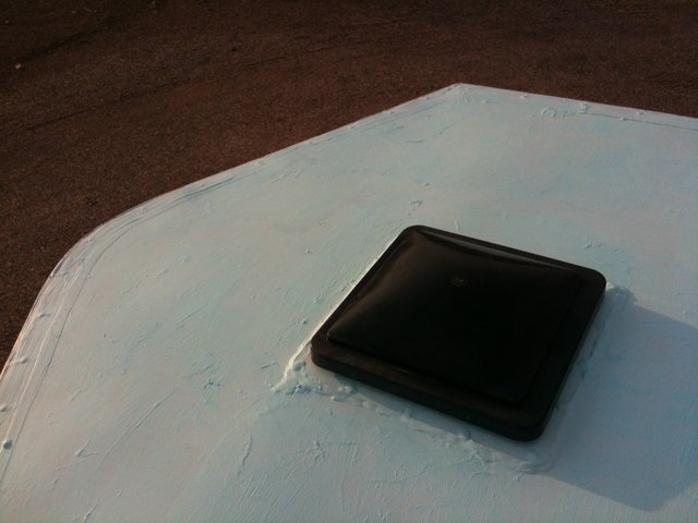

When I converted the trailer, I added 1 inch insulation and a layer of reflectix to the walls and roof. This combo has held up well so far. The Cargo Trailer Conversion forum, had a few members who painted their roofs with Elastomeric White roof paint to reflect the sun and heat. Well I did not do this step when I converted my trailer. I am not much for doing this type of work, and after all.... I am retired.... hahaha.!!

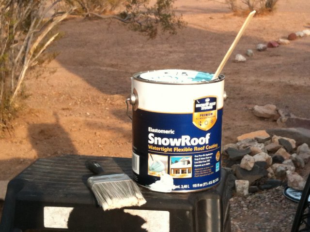

The trailer was begging for some relief from the heat or it was not going to let me inside anymore. So I broke down, went to a town, and picked up some paint at Ace hardware.
I dug out the ladder and set it up, then I tilted the solar panels so I could paint under and around them without taking them off the roof.
Image ..... Image
Over a 2 day period I painted 3 coats on the roof, allowing each coat to dry before adding the next one.
Holy Buckets !! What a difference this upgrade has made. I highly recommend adding Elastomeric Paint to your roof. The trailer has even allowed me back inside and is very happy with the cooler temp..... lol.

How much paint did you use for your 3 coats? I may do the same to mine...
norcal2
Posts: 59
Joined: Fri May 18, 2012 12:33 pm
Re: Colorado 6X12 Haulmark Cargo Trailer
Postby Trainman45 » Wed Jul 17, 2013 10:51 pm
Hi NorCal2,
A one gallon can will be close and should do it. But ..... I used 1 and half of another can for my 3 coat application.
Hope that helps you out.

I used elastomeric white RV roof coat on my bus conversion years ago. I put it on thick with a stiff-bristle push broom. Two coats (wet on top of sticky for bonding). It really worked well, especially in Arizona and Baja. It took many years to really start deteriorating (bubbling/breaking/flaking). Only downside was that it held dirt and was hard to wash clean as it aged and got chalky.
I made the mistake of putting on just one not-so-thick coat of elastomeric on my bare aluminum CT roof. It peeled in just under three years. I used high-pressure hot water to remove the rest of it at an RV DIY carwash with a gantry for getting on the roof.
This time I bought epoxy marine paint (glossy white). Two heavy brushed coats for maximum opacity.
My 2 cents,

@ BC Toys, This is my first and only cargo trailer, so the flat roof is all I know. It has worked well for me with the solar panels and fantastic fan up top. I have gone up to wipe off the panels once in a while and the roof does not hold water. There is a slight slope to both sides. I have lived in it fulltime now for 1 and a half years and would not have it any other way. It works great for me.
I used three coats to get a good solid coating on up there. I used a paint brush so I could get around the solar panels without taking them off and around the fan. There wasn't much left to paint after that, so finished with the brush. The first coat, like Prem said, was real thin, more like a base coat. The next 2 coats looked real solid and should last many years. Very happy on how it turned out. I live mostly in the southwestern deserts and has helped with the heat. In fact, I am headed your way to Vegas from southern Arizona right now to house sit.
