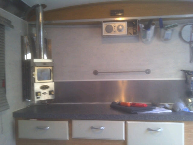

Postby 41willys » Mon Jan 23, 2012 5:13 am
Here is the dickinson heater I installed in our 6x10 trailer, it is a propane heater that produces 8,000btu and is a sealed unit that extracts the air for combustion from outside and exhausts through the same roof vent. I have used this on numerous hunting trips where the temp is minus 12 C (Canadian temp). and it had no problem keeping the temp at 75 deg f inside. I had considered the wood burning unit but the chance of low oxygen/ co2 was too high a risk. The only draw back I have from this unit is there is only 3 settings; off/ 4000btu / 8000 btu. so sometimes the temperature control is the window opening.
I came accross a guy from northen canada who had a wood stove in his trailer. Itwas a wood stove used in a ice fishing cabins it was around 10" round and 25' high vented through the roof and produced enough heat to forge steel! was sleeping with his door open at night. :lol:

Postby 41willys » Thu Jan 26, 2012 12:08 am
They do not manufacture anything, but we all know that means nothing. I did think of wraping copper tube around the exhaust/intake pipe but because my trailer is a 6x10 by the time the water is hot enough to use the trailer will be 100 deg inside ha ha. I may still do this to use in the fall/winter but right now im acctually working on a small portable propane shower that i can carry down to a creek to use. this stove is mainly for heat no cooktop or easy heat exchanger for water.

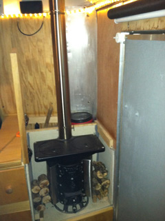

Postby subterran » Tue Jan 08, 2013 6:18 pm
I have done what you want to do. Check it out:
http://www.youtube.com/watch?v=jpU450o6Zuo
and
http://www.youtube.com/watch?v=C5KPRGK_xqo
If you would like any more information, I will PM you contact information.
