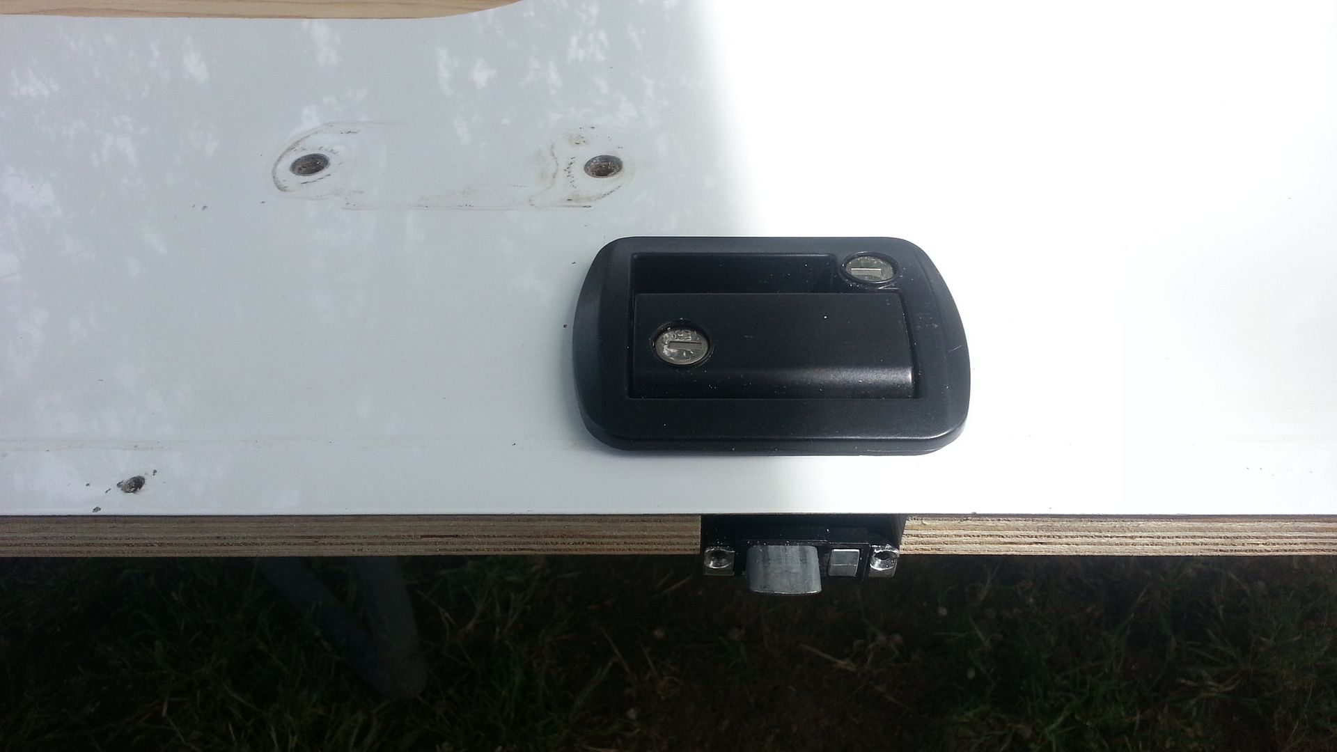

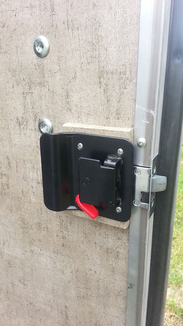

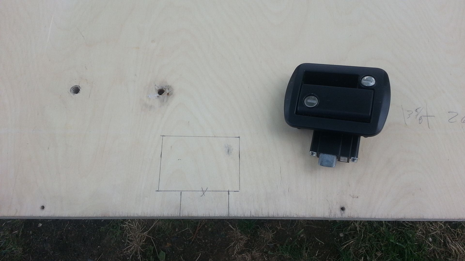

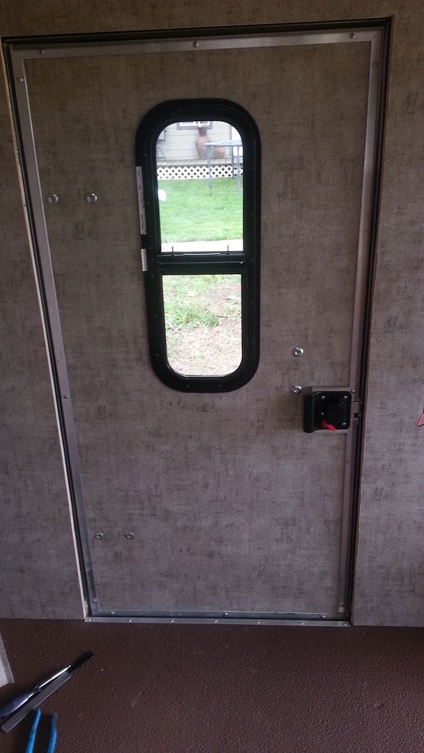

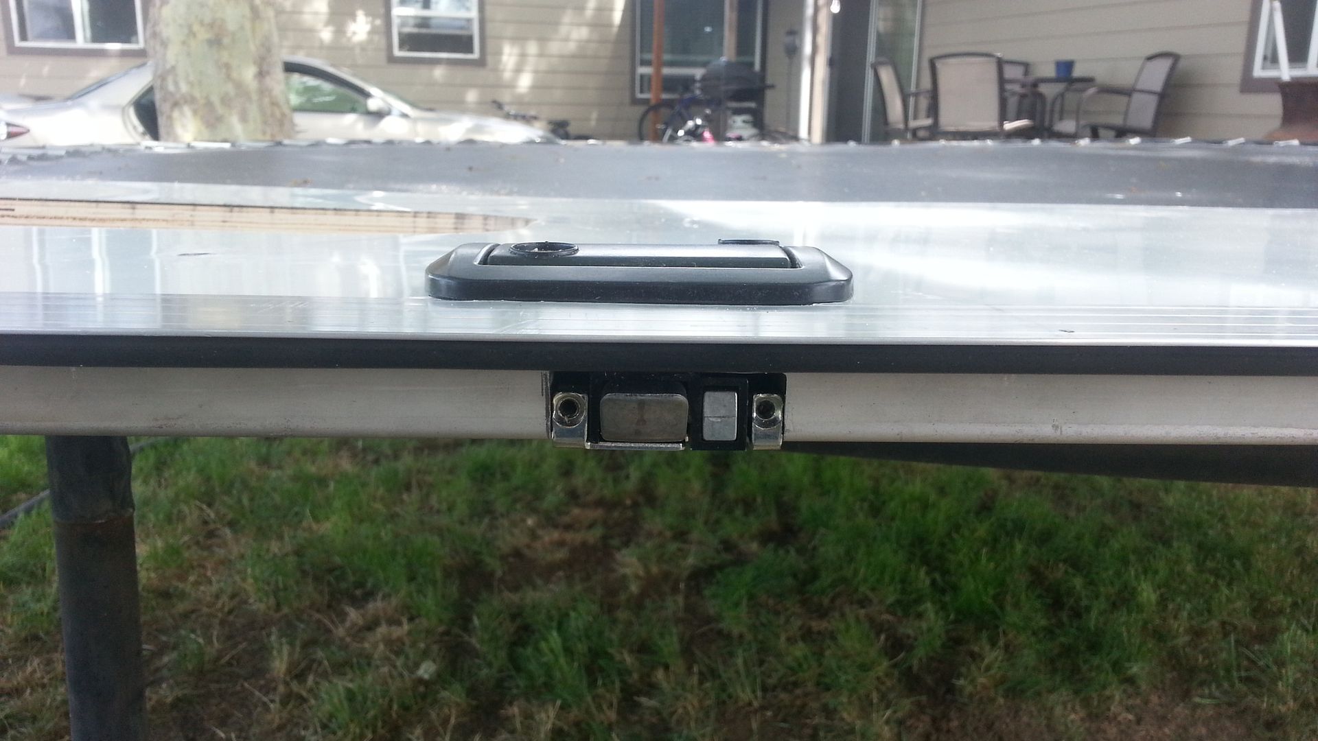

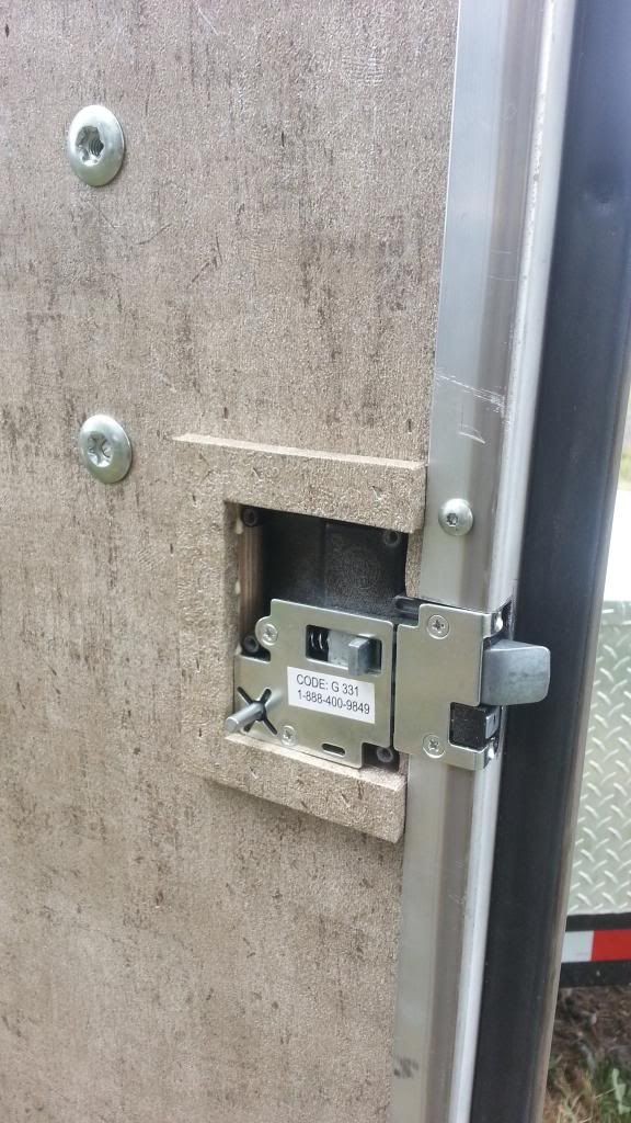

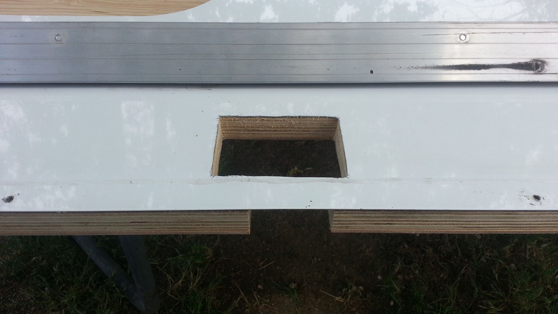

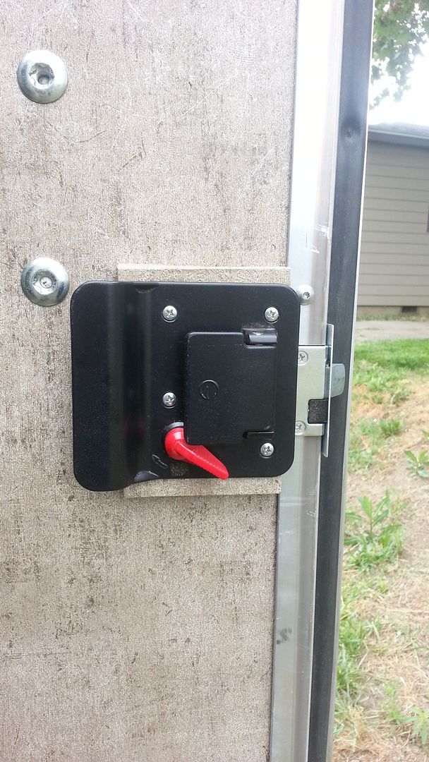

Here is my side door rebuild. Added the RV latch and window...
Had to make a spacer shim to get the door to the correct thickness as the latch I have is designed for a 1-1/2" door...

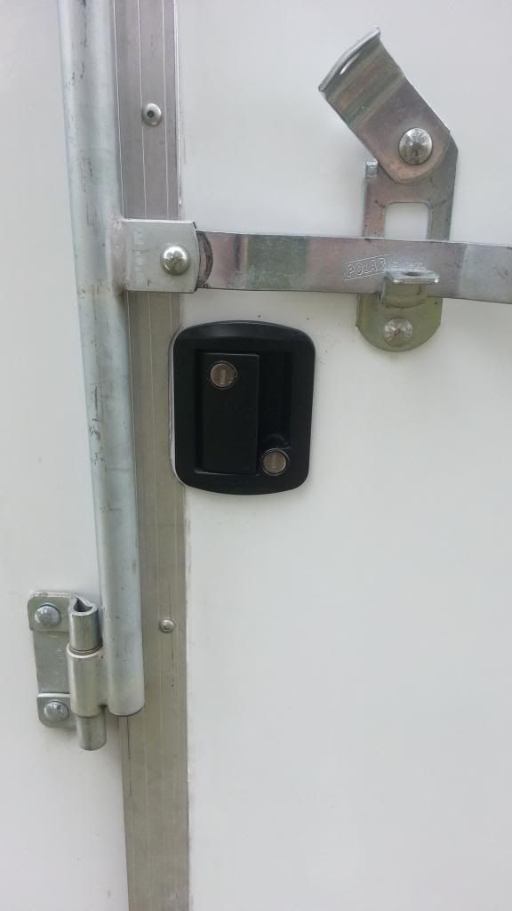

Well done RV latch! Now if it were me I'd get a long shackle padlock and when the cam lock is open and the lever is hanging down and there's more room behind the vertical tube, lock the lever against that tube at night. That way no 'prankster' can close the latch and lock me in. You could just lock the clasp closed with the lever left out too, but the lever is then still available to bungee on or something like that.
Maybe I'm just paranoid, but never give 'em a chance to get ideas. Lock the lever to the tube and it's totally disabled.

Glenlivet wrote:Well done RV latch! Now if it were me I'd get a long shackle padlock and when the cam lock is open and the lever is hanging down and there's more room behind the vertical tube, lock the lever against that tube at night. That way no 'prankster' can close the latch and lock me in. You could just lock the clasp closed with the lever left out too, but the lever is then still available to bungee on or something like that.
:D
Ha..no not to paranoid. I think about that also. But for now until I have an egress window on roadside just in case :) Been thinking about doing something different but not sure what yet...the padlocks get kind of annoying rattling in the hasps when you walk thru the trailer.
