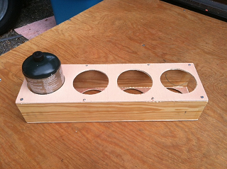

have had this propane bottle rack on my mind for a while but hole saw prices are crazy so been blowing it off. picked up a large hole saw set from 3/4' to 6" at harbor freight on sale for $13.99

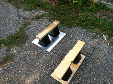

was going to thru bolt but had stabilizers welded instead

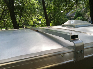

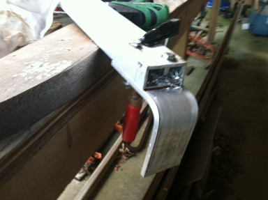

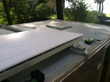

Building racks for solar panel mounts. Heated n bent 1/4" x 2" aluminum into brackets. thru bolted to 1"x2" aluminum tube

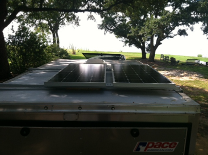

Finished fabricating and installing mounts for solar panels

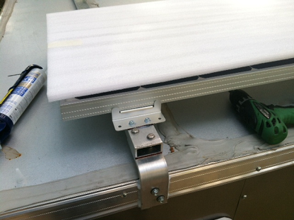

Solar mounts install continued

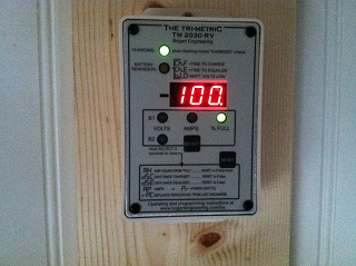

Postby willfish4fud » Wed Aug 20, 2014 8:37 am
Solar install is complete and functioning properly. I have no experience with electrical except for past minor wiring on some boats. The instructions that come with solar equipment are very thorough and, to me, very wordy. This intimidated me for a while. I dealt with Handy Bob and referred to his blog photos a lot. He was great and had answers to several key questions that I couldn't find elsewhere. Now that its finished, it was fairly simple and straight forward. I did many trips to the store for connectors, screws, etc and spent a lot in small purchases. My next install will no doubt go much faster and somewhat cheaper. I plan to have an off grid cabin soon and feel confident I can do that system too.

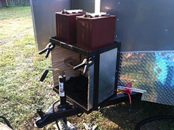

Enclosed the rack that holds batteries on trailer tongue. Laminated thin sheet metal (galvanized flashing) to 1/4" ply to help reflect some heat from new Trojan 105's
