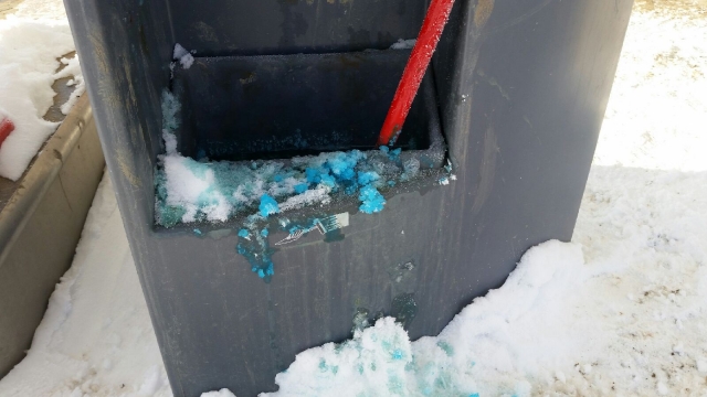

Actually it worked out real well... discovered last ight that my generator isnt designed for below minus 15.... conked out when we hit minus 22 around 8pm.... sure enough the -15 threshold is in the manual. Not on the box though. Why they put crap like that up for sale in alberta is beyond me.

Even the antifreeze in the gas station windshield wash containers froze.

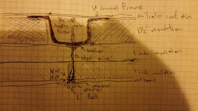

The hanger wires were wrapped around a self tapping metal screw, then lightenned between that screw and a washer when the screw was tightenned to the U-channel frame. Two wire ends then hung down, almost 2 feet per end.
Slid two insulation boards and the wallboard onto the wires using clamps to hold it all up.
Attatchment device was a 1 inch bolt, with a washer and a nut pre tightenned. Also another larger washer big enough to pass over the nut, plus a second nut sitting loose.
Held the bolt sideways against the roof and wrapped the wires between tbe nuts, and hand tightenned the loose nut as hard as possible to bind the wires. Then clipped off the excess wire.
Stood on my toes to push the ceiling insulation and wallboard up tight, giving me a bit of slack in the wire. Turned the bolt so the threaded end passed up into the wallboard hole.
Again stood on my toes to press the roof material up tight, and turned the bolt which in turn twisted the wires... untill enough resistance such that all the slack had been taken out.

Postby OverTheTopCargoTrailer » Thu Nov 13, 2014 9:08 pm
Chilly willy
EXCELENT IDEA .... With the ceiling bolts, let me think & I think I can have some improvements.
