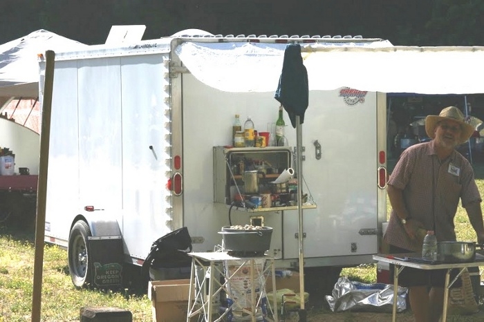

I've done some limited inside cooking with my two-burner Coleman propane stove that dates back a couple decades. I open windows, a roof vent or two, and haven't had the CO alarm go off yet. Just use more than enough ventilation. I try not to cook things that spatter a lot of grease. Its nice to just wipe off the stove and put it back on its shelf in the chuck box when I'm done. No counter space lost, yet still sets up in just a minute or two whenever I need it. When the weather is nice or I just want or need to cook outside, it still sets up anywhere I want it, quick and easy.

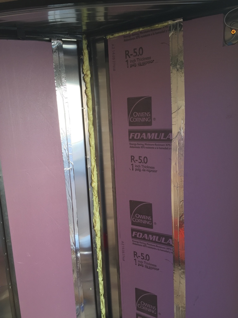

Insulation: Round 2
The label for 1" EPS states that about half of the R-value comes from the air space. It's the same for XPS depending on which source I read. Stuffing 1" of XPS between the metal studs with no airspace on the outside is less efficient than 1/2" XPS spaced out from the siding.
What am I missing?

I guess I'm not sure why we all stuff the walls full of foam when it would be cheaper and more efficient to stuff them half full.
I did find another piece of product info which states XPS does not need the air space like EPS to get full R value.
I have 1" XPS for the walls. I'm using composite furring strips 1/8" thick against the siding. Over the metal studs I'm installing two pieces of rolled foam used for sill foundation sealing which works about to about 1/8". A tiny bit of thermal break and it keeps the spacing correct.

I went with XPS and Great Stuff.
Foil tape over the seams.
