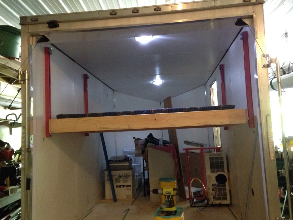

Postby Padilen » Sun May 31, 2015 3:37 pm
Kinks in bed plan. I used a different build than originally planned-plan A. I have mounted "slides" to CT. I built a bed frame and its mounted to "slides". I'm not finished with the lift idea and I'm not sure plan B will be the final plan.

Postby McDave » Mon Jun 01, 2015 7:14 pm
I'm liking that idea. :thumbsup:

Postby Padilen » Mon Jun 01, 2015 7:22 pm
Thanks,
Hope to get the springs mounted and try it out.

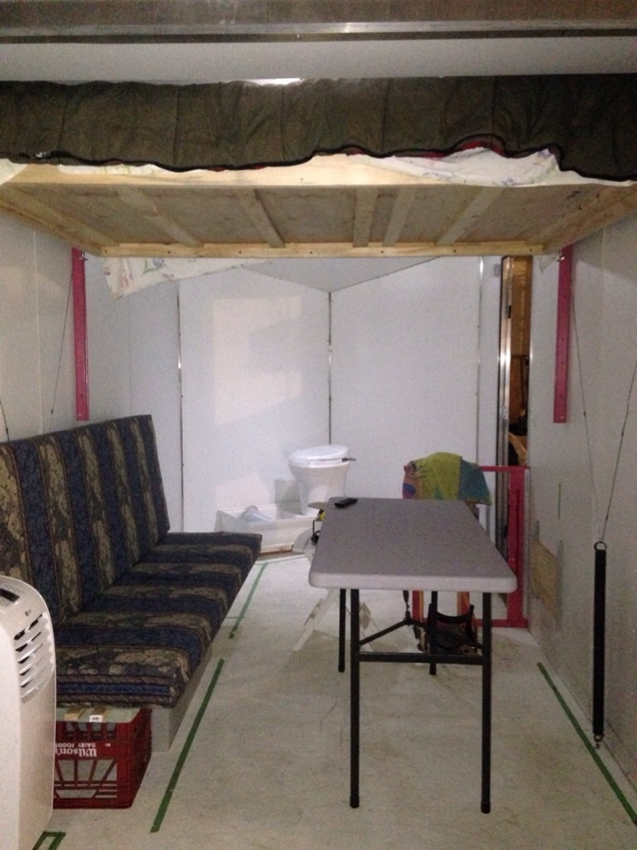

Postby Padilen » Tue Jun 02, 2015 10:25 pm
I'm still learning. Got springs and cable on. But either cable isn't tight enough or springs and strong enough. I had pre drilled holes for stops. Found that I need top stops as well as the bottom stops. I missed drilled a "top stop" and had to file it oval. I did to much. I have carpal tunnel and nerve damage in my arms and hands. So I'll have to try shortening cables another day.
It seems to work- not perfect but I'll keep at it.

Postby Padilen » Sat Jun 06, 2015 9:41 pm
Springs didn't seem heavy enough. So I got some heavier ones. That was a mistake. They prevented me from be able to lower the bed. Although they did hold it up all the way. In my attempt to lower the bed a pulley moved and the other pulley blew out. Spring slammed it to floor and bent parts flew all over. I survived. So I'm trying another idea before I scrap the idea.

Postby Padilen » Mon Jun 08, 2015 10:56 pm
Plan C failed. I went back ( plan B) to the garage door install company. He said I thought those were the wrong springs after you left. Did you cuss me out? So he gave me 2 other springs (shorter) with pulleys.
It works. Not smoothly but it does work. I think 2 people could do it smoothly. I got mattress in it a tried it out for about 2 hours. But had to get something in house so I stayed.
Need to get AC working next. I need the bed and fresh air and a place for my dog if I go to my family reunion, in 11 days.

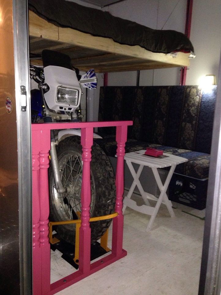

Postby Padilen » Wed Jun 10, 2015 11:01 pm
I see pic didn't post
I also see a problem with my Hi toilet and my raised stool mount! Yep to high!
I talked to a retired RV dealer. He said he'd help me with my wiring plumbing and modifying my awning !

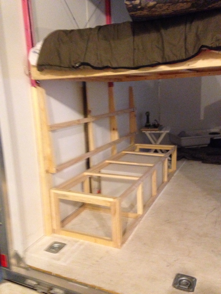

Postby Padilen » Mon Jun 15, 2015 10:41 pm
Load cycle to "see" how it's looking

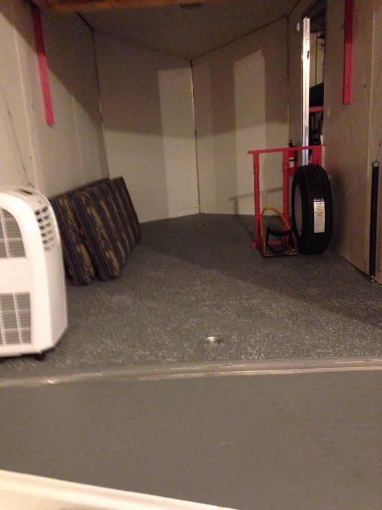

Postby Padilen » Sat Jun 20, 2015 9:44 pm
No more milk crates to hold up cushions.
Ordered spare tire, and I'm getting guard company's AC/DC panel. Also bought a gallon of paint- but undecided if I'll paint floor.

Postby Padilen » Mon Jun 22, 2015 3:03 pm
I removed everything from the floor and cleaned floor. Went and got my spare tire. Came home intending to paint floor, but storm came and power went. I also scuffed my pickup front bumper on some concrete. I'm not use to a low bumper! My Jeep had a higher bumper plus I lifted it 2".

Postby Padilen » Mon Jun 22, 2015 8:32 pm
Power came back on and I got it painted.

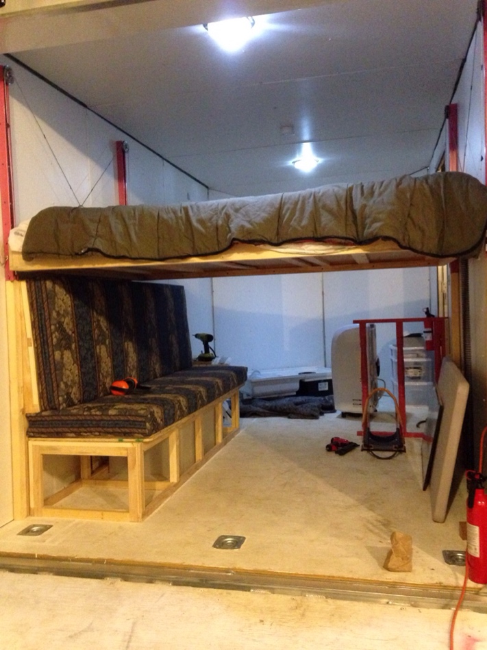

Postby Padilen » Tue Jun 23, 2015 7:58 pm
Started putting stuff back in,
