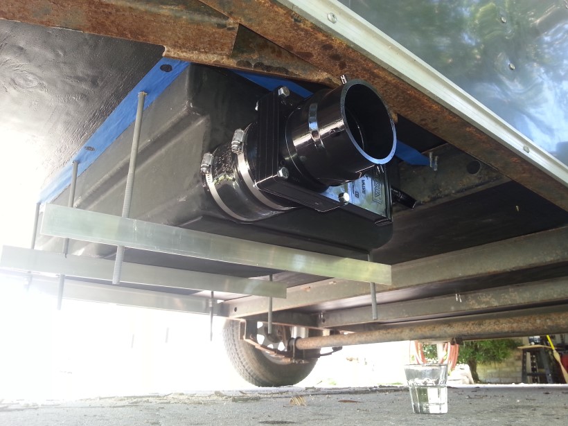

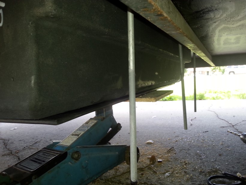

A long weekend. I through bolted it right through the floor with 6 12 inch carriage bolts. galvanized. 3/8. for better or worse that's what I did.
20160528_162416 (Custom).jpg (125.92 KiB) Viewed 5670 times
BLACK TANK INSTALATION
20160528_131123 (Custom).jpg (109.8 KiB) Viewed 5670 times
20160527_174231 (Custom).jpg (128.83 KiB) Viewed 5670 times

That tank came in PDQ. It sure looks like your mock up. So, did you put any sort of rubber or foam between the floor and tank? A little something to prevent chaffing?
I am right behind you on the tank install, with a little luck maybe this week.
Here's my plan for install.
1" x 1" weather stripping around the perimeter of the top of the tank, and around the 3" pipe, and a couple strips down the center.
Ya see those flanges on the side of the tank? Those are where you want to try to hang the tank from. it's the strong point on the tank. In a perfect world the tank would sit on those supported by the frame of the trailer. Weather stripping there as well. Then you want to block both ends to stop it from moving to and fro. Im thinkin I will attach 2 x 4 right along the sides to the floor, then some angle iron with the weather strip to catch those flanges. that gives you support all the way down both sides to spread out the load. Now it cant move side to side, a couple blocks at each end and it cant move that way either. You also wont have all that stuff hanging down to get hung up.

Hello Mcdave and anybody else who may be lurking about. Yes those rails on the tank would be great for alignment and support but I did not want to bring in a welder and also wanted to be able to service this fairly easily. Very unfortunate that I could not use those rails on the tank or those trailer cross beams for support. I just could make it work that way. As it is now you grab one of the angled pieces of aluminum holding the tank up and shake the trailer with it and the tank will not budge. I will shorten up those 12 inch carriage bolts and trim up the angled aluminum for sure. The 3 inch and 1.5 inch fitting that goes through the floor also help prevent movement but of course I don't want to stress those fittings at ALL I know but its really in place solid right now. I may add a right side and front 2x4 along the tank to further prevent movement well see. any further advice or criticism is welcome.

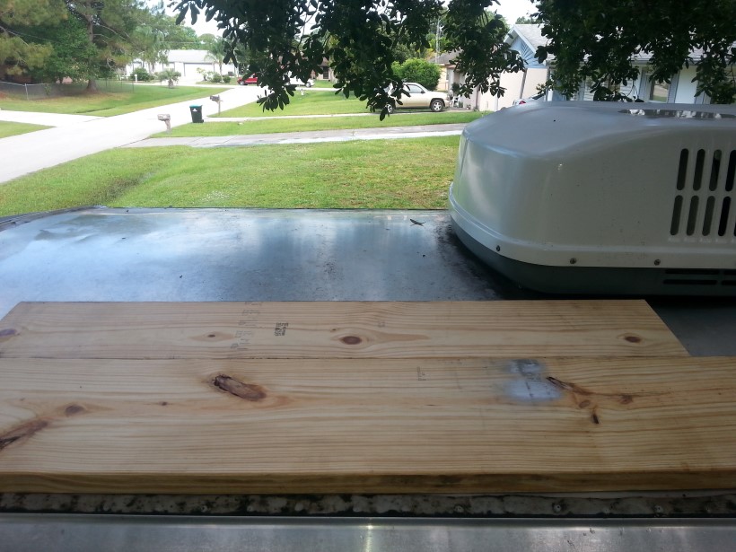

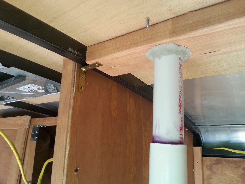

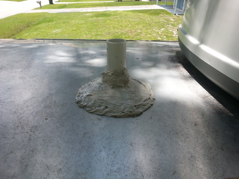

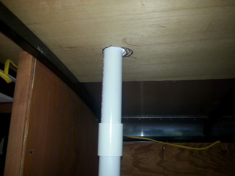

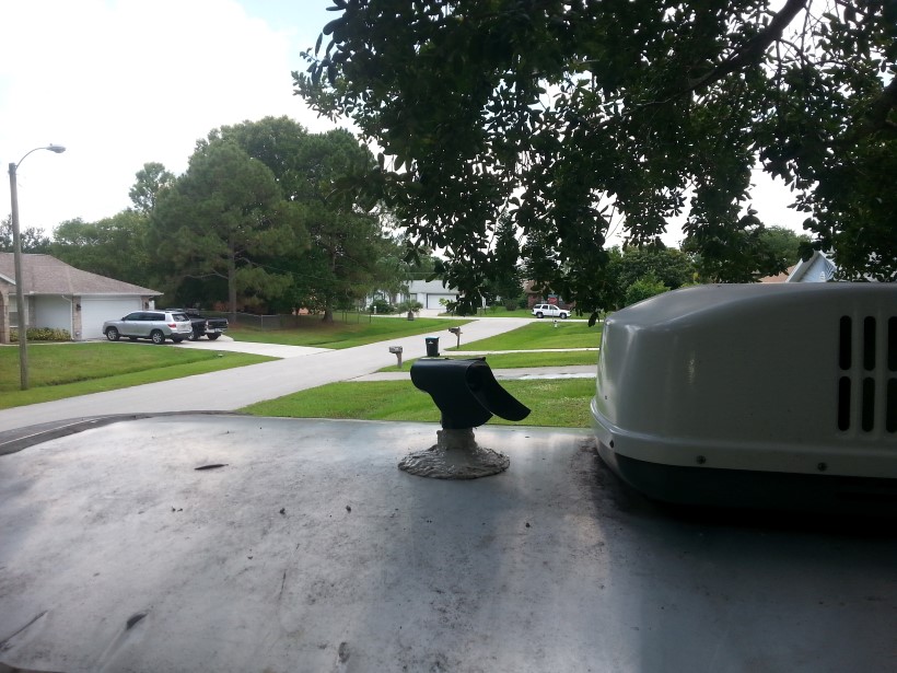

On the vent. Drilled a hole through roof and 2x4 support brace. filled space between pipe and hole with Camco putty stuff. Squeezed out a ton of 100% silicone and then placed camco vent over pipe. Drilled holes, screwed down vent and covered vent and screws totally with silicone. Screwed on that awesome rotating venture affect thing. Rotates in the slightest breeze.
So Again I need advice. Am I ok here or should I improve things. :thinking:

Yes I do believe I will further add those two 2x4 pieces as Mcdave suggested. That way there is no way it can shift. I really don't want to drop the tank to install a mat on top to prevent chaffing but had I thought of that before I would use one.

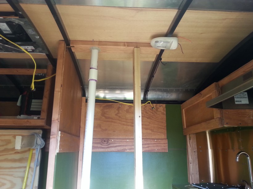

20160531_180625 (Custom).jpg (88.66 KiB) Viewed 5579 times
20160531_180637 (Custom).jpg (95.68 KiB) Viewed 5579 times
20160531_180653 (Custom).jpg (89.91 KiB) Viewed 5579 times

Re: HALLMARK 6X12 CONVERSION
Postby Tommy B » Tue May 31, 2016 5:40 pm
Now look I will beef this up believe me..this was on the fly. Got to keep the momentum. Pick up the pieces later.

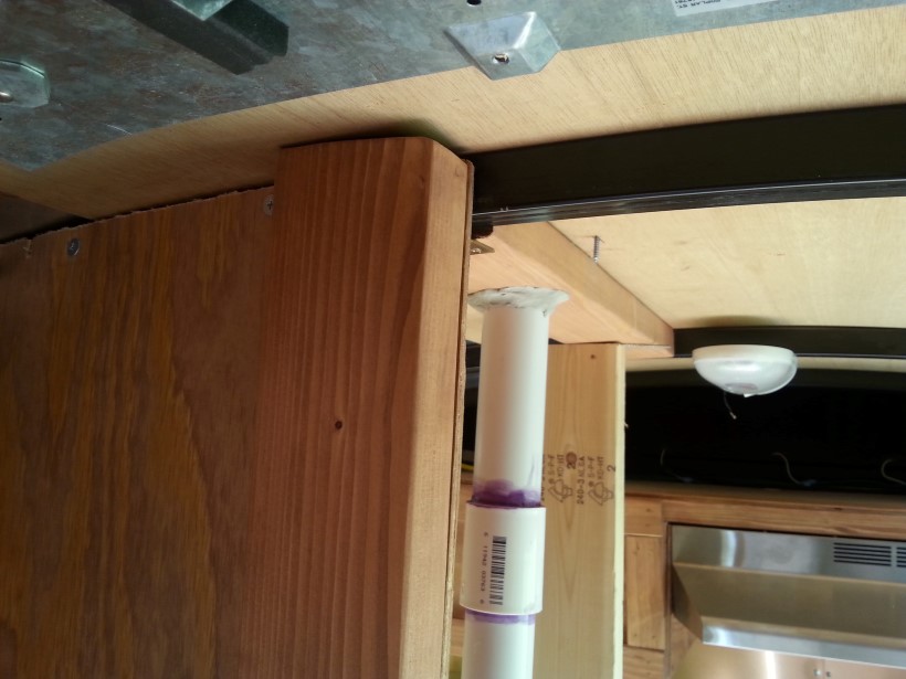

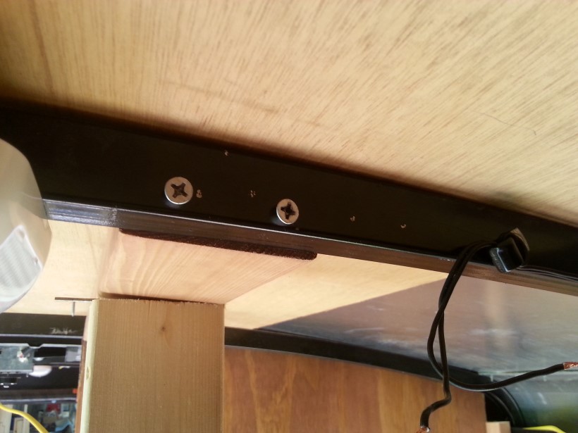

20160531_180606 (Custom).jpg (72.42 KiB) Viewed 5572 times
20160531_180502 (Custom).jpg (80.39 KiB) Viewed 5572 times
20160531_180550 (Custom).jpg (99.6 KiB) Viewed 5572 times
