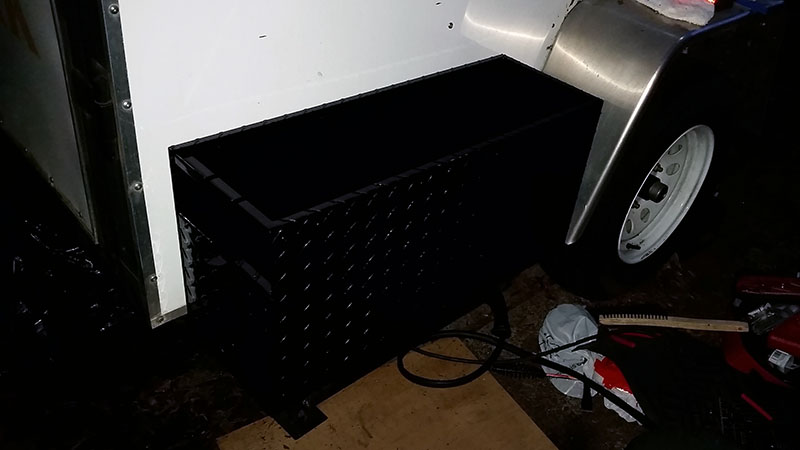

Ordered a battery box. a bit spendier than I wanted to go with it, but it was the perfect size and more reliable than plastic.
I got this guy in black:
http://www.rvlockbox.com/shop/27-alumin ... y-lock-box
Which is similar to and a lot cheaper than this one:
https://www.etrailer.com/Accessories-an ... 7708R.html
I will need to pad the bottom and will probably insulate the sides. I like that servicing the batteries should be easy. Plenty of room for my charge controller, fuse box, maybe the inverter too.

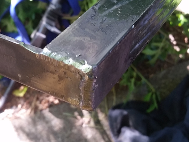

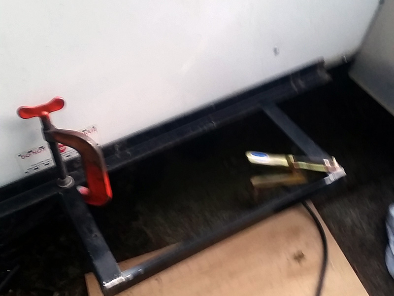

Well I dug out some old 1.5" angle iron scraps, welded up the battery box bracket.
I was able to stand on it while holding weights, put about 350lbs of weight and then jumped up and down on it and it didn't give. Batteries together plus the box are about 140lbs.
Might add another support or two if necessary, originally I wanted to do 3 or 4 but there isn't a whole lot of space.
It started getting dark so the photos got worse. I flipped one angle iron over, ground down the other two that act as the support, so that it would nestle in there, and welded it in three rows making a sort of 3D Z shape. Then I went on the inside and added another bead to each corner. It is very strong, so if one support fails it should give me warning time, I try to plan for the worst, hope for the best.
The two supports I drileld three holes into each of them, spot welded those holes to the main beam right there, and the supports extend another 9 inches from the wall to some C-channel that makes the joists of the floor. I welded beads along both sides of each support to the frame, and then used a piece of 1/2" square steel tube to bridge the gap between the c-channel and angle iron, running beads on them

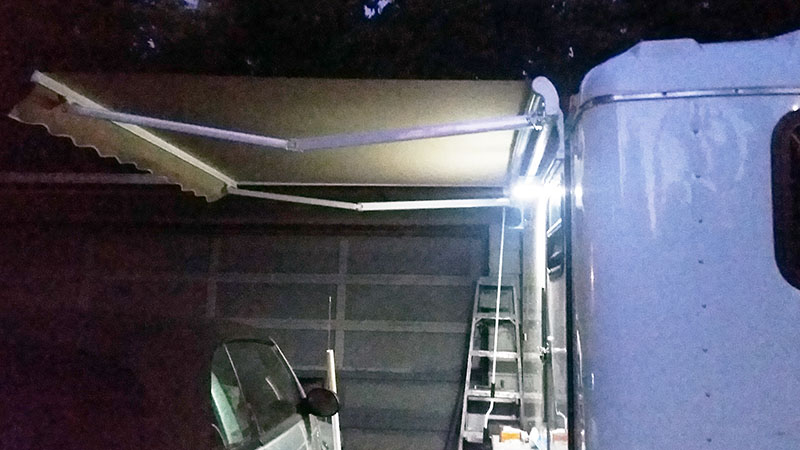

I attached the awning, I got an 8x7 patio awning that doesn't have any support legs. If I need some I can get some that bolt onto it, but I prefer not having tripping hazards. It was under 120$ shipped to my door step, already assembled. I just had to figure out how to attach the two mounts.
The door clears the awning with about an inch and a half to spare, with room to adjust it higher if I wanted.

Postby Mark959 » Thu Jul 20, 2017 1:00 am
I got this puppy for 119 shipped, 8x7:
https://www.amazon.com/gp/product/B00BQ ... UTF8&psc=1
They dont make them in any colors other than beige, green, red, maybe a few other colors... I thought about 10x8, those are cheap too but it would have extended past the flats of the trailer, wouldn't have worked out well... Ebay and amazon, both have awnings cheap. "real" RV awnings cost a LOT more...
I have had it extended now since the day I put it in almost two weeks ago. We have had some good gusts but it hasn't budged. I think the gap helps keep it from being so much of a sail... I might have to do my own gutter or cut a pipe lengthwise to lessen it for when the rain comes back though.
