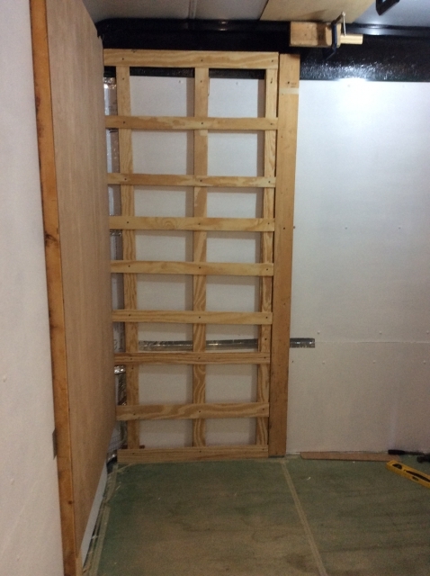

Yesterday got the 2 corner shower walls done. We only lost 1 1/2" on each side to be able to square the 'Squircle'.
We used the 3/8" panel that came with the trailer, but a 2x4 can be notched and used for the corners.
