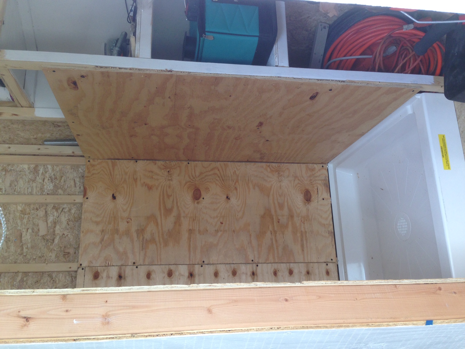

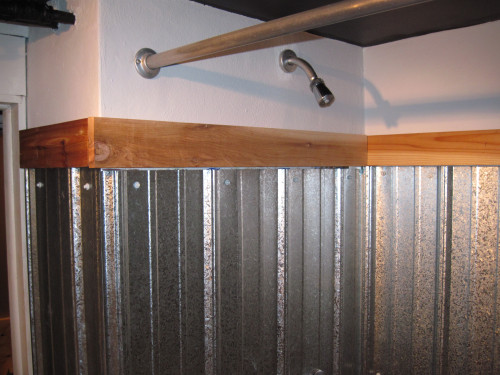

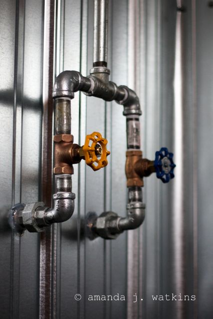

Anyway, my shower pan came in last week. I got it in along with the drain for the most part. I've seen people put the galvanized roof panels up for their shower walls and I really like the idea. FRP would probably be easier but it's stupid expensive here. I started putting up some plywood on the sides without plumbing, I intend to paint the wood with some Kilz or some sort of water barrier. Debating on whether I should coat everything behind it just in case before I get too far.
For those of you with showers have you run into moisture problems after taking a hot shower?
This is pretty much how I intend it to look once finished.

I wanted to do a similar treatment in my trailer and still might, but not in the shower. I have the "wet bath" style, toilet/shower combo. It's pretty tight in there and I'm not a small guy, or a graceful guy either. It just seemed like the was a good chance of getting cut or hurt while naked and wet. Also, it was pricey for the smaller profile metal, used just for décor. I already had a 3 piece enamelled metal enclosure that was all smooth and clean white so I cut that down to size.
I have a vent/ fan/ light combo unit in the shower, so no steam issues. Plus I use a tankless water heater so I have a shower wand with on/ off control. So I get all wet, turn off wand and soap up, turn on wand and rinse off. I only have 25 gal fresh water tank, so I try to conserve. I think I only use about 2.5-3 gal. per shower.
That is a pretty good idea using the galvanized roof panel. I did a quick check on Home Depot to compare FRP to Galvanized roof panel price. FRP is $33 for 4x8 and Galvanized roof Panel is $12 for 4x2. So you would pay around $24 for the same size of galvanized roof panel where I live. A little cheaper.
The edge cutting thing is a concern. But if you were to use this, would you have to coat it with anything to protect it? Or is it fine as is in the shower? I would assume it is fine as is since it's a 'roofing' panel.

You can burnish the edges of the Roofing to eliminate their sharpness.
Easy to do, I'd recommend using gloves and maybe a socket extension.
Just rub the roofing's edge with the extension along it's length and gradually
come over the edge and down the other side. That will round off the edge
and smooth it so the chance of cutting should be eliminated. Should only
take a few minutes.

Some people spray a clear coat over it, I highly doubt this is needed though. This stuff is made to be outside in the weather, yes it will eventually need to be replaced but everything has a life expectancy and it will be MANY years down the road with the right upkeep. As for the edges when done right there really shouldn't be any from what I can tell. Maybe some clear caulk/silicone if needed.

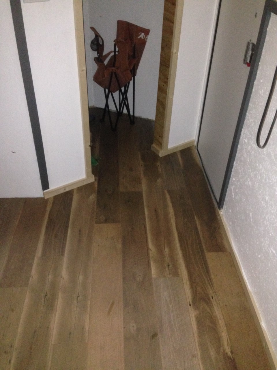

I was able to get the flooring in last week, really makes a huge difference. I was picking up all sorts of wood shavings when walking on it before lol. Still haven't gotten around to finishing the shower yet but it's on my to do list soon.

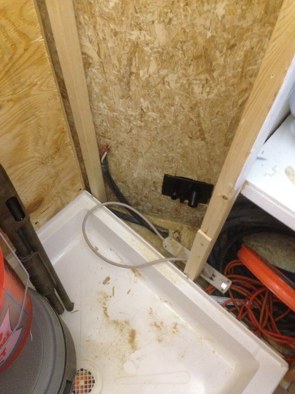

Someone posted a comment about CPVC turning brittle over time, since I started running most of my water supply lines in this stuff I decided to switch over to PEX. I really hadn't gotten super far so It's not really that big of a deal. I already bought basically everything up front not knowing what I would use at the time. Anyway, today I made the first cut in the trailer exterior :frightened: with the water inlet box I ordered months ago. It came with some sticky stuff which I wrapped around the back and then screwed the box down. Finished it up with some proflex I think is what the caulk is called, hopefully no leaks. So I will be using the garden hose attachment for the most part, it looks like a barbed fitting sorta but definitely not 1/2". Any idea how I can hook up the 1/2" PEX to it? If it wasn't obvious I'm learning the plumbing as I go :lol: .

Build is coming along nicely. The floors look good. Is that laminate/wood/ or engineered wood?

Good job, I passed the buck on my first hole I had my friend do it..
