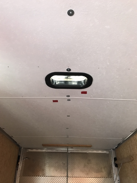

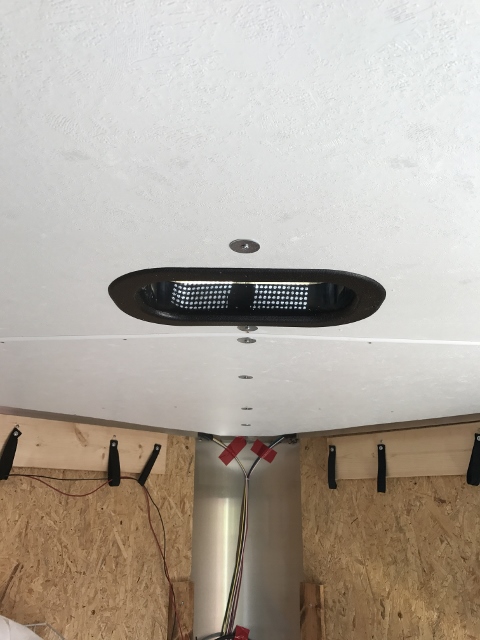

Postby featherliteCT1 » Wed May 31, 2017 6:43 pm
5 white ceiling vent rear (480x640).jpg (149.67 KiB) Viewed 4654 times
The vent holes I cut in the insulation turned out pretty good. However, the garnish cover is 1 inch short so you can see the first layer of insulation adjacent to the roof. I am wondering if minwax polycrilic would work to seal the exposed foam. Can someone give me their opinion about this or suggest another readily available product??
4 white ceiling vent V (480x640).jpg (151.79 KiB) Viewed 4654 times
Next, I will start insulating the sidewalls.
