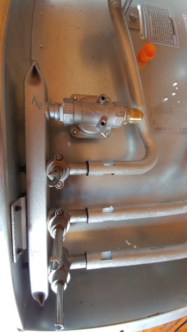

Looking for ideas on hooking up the propane tanks to the stove and also may want to do a quick connect with shut off valve for the heater buddy, to use when needed. The other option would be just mount it some way so it is always hooked up. Two hoses on a splitter?

I would install a regulator due to the fact that you have a cook top installed that is,
apparently, unregulated. That in turn will create a problem with the Mr. Buddy, as it
has it's own regulator which you will need to find an approved work around (Google
is your friend here). If you had a self regulated stove (Coleman type, no affiliation),
then you would be able to use the above linked items as is...

Now I am really stumped. So regulator on the stove ( suburban) but not for the heater buddy?
Good to know. I fired up the heater buddy on a screw in that I had and was surprised how fast things heated up. Also mounting it where I want will not work. Did not like how hot the ceiling and cabinet got. So I found the perfect place on the floor wall cabinet where it can be mounted, can hide the hose but also pull it out to a safer place if desired. Plus I already have a 10' heater buddy hose from the pop-up.
So maybe a splitter with one side to the 10' heater buddy hose, and then another hose with a regulator for the stove. That might work.
The regulator spit would not work then nor did the ends match up another problem I seem to be having.

Finishing up front and back cabinets and then on to hooking up the propane. Hoping the hose I have now to heater buddy will work, no regulator just a strait hose with male fitting. The stove is the big problem now, finding hose with right female fitting.
If anyone has a resource on a surburan 3 burner stove hook up hose to tank splitter fitting please send it my way. .
Thanks again!

My problem now is finding a hose the will fit this 3 burner stove to the tank.

You can get a copper line and adapter, then go with hose. They even make quick connects. I think I gave my 3 burner that had a hose and quick connect to the guy that refrubs old travel trailers. I look and see if I have it and will post a pic if I do.

Thanks! Picture would be a big help.
