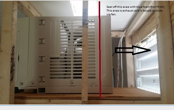

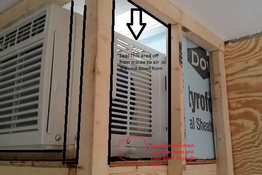

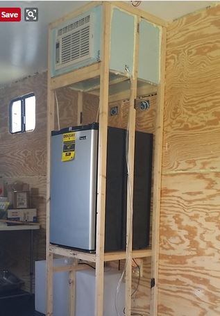

Padilen, here is some information on my AC build as you requested in the PM. This should give you some ideas. You can obviously get creative and do something on the floor, midway or etc.. Just need to isolate intake, exhaust , and interior from each other and have adequate volume for intake and exhaust with a free flow so as to not labor the AC fan too much.
Will have to do this in two posts. They only allow 3 attachments per.
Build the frame with the exhaust (side of trailer) vent and Intake (top roof). If you built this on the floor, you could build a standoff and put the vent intake on the floor similar fo ceiling. Exhaust still through side.
See placement of aAC on shelf relative to vents. Make sure the Intake is where it needs to be to not be wher the exhause chamber is built. Bolt AC to shelf and get drain hose ready.
You can see all I did then was take 1in Blue foam and cut to build the walls to isolate the exhaust from the intake and inside of trailer. All goes outside through vent. AC just bolts to shelf.
Remainder on next post.

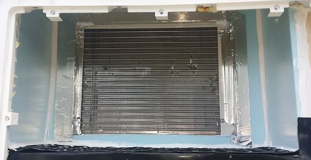

View of exhaust area. Just tape and caulk blue foam. This seals it all in and hold it in place. I put some flooring material on the shelf in the rear in case water blows in the vent so as to not affect the plywood. You could just paint it well.
Blue foam on face and sides to isolate intake from inside CTC. Now you have a complete intake and exhaust that is iolated from the interior. If you ever need to replace the AC and it is a different size.. just cut new foam. Foam is literally cut slightly large, pressed into place and taped off. The you just build a nice face for the AC and panel. This can be done on the floor also as mentioned... just flip the intake to the bottom and standoff from floor some to allow airflow up sides.'
See outside view of vents. Uses normal LP Fridge Vents that can be bought on Amazon of EBay. These are the Camco type. Other Venting can be used... up to you. Just make sure the volume is adequate.
As I built this, this unit just thinks it is sitting outside a window as intended. :)
P.S. for your trailer...make sure your new Generator runs your 8,000 BTU. I'd use that one. It is more than large enough for your size trailer. 10,000 BTU would be overkill if your trailer is insulated well... and you'd also be pushing your generator harder than needed. If your fridge is a self contained electric.. I would not worry about the complexity of venting it... it is adding some minimal heat (the heat from the compressor running is the only additional), it is just exchanging interior air (zero sum game).. In the winter you may welcome that minimal heat.. Sure, you could vent it.. but I'd personally keep it simple.. You are not building the space shuttle... And if you just opened your trailer door one time less per day... got it covered. That 8,000 BTU AC has the fridge covered. I am running 6,000 BTU with a larger Fridge and Trailer in Florida.... it works just fine and will last a long time. You got this!
