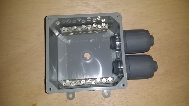

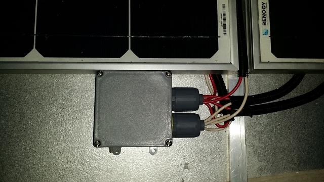

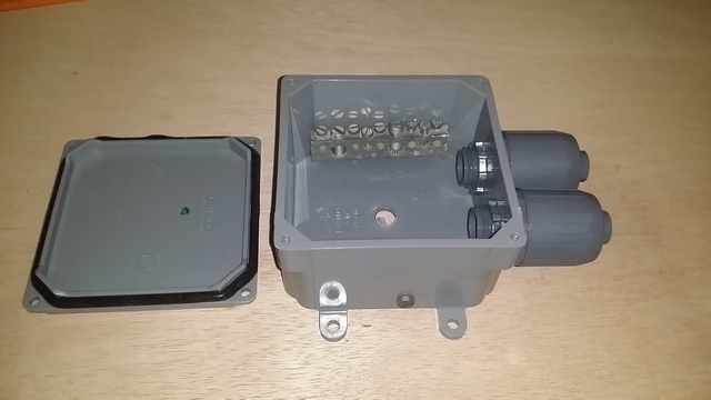

Hank, I meant to show you the pics of the junction box I made to connect up the panels and feed down through the roof as I mentioned in the previous post: I hope it is helpful for someone.
I have two inputs (+/-) and I have two terminal strips fastened down. I cut 1/2" holes for the conduit connections and one smaller hole for the Output that goes down through the middle. The 1/2" Waterproof inputs will accept 1/2 pvc conduit, so I will cut two pieces long enough to go under the closest panel. I'll run all the wires into the conduit under that first panel. I want to shield all the wires from the UV's given UV's will cause the insulation to break down over time. Additionally, that, along with the Silicone caulking I'll shoot into the end... should keep water out of the conduit.
I may be hooking it all up tomorrow night after work if weather permits. I'll post some pics.

Re: 7'*18' V-Nose Cargo Trailer Toy Hauler Conversion
Postby hankaye » Tue Aug 23, 2016 8:33 pm
flboy, Howdy;
Don, appears to be a very imaginative and well thought out contraption. Are you going to put a layer of butyl tape
between the box and the roof to keep the elements (water), from drippin' through the wire hole and the screw holes?

Postby flboy » Tue Aug 23, 2016 8:41 pm
hankaye wrote:flboy, Howdy;
hank
Absolutely... Butyl Tape underneath and some Dicor to surround for good measure. :thumbsup:
With all these Holes I have been cutting in this tin can... Dicor and Butyl tape, as well as good old Silicone RTV are my best friends.

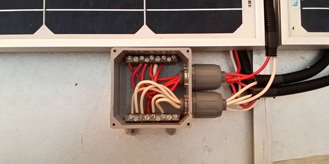

I still need to clean up the wires and insulate from the UV's, and add the Dicor.... but you can get the idea of how this worked out. I think it will work well and I can easily isolate a cell to troubleshoot and etc. by removing a wire from the terminal. I'll get it all wired up through the controller in the next few days and test it all out. :thumbsup:

Postby hankaye » Wed Aug 24, 2016 9:53 pm
flboy, Howdy;
Ya got me curious again ... I see all the RED wires on one side and all the WHITE wires on the other Ok, ...
so then I see a lonely WHITE wire on the RED side and a lonely RED wire on the WHITE side. OK, WTHeck ???
Bottom pic. I see one of each, are those the lonely wires from above? How do you keep the Pos(+), remembered
from the Neg(-) if you're swappin'em back an forth ????? Dealin' with a large puzzlement on this end.
Other than that ... truly a nice peace of work.
hank
hankaye
Posts: 2567
Location: S.W. New Mexico
Postby flboy » Thu Aug 25, 2016 4:19 am
Hank, Good eye! Wow!
When I built the connectors and extender cables, I got the polarity of the connectors and wire color swapped . I intended red as positive and white as negative. It turned out that I had negative on red and positive on white on the panels. When I dropped the cables through the roof, I just got the polarity back to red for positive and white for negative so I was not confusing in the electrical panel.
I didn't want to take the cables back apart to fix my error since they were all soldered and etc..

Postby hankaye » Thu Aug 25, 2016 9:11 am
flboy, Howdy;
Thinkin' you might want leave yourself a note with that information on it inside the junction box
for yourself or the next owner should you/they need to go in for a repair at some later date. I
know that my forgetter is startin' to work better than my rememberer lately ... Still think you've
done a bang-up good job there. :applause:
