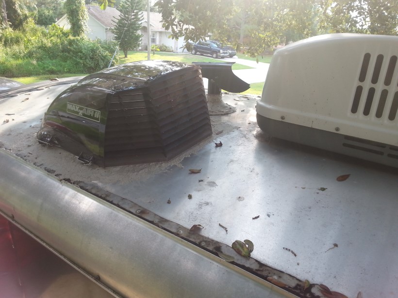

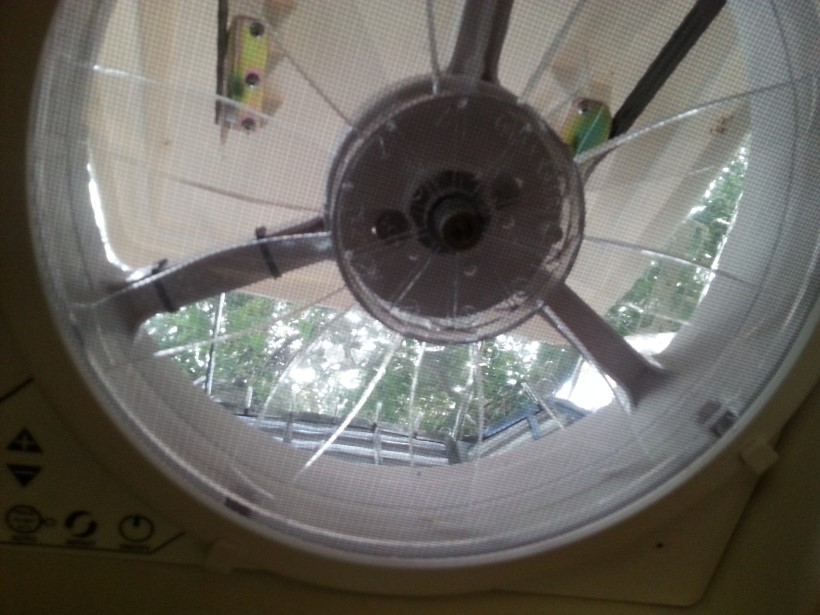

vent. like it very much :thumbsup: :beer:

The vent cover looks nice... You'll be able to leave the vent open now when it is raining and when going down the road. :thumbsup: :thumbsup:

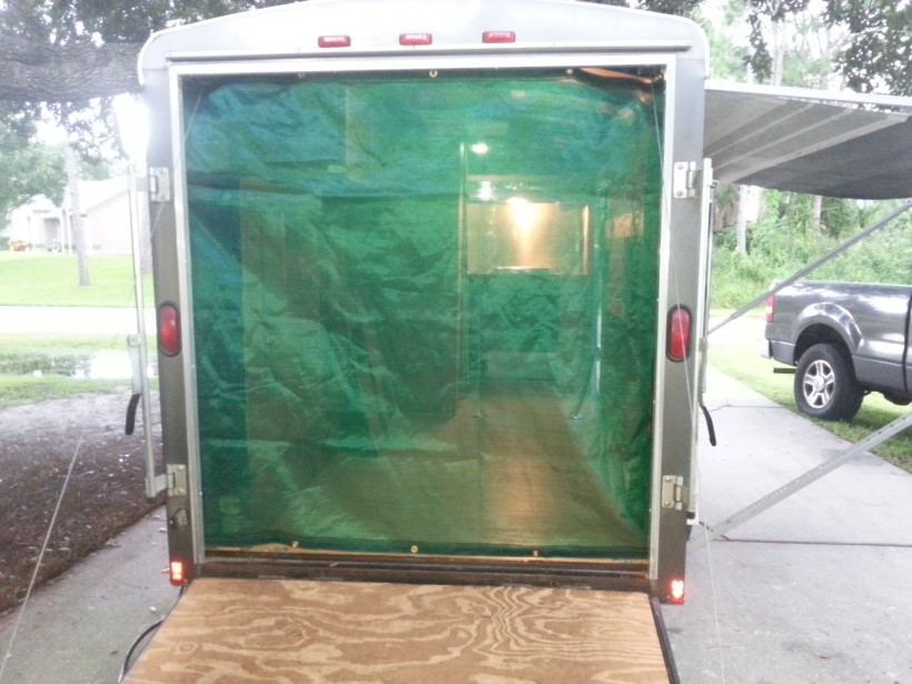

Postby Tommy B » Mon Sep 26, 2016 7:49 am
Oh hangover Mondays,
Anyway, Finished last cabinet door. Forgot how much I missed sanding and staining. Not.

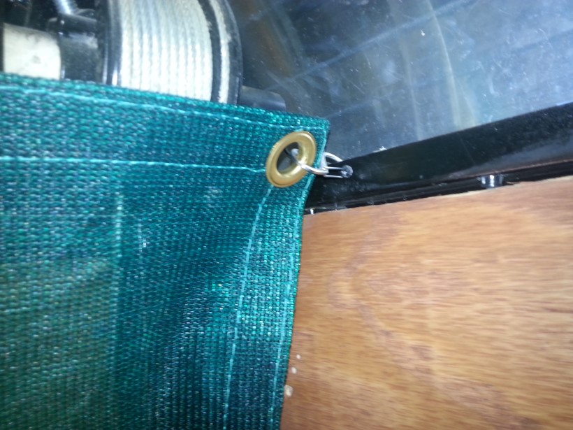

Figured a way to install the green mesh Using S-beaners mostly. Had to use 3 small s hooks for the top islets. Two bucks a piece. I bought 10. I will post pics later tonight. Forget Velcro. This set up is quick and will last forever. At least for my 6x12. This mesh is stout and opens like a shower curtain on the right. Flip it shut and it hangs naturally closed. If your not going to use the rear to exit you can utilize all islets and it is tight all the way around with 2 feet excess on the exit side effectively sealing off the entrance by its weight. Its NOT totally sealed but 95% I would say

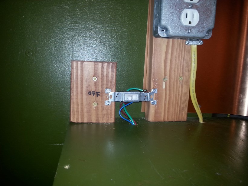

One other very important item is the on/off switch for the water pump. THIS IS A MUST. Will be by outlet near the sink. I will NEVER leave that C.T unoccupied with out flipping the WATER PUMP OFF.
Friend had new toyhauler. Loaded up first trip. Tossed sleeping bags in last minute. Did not notice bag hit sink faucet. Got to location, found 30 gallons of water in trailer. Ruined the pressed wood floor and carpet and pretty much everything. But I too have had my own bad experiences during construction. Wired pump back wards, bad pex connections, you name it and I had to pull the damn fuse to get it to stop. Of course my fingers are wet.
Less talk, more pics tonight.

Don the only piece of advice I would ever feel comfortable in giving to any one about electrical stuff..is DO NOT pressurize you system for the first time with out having an imitate electrical cut off. And a few towels handy. Good luck.
I will trick that switch plate out nice with custom wood look. Give me time.

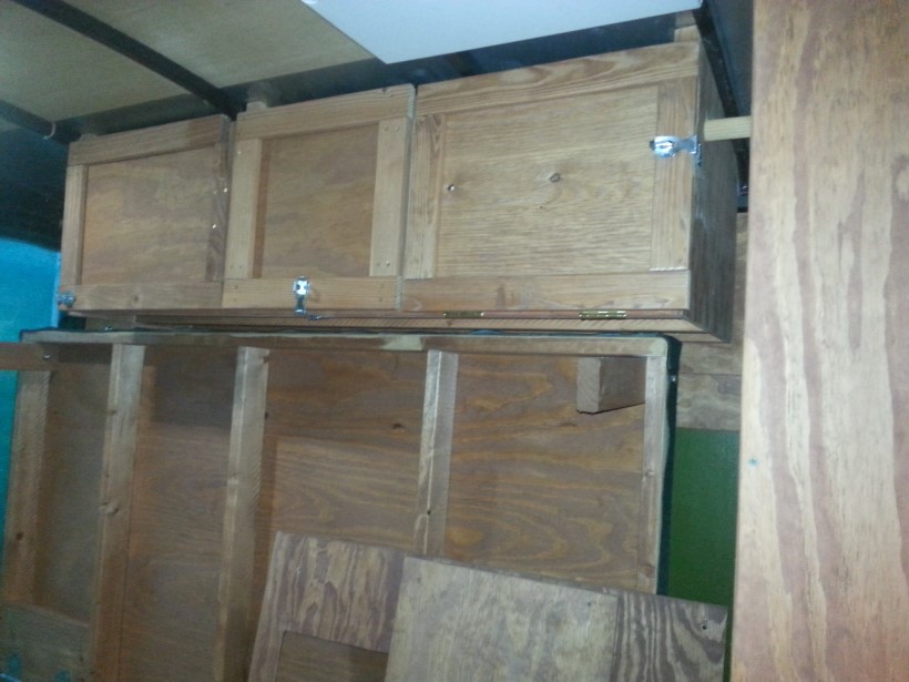

I have to give flyboy a run for his money so here is my aft cabinetry finished. Also my high tech folded bed holder upper thingy. fo dolla and change. Fo me. :beer: :beer: Hair of the dog. :beer: :beer: :beer:

Tommy B wrote:Don the only piece of advice I would ever feel comfortable in giving to any one about electrical stuff..is DO NOT pressurize you system for the first time with out having an imitate electrical cut off. And a few towels handy. Good luck.
Tommy, I have a cool 12VDC switch for you. I bought a few and I wont use them all.
