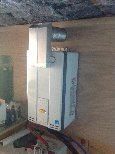

Crazy Jerry has a 180,000 Btu Jazuzzi water heater in the trailer for 7.5 GPM
My faucet only uses 1.2 GPM to save water -
I have it connected to 2 x 20 tanks & was surprised last year I used hot water at 120 deg F in my tanks
To heat my trailer 40- 80 gallons - water kept trailer warm 3 days
I have pictures on my blog
I have a outdoor heater - fixed up with a dryer vent - vents outside 4" round hole
With the low water flow my flue gas is maybe 120 deg - 130 max
No gas smell or anything inside the trailer :D :D

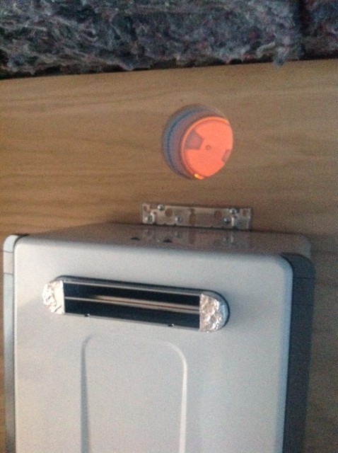

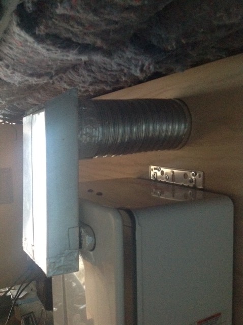

What you think MtnDon :D :D
The indoor model was $895 plus $200 for a nice vent,
outdoor model was $650 - $15 dryer vent
this is a dryer vent, I cut it short & installed some slits & KABOOM !!
works like a charm vs the $150 stainless steel interior model $450 more
it looks a little tacky - but nobody see me talking a shower
