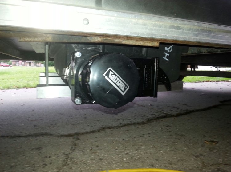

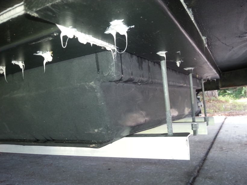

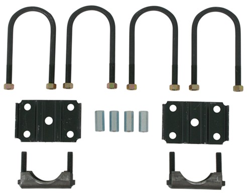

Postby Tommy B » Fri Sep 30, 2016 10:26 am
Hey I am looking for advice.
Im a little concerned that this set up is a tad low. It still is higher than the bottom of the axel by a little but I was thinking if you dropped a wheel in a pot hole or was in deep sand and roots it could get hung up. I dunno :thinking:
I could easily place the leaf springs on top of the axel with a 60-70 dollar kit I think. Right?
Am I being paranoid or sensible?
Thanks. Please chime in.

Postby Padilen » Fri Sep 30, 2016 10:50 am
Shop around I think I paid less. I'll double check.
about 42 on Amazon prime. I had my neighbor with prime get it for me.

Postby Tommy B » Fri Sep 30, 2016 11:49 am
Padilen based on that picture of my black tank set up would you recommend it?
Thank You for the response!
Tommy B
Posts: 891
Joined: Sun May 08, 2016 4:37 am
Re: HALLMARK 6X12 CONVERSION
Postby Padilen » Fri Sep 30, 2016 1:48 pm
I'm on a cell phone so I can't really see how much ground clearance you have.
But in general anything hanging down unprotected is usually what gets hit.
The kit is cheaper than bigger wheels , you get 3-4* inches out of it.
*some claim 6" but I got 3-4.
Padilen
Posts: 1536
Postby Tommy B » Fri Sep 30, 2016 2:06 pm
Padilen,
Thank you. Yes cheaper than bigger tires and god only knows what damage could happen if it did hit a root, rut, curb, and even some of the many truck tire strips that litter I-95.
I welcome more input. Depending on what I hear from you guys I will most likely order it first of the week and do this next Saturday. Hopefully I can flip receiver and ball and it will be level so I don't have to buy a new receiver also. They are expensive.
At first I was only going to make a shield of some sort but thought about it. 3-4 inches and a shield would give me piece of mind at least. :thinking:
Have good weekend!
Postby hankaye » Fri Sep 30, 2016 9:02 pm
Tommy B. Howdy;
Ok,
1) How far below the trailer frame is the lowest part of your plumbing discharge?
2) How far below the trailer frame is the lowest point of your suspension?
3) Is your plumbing in front of the suspension?
4) Do you anticipate (likelihood of 80% or greater), of getting into seriously rugged terrain?
(tow vehicle going up at a sharp angle while trailer still going downward creating a 'pinch'?)
These are questions you (IMO), should consider while considering your options. I would go
with the guard just for peace of mind about road debris alone. Jacking the trailer is to me,
a double edged sword. True it improves your ground clearance but increases the ability to
have a 'pinch' as in question 4.
By elevating the trailer you will also be creating the need for steps. How are your knees?
The fold-up type are nice but if you get a double then you'll need to always find a location
that will permit both to be deployed. A single will/might require a 'helper' step that you'll
need to bring in at night and deploy in the event you need to step-out at any time later in
the evening or early morning.
All-in-all your trailer, your time, your $'s ... the above is only part of the mental process I find
myself going through.
Good luck and please keep us posted as to your decision.
hank

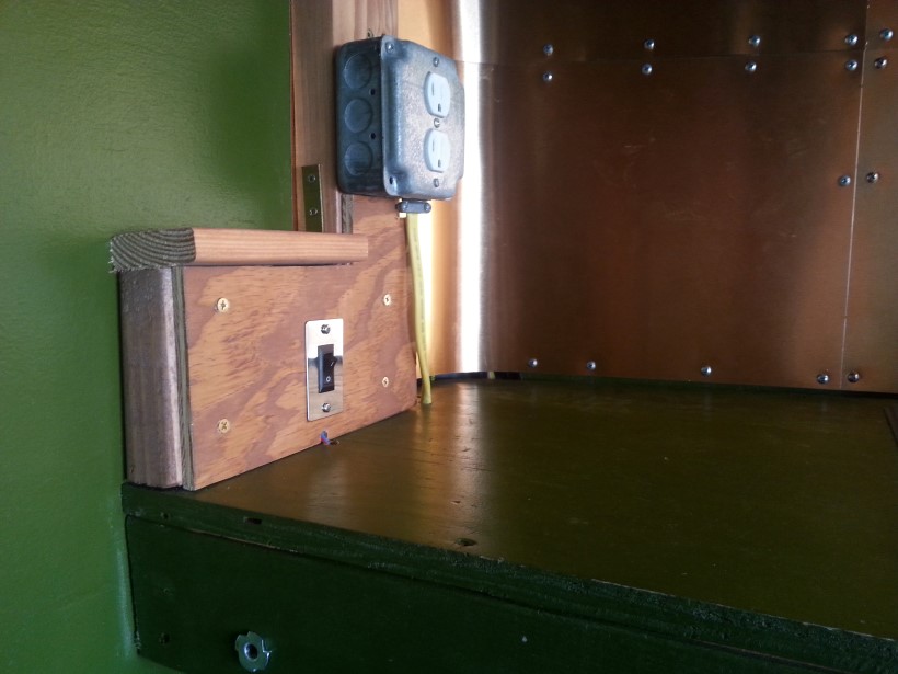

Postby Tommy B » Sat Oct 01, 2016 11:32 am
Ok water pump switch done. Thank you Don.
After much research on the stinky slinky holder, It is better to just go with the valterra version when its all said and done. $47.00 or so.
I will forgo the lift kit and place the tube holder just in front of the tank. It will provide some protection I think. Maybe grind an angle into those brackets to help with deflection.
Oh Mcdave I am not looking for work brother I only want to do this once and do it right. Time will tell if I made the right call. I will order that tube today.
Thanks for the input, always appreciated. :beer:
