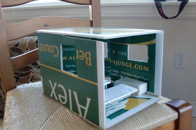

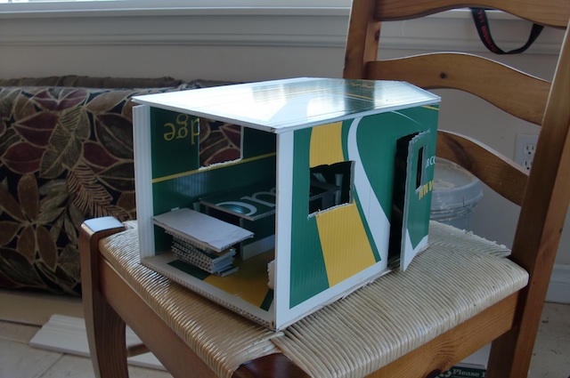

:) I put a political sign to it's best use to make this lovely model. You can see my bed, table and ice chest, all made with equal skill and attention to detail. :)
This model demonstrates the extent of my planning so far. My friend Alex lost his bid to become a judge, by about 7 votes. He'll be pleased to see I put his signs to a practical use. I'm also using the signs as insulating 'shades' for the windows. Sandwiched by Reflectix aluminized bubble wrap. Prob'ly just put squares of velcro on the corners.

Dant, graat idea building models .... That does give you some valuable experience , seeing how everything fits together... just a smaller scale ... :thumbsup:

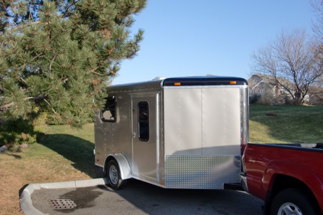

Postby Dant » Sat Apr 09, 2011 12:14 pm
More pics on my album.
I'll take more interior photos when I start doing more. My shelving bed frame is different now and I'm going to use peg board instead of the foam in part because the rough surface is perfect for not letting the mattress slide.
Next step is the house battery. Rather than mount a battery externally or in a vented box (very little room on the tongue) I'm thinking of an Optima inside. I'm going with 12 volt only as I don't plan to be in any RV parks or have access to 110 AC

You will still have gassing with an Optima Battery. Every led acid battery will produce corrosive and toxic fumes when the voltage exceeds approx 13.7 volts. (normal charging voltage is in excess of 14.0 volts.)
An option is to mount the Optima under the trailer or purchase an AGM battery of a different size and mount that under the trailer. Like the Optima, the AGM batteries can be mounted on their sides.
