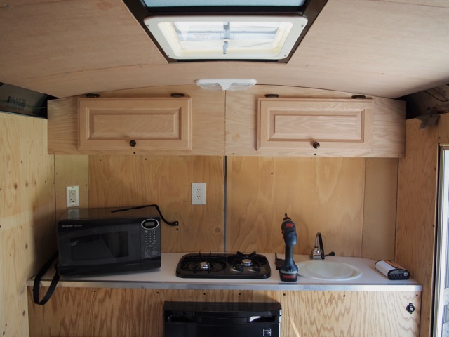

Today I installed the doors, hinges, and knobs and put them up for a test fit. Everything looks good so now it is take it all back apart and start the sanding, staining, and clear coat.

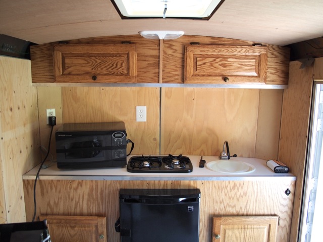

I stained and clear coated the OH galley cabinet/doors and reassembled them today. I'm amazed everything came out pretty darned straight. :shock: Now all I need to do to completely finish the OH is cut the corner moulding for where the cabinet face meets the ceiling and stain and clear coat that along with staining and clear coating the moulding that covers the seam down the center of the cabinet face. I used the same aluminum angle to finish off the lower edge of the upper cabinet that I used to finish the upper edge of the lower cabinet... got that? 8)
It's not looking good for the hammered tin we plan to use for back splash protection behind the stove, sink, and microwave to arrive before we leave as we have received no notice of shipping so very doubtful it will get here in time. Oh well, there's still lots more work to be done when we get back. :NC Be that as it may, we're hoping the aluminum angle and the hammered tin compliment each other and kind of bring the galley theme together with the wood cabinets... Good grief Don, it's only a cargo trailer, not something suitable as a "Better Homes & Garden" magazine feature article. :roll:
In the pic below the upper cabinet looks darker than the lower cabinet but they actually match quite closely. It's a photographic lighting illusion. Honest. The upper cabinet is recessed further back from the door compared to the lower cabinet and the lower is getting strong side sunlight through the door whereas the upper cabinet is in deeper shadow.
Tomorrow I hope to get the underside of the CT where I cut the opening for the a/c vent silicone sealed and sprayed with black undercoating to seal out any potential moisture intrusion into the plywood floor, such as when traveling in the rain. Then it is install tie down straps for the a/c unit and the 1 gallon propane tank and we'll be about as ready to go as we can get at this point.

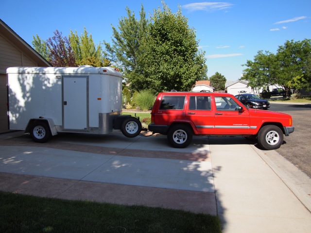

Today we hooked up the CT to the Cherokee to go pickup a 7' sofa/hide-a-bed unit. This is the first chance we've had to use the CT and Cherokee since I installed the airshocks on the Cherokee. What a difference they make. I only inflated them to 100 psi (they'll inflate to 150 psi) because none of the pressure gauges I have read above 100 psi and I didn't want to risk over-pressurizing them. Still, at 100 psi the shocks do a great job of leveling the Cherokee with the CT attached. Compare the two pics below. The first is with the airshocks inflated to 100 psi in our driveway with the 7' hide-a-bed couch inside (anyone who has ever moved a 7' hide-a-bed couch knows how much they weigh). Note that the CT is on a forward incline putting additional tongue weight on the Cherokee. The second is at my mom's house in Lake Tahoe this past winter with a rearward incline, taking tongue weight off the Cherokee, and still it is squat butt down without the airshocks.
This trial run also gave us a chance to check out how the little Viair 12v dc compressor would work to fill the airshocks. It worked great! :thumbsup:
Once I move the Cherokee and CT back to the level street and pump the airshocks up a bit more I'll post another pic, but they really do a great job of leveling the Cherokee/CT combo.
