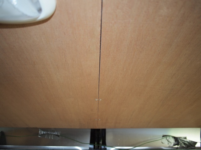

I may have missed it, can you tell us a little more about how you did your ceiling?
Pat
Pat,
Only problem is I don't have a ramp, I have barn doors, and our bunks run crosswise up against the barn doors. The a/c unit won't fit under the bunks, which is OK since we use that space for our storage bins. I've got a 14" x 14" x 2" cake baking pan that will fit over the air intake area on the back of the a/c unit completely. I'll cut a 4" hole in the bottom of the pan then install a standard dryer vent outlet, probably put a standard 4" dryer vent in the sidewall of the CT and duct the two together. That way all incoming air for the a/c unit will come in through the standard 4" dryer vent and exhaust through the a/c unit's 5" vent pipe and through the floor. It sounds good... in theory. :lol:
As to our ceiling; I first installed 1" blue foam board then cut Luan paneling to fit. I spaced the Luan paneling so the ends would meet on one of the CT's overhead frame rails. I then held the Luan paneling in place and drilled 1/8" holes through the paneling, through the frame rail, and then used an aluminum pop rivet to attach the Luan panel to the frame rail. I have yet to decide what I will do about the seams, or should I say sealing/covering them but figure I'll come up with something, or steal... errr... adapt more or less. :FNP

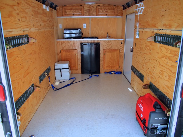

Here's a shot of our CT emptied out for use in a CT role i.e., hauling stuff. We emptied it to haul a hide-a-bed couch we bought used. Didn't have to remove the generator or porta potty to get the couch in. It took us about 15 minutes to remove the majority of stuff (bunks, storage bins, table, chairs, a/c unit, etc.) to open the CT for hauling stuff. Our dual use CT works! :thumbsup:

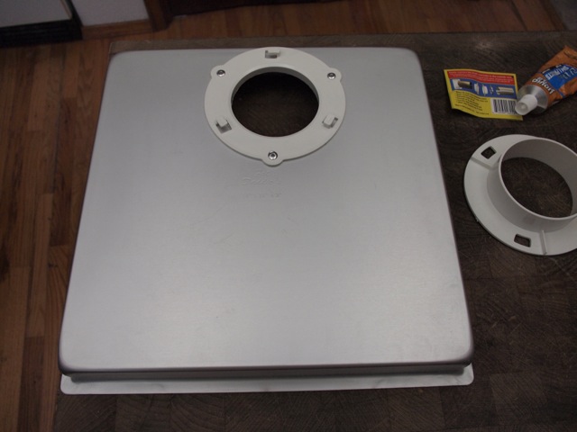

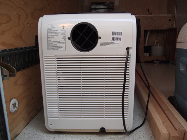

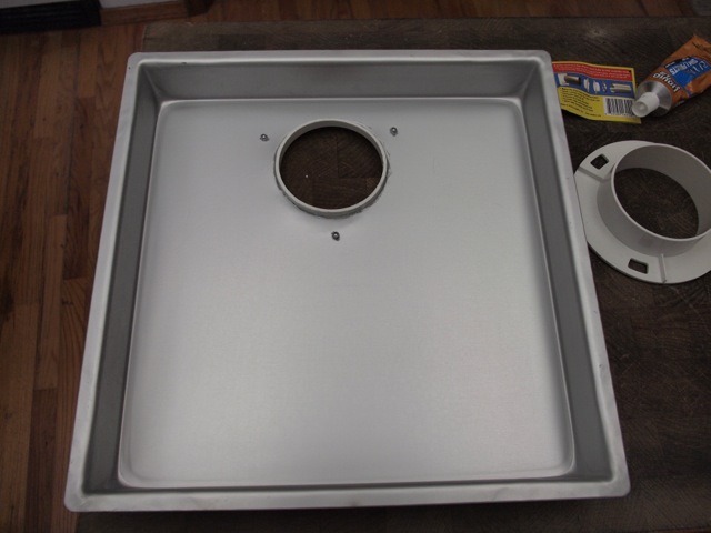

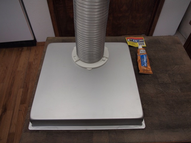

OK, so we bought a Commercial Cool (Haier) portable 8k btu a/c unit via Home Depot. It is a single hose unit, meaning (once I did my research after I bought it... too typical of me :NC ) that apparently it isn't as efficient as a two hose unit. Apparently the difference between the two is that a single hose unit exhausts hot air that has passed over the condenser to the outside via a hose. Feed air is drawn in through the back of the a/c unit via a large open to the CT interior vent/grill. What that does is create a vacuum within the CT so that any nooks and crannies in the CT that are not adequately sealed, of which there are many no matter how water tight you think your CT is, well those nooks and crannies allow hot outside air to be sucked into the CT (because you have a vacuum created by the single hose a/c unit, making them less efficient than dual hose unit). As I understand, a dual hose unit exhausts hot air through one hose and draws in out side air from another, no vacuum is created within the CT so the CT is positively charged with cool air from the a/c unit and that creates a positive pressure within the CT pushing cool air out of those nooks and crannies. Makes sense to me now that I understand how both a/c unit types function.
OK, that said, so you, like me, plunked down your hard earned money for a single hose unit and find it struggles to keep your CT cool because all those nooks and crannies are letting hot outside air sneak into our CT and making your a/c unit work harder, hence less efficient. What to do about that? :thinking: I believe I found the answer and the answer is "Fat Daddio's" baking pans.
I measured the back open grill area of my a/c unit and found that a 14x14 cake baking pan would cover the area. So I got on the internet and went in search a 14x14 pan with sufficient depth to meet my perceived needs. Bingo! Fat Daddio's sell multiple size cake baking pans. I found they had a 14"x14"x 2" deep pressed aluminum pan. Perfect! :o I ordered one for $15. It arrived today. With pan in hand now, my next trip was to Home Depot to find suitable flanges (standard 4" dryer vent stuff) to connect a 4" hose to the pan and then to an external inlet in the CT wall (or floor), along with a Milwaukee 4" hole saw. I found everything I needed at Home Depot.
The sequence of pics below are of the back of my portable a/c unit, and the Fat Daddio's cake pan vent fabrication. The fabrication will be described above each pic.
Back of the portable a/c unit showing the exhaust tube outlet (the round hole), and the inlet vent (the big square grill area) to be covered by the Fat Daddio's cake pan:

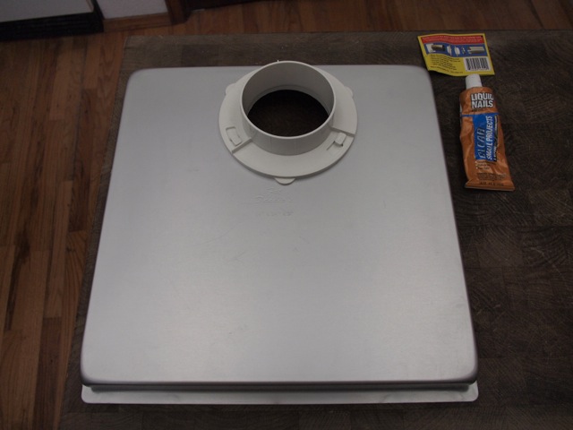

The Fat Daddio's cake pan after I drilled the 4" hole with the Milwaukee 4" hole saw, something I learned with this experience about cutting a 4" hole in a cake pan, make sure you have a solid backing such as a big chunk of wood underneath that you are cutting against.
While at Home Depot wandering about trying to figure out what I needed to connect the inlet line to the "Fat Daddio's" cake pan I came across this item: "DryerDock, The Dryer Hose Quick-Disconnect" (made in the USA by VentPro, Inc.). Basically it is a very short turn quick-disconnect dryer hose adapter. It has a 1" long flange on both sides to attach a standard 4: dryer hose to. I cut the flange down to 1/4" with a hacksaw on the flange side that inserted into the "Fat Daddio's" cake pan. I drilled three 3/16" holes through the cake pan to match the flange attachment holes, then used liquid Nails clear adhesive to seal the flange to the cake pan then used 3/16" aluminum pop rivets to permanently attach the flange to the "Fat Daddio's" cake pan.
By the way, yes I know the flange is not properly centered (left to right) on the "Fat Daddio's" cake pan. It was 100 degrees here in Boise today and seemed hotter in my closed garage. I was sweating bullets and wasn't too concerned with centering since it makes no real difference in efficiency and anyone that cares to get behind the a/c unit to look and tell me so, well they can kiss... uh oh. Be nice Don. :roll:
The next two pics show the air inlet tube quick-disconnet flange attached and the air inlet hose attached to the quick-disconnect flange (the tube will be clamped to the flange with a 4 1/2" hose clamp). The hole idea of the quick-disconnect is so we can detach the exhaust and inlet hoses and strap the portable a/c unit to the CT wall for travel.
Next up will be attaching the "Fat Daddio's cake pan to the back of the portable a/c unit and then cutting a hole in the CT sidewall or floor (I am undecided at this point where to take the inlet from i.e. through the sidewall of the CT or the floor). I would prefer the floor but am concerned about inlet air sucking in hot exhaust air if I go through the floor so am thinking going higher up through the sidewall would be better for a/c unit efficiency. Any thoughts would be appreciated.
Don

Postby roadinspector » Tue Jul 10, 2012 10:19 pm
Nice set up!!! Well thought out. I agree, I would prefer the intake being thru the floor. IMHO, I wouldn't be concerned with any exhaust getting in while traveling. It should blow right by without any problem. If it is a concern, you obviously have your Masters in Southern Engineering, rig up a cap that will lock into the flange to seal it off. Get another male flange and put a rubber boot over it with a clamp holding it in place. Or while you are at HD, take the male fitting over to the plumbing dept and test fit pvc caps till you find one that is close. Use the same adhesive and secure it to the flange. You probably have already thought of it but you will prob want to put a screen on your intake to keep unwanted critters and shtuff from getting in.
Good luck and really enjoying your build.

Postby pmowers » Wed Jul 11, 2012 11:07 am
Thank you, thank you, thank you. I had never heard of the quick connect flanges. That just solved a big problem that I was working on, I did not want to use the galvanized collars from HD for my a/c mod. I thought that they were clunky, in the way and hard to attach. Those flanges are elegant, clean and just what I needed.
As for floor venting, what about making a small door (put the hinge toward the front) to cover the flange on the floor from below? If you got fancy, you could springload it, otherwise just attach a small bungee. You just reach down and hook the bungee when getting ready to travel. When you want to hook up the a/c, just release the bungee, door drops open, and attach your hose. If you used some of the elastic cord ( they have shoe laces made with the stuff at Target), you might be able to just insert the flange through the floor and open the flap, that way when you removed the flange, the flap would close automatically.

Postby sportxlh » Wed Jul 11, 2012 4:45 pm
That's a nice explanation on the drawbacks of a single hose system. Other people have tried to describe one vs. two hose systems, but until your post, I don't think I really understand the downside. BTW, the front cabinet area looks fantastic!!!!

Postby d30gaijin » Wed Jul 11, 2012 7:38 pm
roadinspector wrote:Nice set up!!! Well thought out. I agree, I would prefer the intake being thru the floor. IMHO, I wouldn't be concerned with any exhaust getting in while traveling. It should blow right by without any problem. If it is a concern, you obviously have your Masters in Southern Engineering, rig up a cap that will lock into the flange to seal it off. Get another male flange and put a rubber boot over it with a clamp holding it in place. Or while you are at HD, take the male fitting over to the plumbing dept and test fit pvc caps till you find one that is close. Use the same adhesive and secure it to the flange. You probably have already thought of it but you will prob want to put a screen on your intake to keep unwanted critters and shtuff from getting in.
Earnest
Earnest,
Thank you so much for the kind words. Yep, I do now have a Masters in Southern Engineering, have studied for it all my life. Is there any better? 8) I majored (BS) in Home Ingenuity and went for my MS in Southern Engineering. :R
Thanks to you and others I believe I will go ahead and go through the floor for the a/c inlet. It fits with the stealth CT perspective we have been pursuing all along.
Don

Postby d30gaijin » Thu Jul 12, 2012 12:01 pm
pmowers wrote:Thank you, thank you, thank you. I had never heard of the quick connect flanges. That just solved a big problem that I was working on, I did not want to use the galvanized collars from HD for my a/c mod. I thought that they were clunky, in the way and hard to attach. Those flanges are elegant, clean and just what I needed.
Pat
A penny for my thoughts is grossly overpaying.
Pat,
I'm glad I could be of help. The two piece quick disconnect dryer hose coupling is a pretty slick unit. I went and picked up another this morning to use on the floor of the CT when I punch the a/c inlet 4" hole through the floor. I think I'll use your suggestion about a door and a bungie cord or something on the underside of the CT to seal off the hole when not in use. Thanks for that tip. :thumbsup:

Postby d30gaijin » Thu Jul 12, 2012 6:17 pm

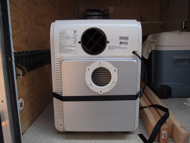

Earlier today I glued the "Fat Daddio's" cake pan with 4" dryer quick-disconnect flange to the back of the portable a/c unit. The strap is to hold the cake pan in place while the "Liquid Nails" adhesive sets up. Later in the day I used bathroom white caulk around the edges of the cake pan to a/c unit edges to make sure there would be an air tight seal, especially on the left side where cake pan meets the a/c unit grill. You can see part of the grill on the left side but it isn't part of the airflow grill, it is faux to give the grill back a decorative look. I wanted to make sure all those grill appearing dips the cake pan is glued over were well sealed. I'll leave the cake pan strapped to the a/c unit overnight.
Tomorrow I hope to bore a 4" hole through the CT floor and use another quick-disconnect dryer flange for that hole screwed to the CT floor to seal it off then hook up the two hoses and try the a/c unit out to see if my "Southern Engineering" pays off in terms of better portable a/c unit efficiency. :R
