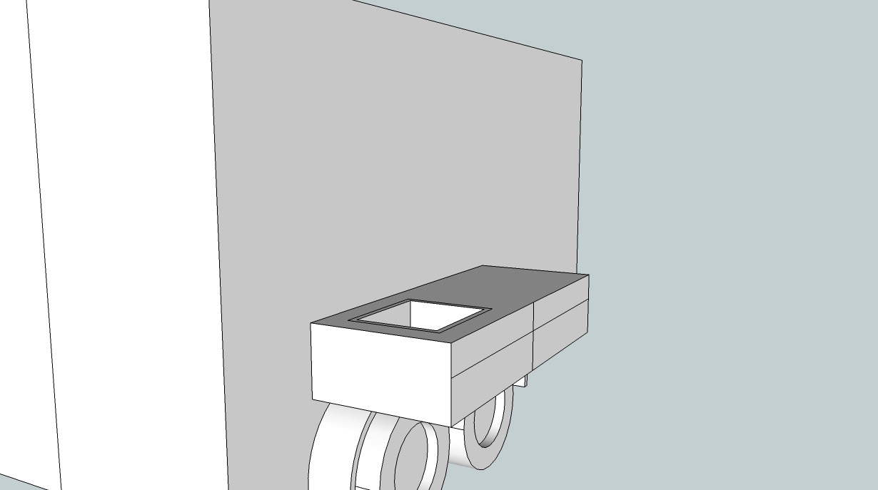

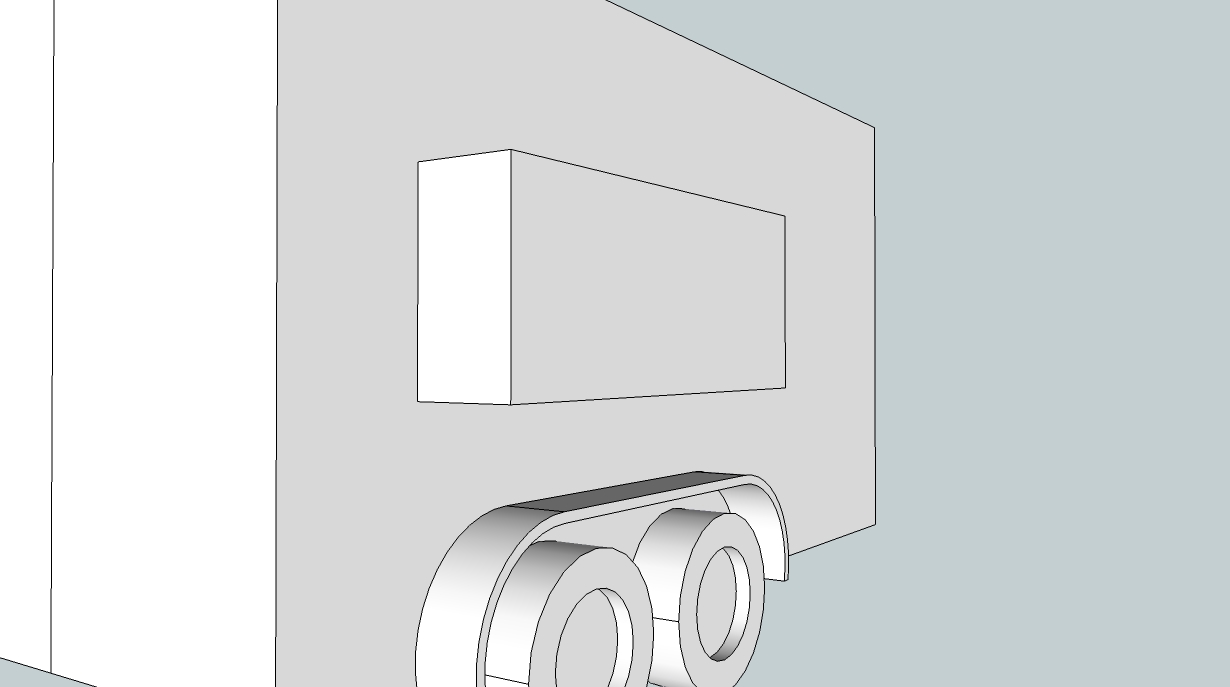

Postby dustboy » Wed Oct 22, 2014 11:08 pm
I'm thinking about moving the galley outside. It would let us push the bed a couple feet back toward the rear door, and frees space up front for a small countertop for wet weather cooking and morning coffee.
Also we have a problem when the baby takes two long naps a day, and during that time we can't cook or clean dishes without waking her (nor can we get at the beer once the kids go to bed!).
It could hang on the wall over the fender, and swing down for use. A bag awning above it could complete the outdoor "kitchen". Not sure where the cooler would live.
Here's a quick sketchup of what I'm talking' bout.
