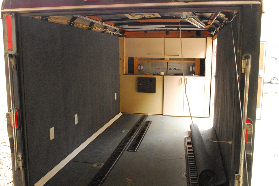

This is about as close as I could find, but it gives you the idea. I would be using etrack and the anchors so that it will be removable, but the principle is the same.
I did get a little done this weekend. I picked up and installed the soft touch close pieces for the cabinets (totally unnecessary, but fun), and then worked on the DC wiring. I finished the wiring for the outside lights and the inside LED's and wired in the switch panel. Got to actually use the converter part of the WFCO for the first time, and happly it and my wiring and lighting works. I also mounted the WFCO in.
I have a little more DC wiring to do, and then can get ready to close up the front. It will be usable at that point with fold up tables. Next is finishing the ceiling, finalizing what I want to with the counters, and building in the AC unit.

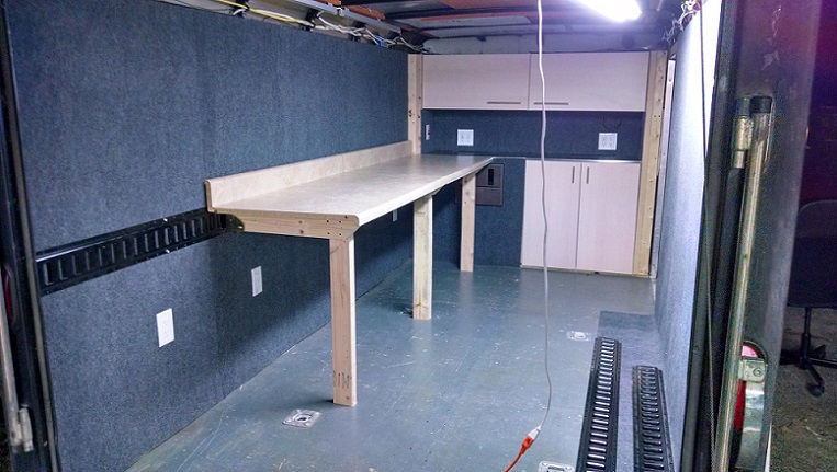

Postby orcadigital » Mon Feb 17, 2014 8:36 am
So updates have been few, but finally got some work done over the last couple weeks as the weather has warmed a little and we are getting closer to outdoor offroad racing season. I decided to carpet the walls, as i like the look, and whatever little amount it adds to temperature and sound insulation. I was planning on buying some indoor/outdoor carpet in the rolls, but when I got to Lowe's, they had some 6x8 carpet/rugs on sale for $17ea. I needed 3 to do both walls and the extra trim, so it was the most cost effective, and it is very light.
I am pleased with how it is looking so far. Attached to the walls with carpet tape and staples.
I also added in a pair of DC outlets, and ran another switched circuit for lighting under the upper cabinets. Once I find those lights and get them installed, the wiring should be complete. Need to do a few more carpet trim pieces and then get the trimwork up around it. After that, will be ready to put up the e-track and the workbenches.

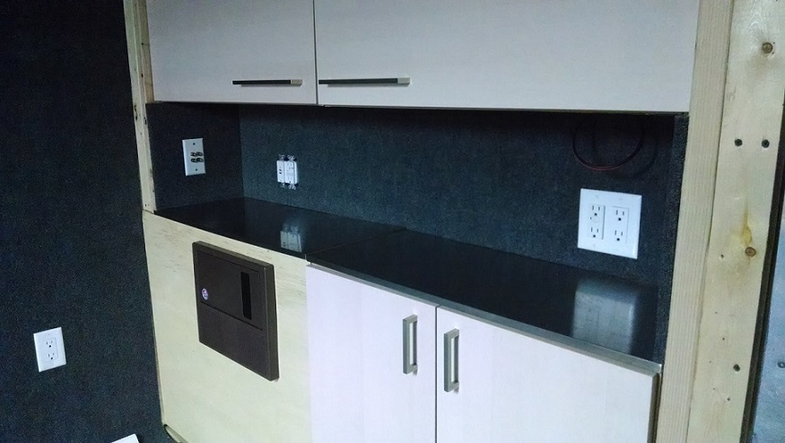

Postby orcadigital » Mon Feb 24, 2014 2:50 pm
I finally got some time over the weekend to rough in the counters. Trying to get it ready enough for a race this weekend (weather permitting). Once laid out, I think I know how to attach everything to make iot removable without too much difficulty.
Still need to get the last 2 pieces of plywood cut and carpet on them for the trim on both sides of the cabinets, then the baseboard trim, but not sure what I will get done during the week.
