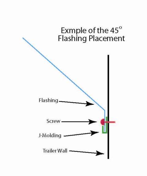

Postby AZ_Desert_Rat » Wed Apr 16, 2014 12:09 pm
Hi Cindy and all,
Here is the way that the inside wall to wall and wall to ceiling flashing is installed in my trailer (I also added this to my Gallery). It is fairly simple, leaves a finished look and if needed, a great place to hide wiring :twisted: :

Postby Rainier70 » Wed Apr 16, 2014 5:45 pm
Nice detail drawing. Thanks for taking the time to post it.

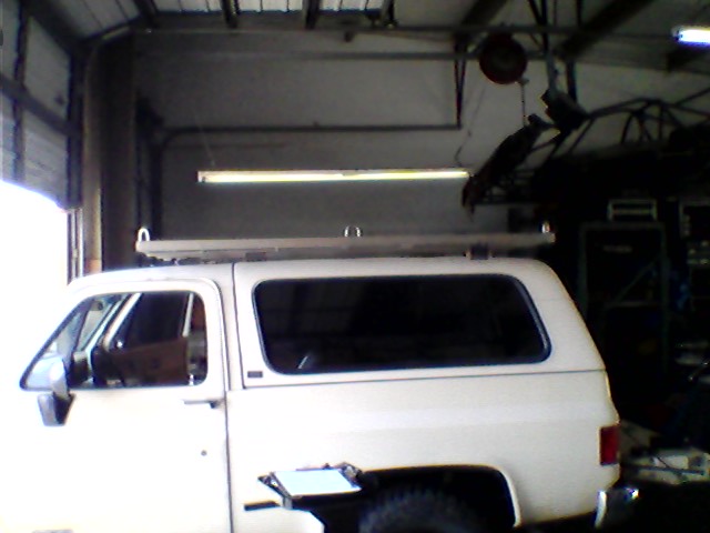

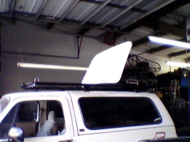

I thought I would catch up on the gas mileage and changes to my TV. The gear change from 3:07's to 4:11's worked great. The gas mileage seems to take a downturn between 65 and 70, with or without the trailer and something a bit lower would have been better ... maybe 3:73's (the next jump for Chevy). In any case, I try to keep that speed needle between 60 and 65; 63-64 works pretty good.
I also added a wing because of the trailer height at somewhere near 30 inches over the truck. I went with a DIY roofrack and bracketed the wing to it ... it appears to be giving me about 1-1/2 to 2-1/2 mpg improvement. The first round trip from AZ to MN and back averaged about 7 mpg ... that was loaded from AZ and empty going back (against a heavy headwind most of the way). The last trip being very heavy loaded (I probably had the trailer overloaded and the TV was packed as well) from AZ to MN exhibited a considerable improvement to about 12 mpg ... :applause:

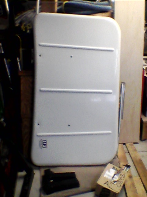

Here are some pretty rough pics (I'll Try to get some better ones with the trailer hooked up) of the wing (picked up from Craigslist), roof rack, rack with wing - final adjustment is about half as high. The wing has a spring adjuster for 5th wheels and when I took the pics it was still on. I am making struts without the springs - I do not like them nor need them. I'll get some better shots when I find my camera ... where did I pack that thing :thinking:
A wing install sight states that for a wing to work, the trailer must be within 6' of the trailing edge of the wing ... mine is about 4-1/2' and does work. The trailer stands close to 30" over the truck cab making the front of the trailer a huge dam ... the final adjustment took the bug line from about 14" to just traces at around 2". I realize this is no huge improvement, but an average of 2 mpg when towing is a savings over the year AND the wind surge when passing or being passed dropped considerably, as well as the headwind resistance was much better . 8)
