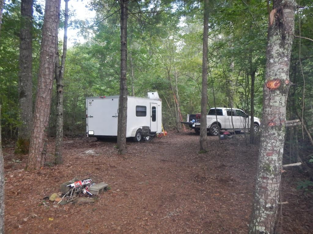

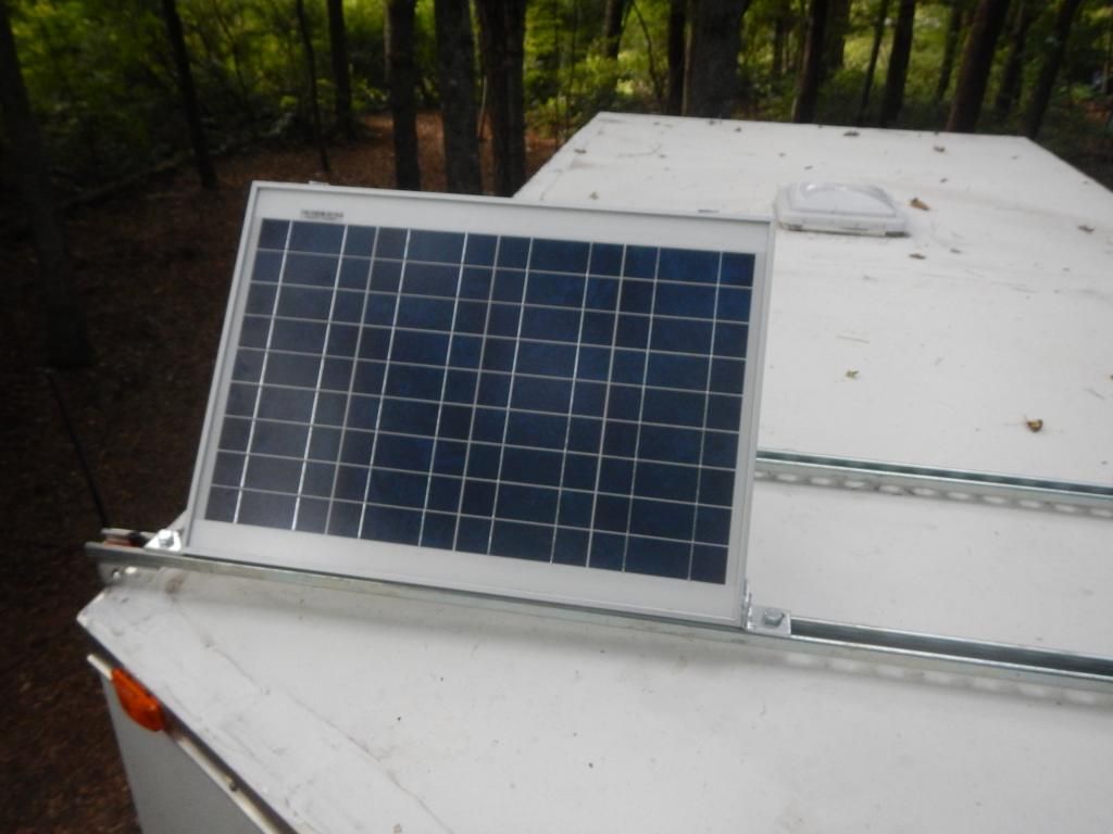

Postby RWH » Sun Sep 07, 2014 11:17 am
I finally got around to installing the solar panel and controller. I used a 35 watt panel with a charge controller. I did this at my new permanent riverside camping spot in the North Georgia mountains on my club property.

Postby lrrowe » Sun Sep 07, 2014 3:03 pm
Nice! :thumbsup:

Postby Rainier70 » Mon Sep 08, 2014 4:12 pm
Beautiful camping spot.
Do you have any other pictures of your mount? What kind of channel? How is it secured for travel? Etc
Thanks

Postby RWH » Mon Sep 08, 2014 7:10 pm
Rainier70 wrote:Beautiful camping spot.
Thanks
I'll try and get some more pics of the mount next time I am up at my site but I'll try to explain how I built the rack and mount. I will more than likely change it up a bit so I can rotate the panel as the day goes on but it is currently working fine in a fixed position the way it is now to fit my needs.
Rack Materials:
I used galvanized Unistrut or Superstrut and hardware to assemble all of the connections. This can be found at HD or electrical supply outlets. I bolted 4- 6" "L" brackets turned in towards the roof. Make sure you bolt into or through the header framework of the trailer to get a sturdy mount. The cross beams were spaced to mount the panel flat to the roof when traveling. To elevate the panel at location to face the sun, I used 1/8"x1" aluminum, found in the hardware section of HD. I bent the aluminum to shape and affixed it to the panel frame and rack cross beams. I then used coaxial cable a bushing meant to run cable through siding to run my panel wire through to the inside of the trailer to the charger controller.
I hope that was clear enough to understand my madness. :tipsy:

Postby Rainier70 » Mon Sep 08, 2014 7:36 pm
It was. I thought that looked like unistrut, but wasn't sure. Thanks.
