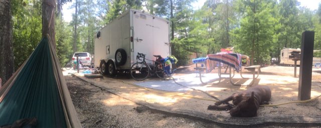

Still unpacking from our 2k mile round trip (10 days), which went great, as both the trailer and family didn't tear themselves apart. But here's some wrap up:
Mini split kept it warm and cozy while in the 40's; Sequioa towed it well without issue, though mileage wasn't quite as good as I hoped, but doing 70+ I can't fault it. Bunk beds worked well though we never actually use the table and ate inside mostly because we were with friends, who had an awning so we'd eat at the picnic table.
The shower became the baby swing spot so it never got used, but I also realized in a late night install I put the valve in upside down Doh!
Nose also held the bikes ImageImageImage
Length shots: ImageImage
Still need to clean up a lot of little things, and change a handful of things.
I'll highlight lessons learned and things to change in a later post.

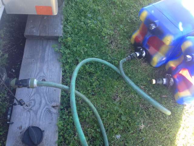

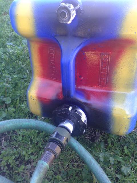

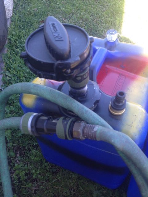

Made a workable solution for the blue Aquitainer jugs for grey water, I'll try to post a pic of it tomorrow but here's the jist of it; my initial issue was they were to tall relative to my drain outlet by a few inches so I couldn't just drain into the top. The existing white caps have the finer threads for the spigot, don't recall the specifics, so I put a conversion nut in to standard garden hose. This allowed me to make it water tight and put it on its side vent up, main white cap down, and eliminating my height/drain issue. I then put quick connects on to swap between a full and empty jug easily, or using a y for dual connections. A short section of pipe slips on the vent to vent from one to the other in case of soap bubble or other overflow, or park manager concern and viola, 7-14 gallons of grey storage for under $50.
During quick testing the other day it worked well. I think the only problem I could run into is if the quick connection orifice gets gummed up with food particles. If so I can always fall back on screwing them on, but that's more of a pain than I'm hoping for.

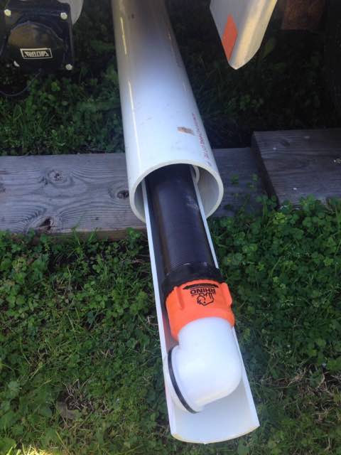

4" drain pipe cut in half works great for the sewage line support, definitely a savings off the pre made ones.
