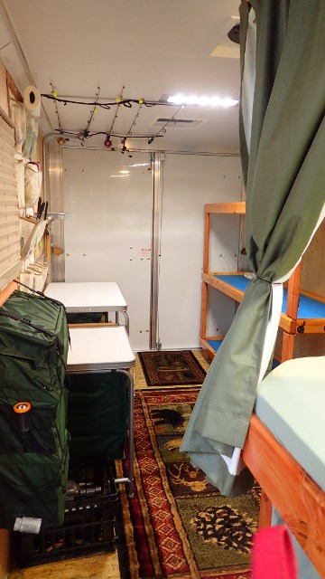

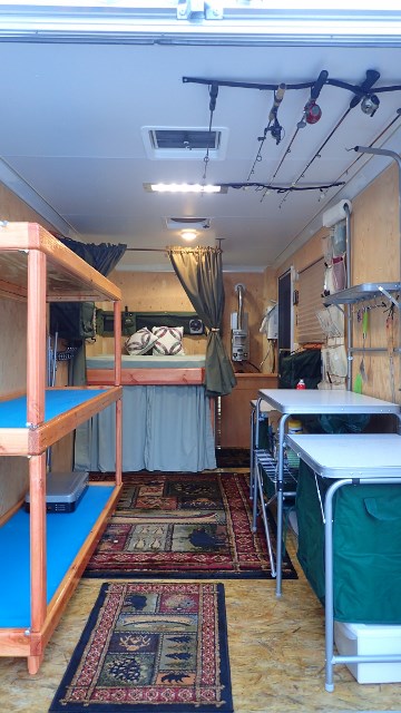

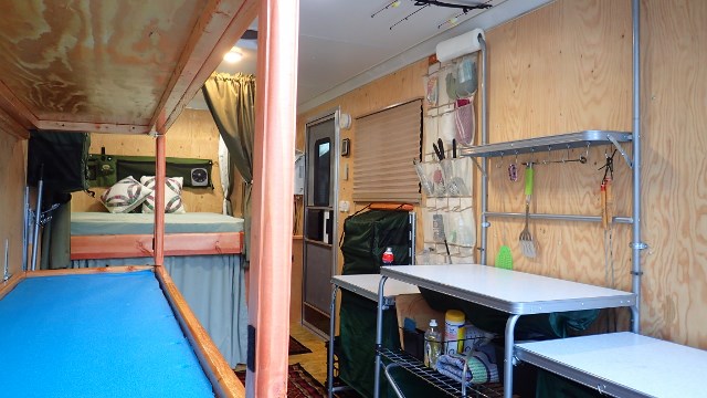

Postby outsidezion » Sun Mar 22, 2015 6:47 am
P3220002 (360x640).jpg (107.05 KiB) Viewed 3314 times
P3220003 (640x360).jpg (100.86 KiB) Viewed 3314 times
P3220006 (360x640).jpg (93.83 KiB) Viewed 3314 times

Postby dustboy » Sun Mar 22, 2015 8:55 am
7x16 looks like the perfect size for a family. We got 4 of us crammed into a 6x12 sardine can, there's enough room for us all to sleep but not much else!

Postby Gonefishin » Sun Mar 22, 2015 9:25 am
I really, really like the looks of that interior! :applause: Simplicity at work. Light. Dickinson! I'm using a similar strap system on my ceiling for my fly rod cases. I like the use of the Cabela's camp kitchen, and am working on possibly integrating some of that in the nose of my 6x12.
If you want a little more padding/insulation on the floor, I'm loving my foam interlocking padding. My throw rugs go right on top of it nicely too and don't slide around.

Postby outsidezion » Sun Mar 22, 2015 4:33 pm
dustboy wrote:7x16 looks like the perfect size for a family. We got 4 of us crammed into a 6x12 sardine can, there's enough room for us all to sleep but not much else!
dustboy: I really, really wanted a smaller unit. Putting pen to paper proved a 16 x 7 x 7 the minimum for our family. We did end up going with an aluminum trailer to help reduce weight but its still a big trailer out back. All in all, I think it will be the right unit for our needs.

Postby outsidezion » Sun Mar 22, 2015 4:37 pm
Gonefishin wrote:I really, really like the looks of that interior! :applause: Simplicity at work. Light. Dickinson! I'm using a similar strap system on my ceiling for my fly rod cases. I like the use of the Cabela's camp kitchen, and am working on possibly integrating some of that in the nose of my 6x12.
From the master himself, this is a real compliment. :thumbsup: We used your unit as our inspiration as your build aligned closely with our goals: Simple, no complicated systems to fuss over or break down, multi-use capacity (never lose the ability to haul stuff), light, and stress free. We want to pick up at a moments notice and go. And we want to bike, run, kayak, hike, and go when we get there - not fuss over our trailer. And, we wanted a happy, creek-side "feel" to the unit.
I like your insulated floor. If we find heat an issue in the shoulder-seasons, I would consider that option.

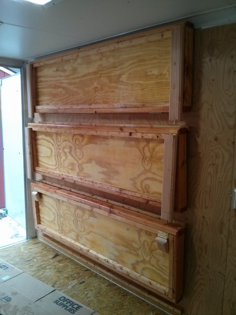

Postby wanabxtrm » Sun Mar 22, 2015 7:13 pm
Do the bunks fold flat to the wall?
wanabxtrm
Posts: 100
Joined: Thu Aug 14, 2014 3:53 am
Re: PA Wilds 16 x 7 x 7 Bug Out Aluminum Trailer
Postby outsidezion » Sun Mar 22, 2015 7:15 pm
wanabxtrm wrote:Do the bunks fold flat to the wall?
yes
Bunk 2.jpg (104.24 KiB) Viewed 3196 times

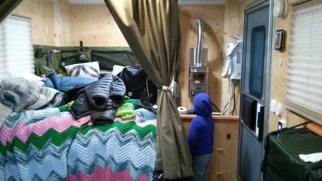

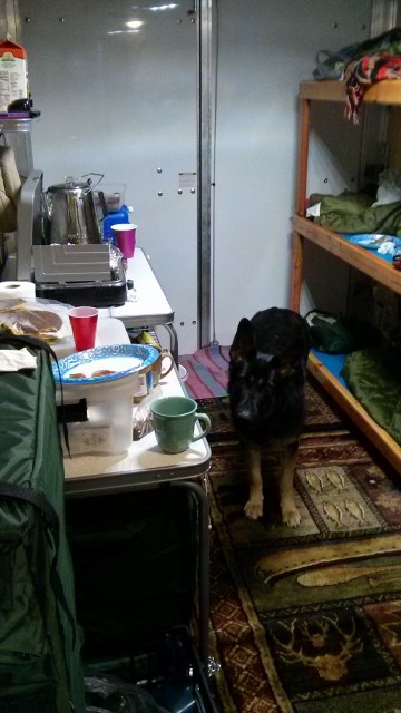

Postby outsidezion » Mon Mar 30, 2015 10:56 am
23 degrees, snow blowing sideways, bitter winds.... Dickinson heater kept it around 60 with lots of in-and-out with the kids and dog.
I am going to cut some insulation to block the two roof vents - heat just pours out there. Also, to warm up a very cold trailer, I may just run the generator for an hour or two to start to power an electric room heater. Once the trailer "bones" were warm it was lovely.

Postby hankaye » Mon Mar 30, 2015 8:05 pm
outsidezion, Howdy;
You may want to re-think the bit about closing off the overhead vents.
I live in an RV and from my own experience as well as that of some others,
it's a good thing to leave them "cracked" open a wee bit. It allows for the
condensation a way to escape before it can form mold. Five humans and perhaps
1 or more furry beasties can generate a larger volume than you may expect,
especially when the clothes/fur is wet or even damp...
Most electric heaters "suggest" an area of 18" between their warm face and any
flammables, do you have that much room to spare?
Just some things to consider ...
hank

Postby outsidezion » Tue Mar 31, 2015 5:30 am
Hello Hank,
That it very interesting input and I thank you for it.
Our days of truly cold camping will be limited both in quantity and duration. Maybe I'll just leave things "as-is". I suspect over summer the thing will be a solar oven with entirely different challenges.

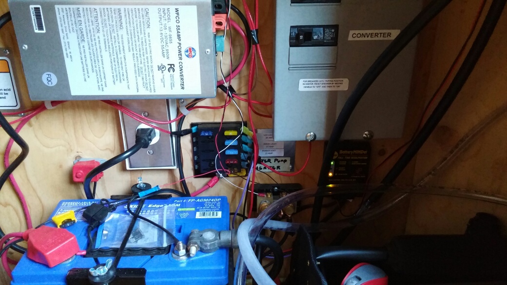

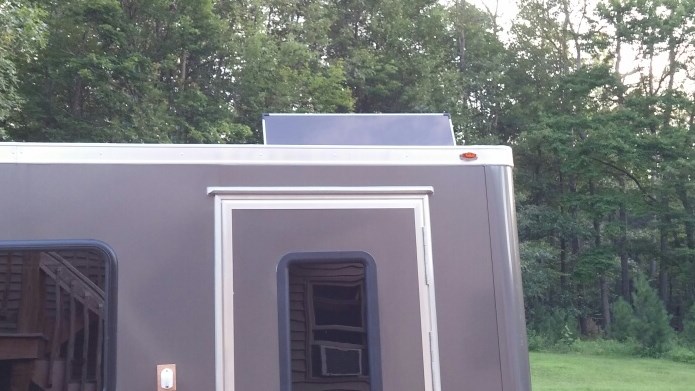

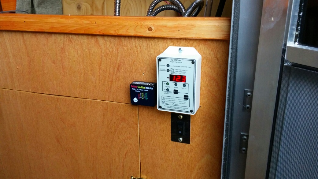

New additions: Solar trickle charger, battery monitor
Postby outsidezion » Sun Jul 26, 2015 6:24 am
Installed the Trimetric 2025 Battery System Monitor
Battery Minder 15 Watt Solar Charger/Maintainer/Desulfator With Panel
Junction box.jpg (220.1 KiB) Viewed 2759 times

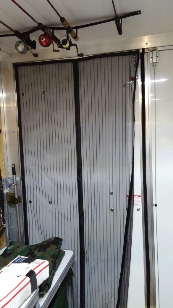

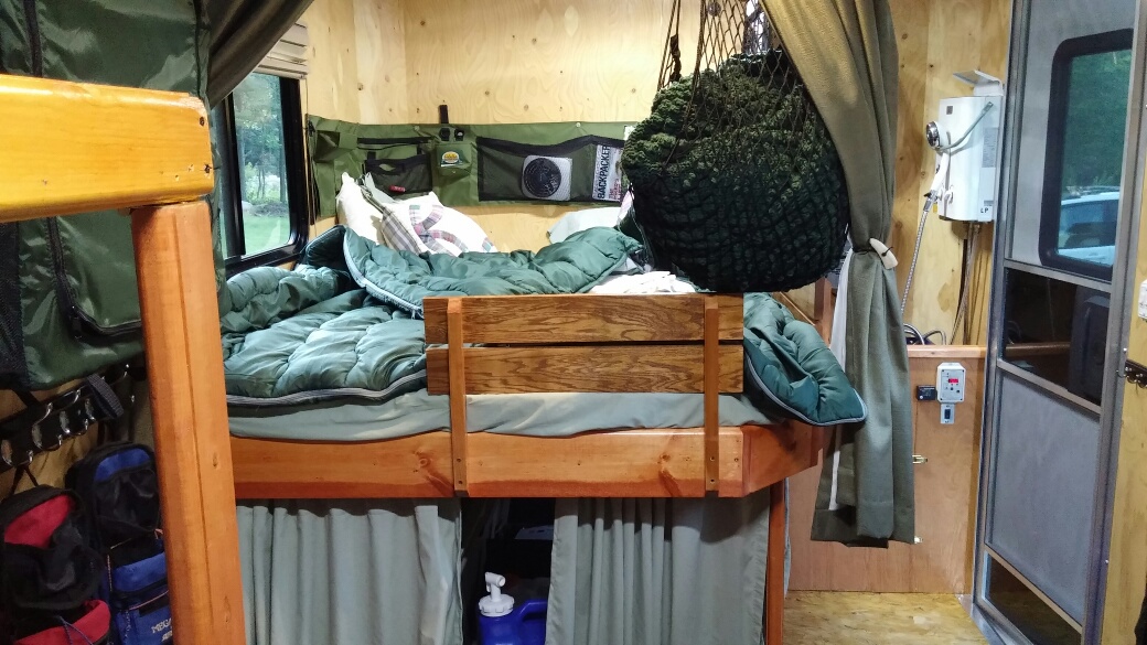

Odds and Ends

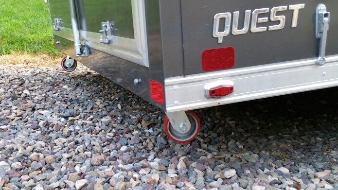

Postby outsidezion » Sun Jul 26, 2015 6:28 am
Overhang wheels, screen panel on rear door, and sideboards for bed
Overhang Wheels.jpg (122.81 KiB) Viewed 2758 times
Side boards.jpg (248.75 KiB) Viewed 2758 times
Postby rebapuck » Mon Jul 27, 2015 2:35 am
Why do you have a sideboard at what appears to be the foot of the bed?
