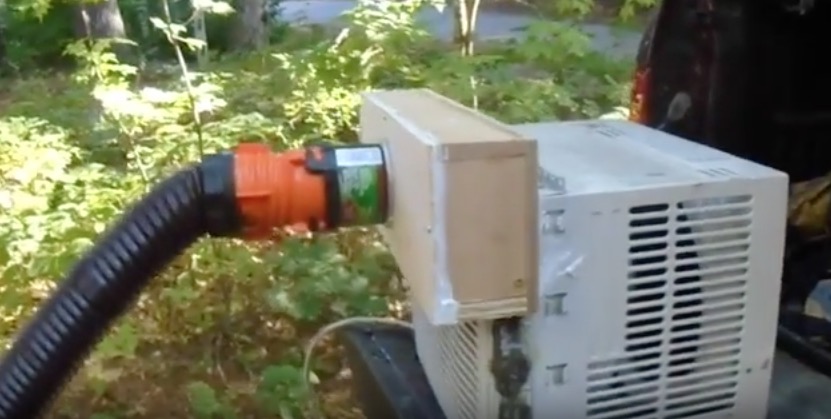

Postby deceiver » Wed Aug 03, 2016 5:37 pm
AC on my tailgate...
Screen Shot 2016-08-03 at 6.44.06 PM.jpg (79.26 KiB) Viewed 5388 times
Well, the cargo converson is going well and we've put about 12,000 miles on it so far. In August we're planning a trip to Colorado partially via route 66. I've only passed through Colorado but never toured it like other states. It looks like there is as much to see there as any other 4 states.
I had a small air conditioner in my teardrop. I'd mount it against the screen on the door. My conversion usually doesn't need AC since we don't travel out west much and we're in Maine. But for Colorado I though it might be nice to have the ability to put in AC 'temporarily'. I took the same air conditioner used in the teardrop and attached it with RV sewer hose to the new trailer. The AC will exist on the tailgate of the truck and attach to the trailer and be controled by the trailers electric heater thermostat. Damn it it doesn't work...
See a video of it in action here: https://youtu.be/U4h7OamiFek

Postby pchast » Wed Aug 03, 2016 8:23 pm
Your 3" hose is a restriction that slows air flow. A booster fan would help.

Postby Gonefishin » Wed Aug 03, 2016 9:03 pm
In the video it shows he's got a Fantastic Fan in an open roof vent. That looks like plenty of ventilation and air circulation for a 3" intake.

Postby deceiver » Wed Aug 03, 2016 9:36 pm
pchast wrote:Your 3" hose is a restriction that slows air flow. A booster fan would help.
:thinking:
The goal is to cool the trailer the easiest way. The AC is a 5000 btu bedroom one. I'm doutful that the unit itself could push air out more than the 3" hose can keep up with. The max fan in the cieling actually isn't to vent the air from the trailer. The trailer is sealed enough that it acts as a booster fan. When I turn it on I can tell the difference right away in the volume of air that is sucked in. When I open the door I can feel the rush of air as it's cracked open.

Postby deceiver » Wed Aug 03, 2016 9:40 pm
lrrowe wrote:In my posts on my CT AC hack efforts, i used 4in tubing and I recirculated the cooled air pumped into the trailer. I also added two fans on each duct to help the air movement. On the hot days of July, I was never really happy with the cooling results. During our recent camping trip at Fort Chiswell, my system did not even keep up with the cooler night ait temps.
Then my wife got sick afterwards with issues with her lungs which her first doctor questioned if it was from the hacked AC unit which I keep on the ground when used (mold, mildew, ??). I do not believe this to be so but to be safe as she was hit pretty severely with the lung issue, I am scrapping the whole AC hack idea and putting the unit in the walls just like a window unit.
I will post pictures and more issues with the plenum box I built in my build thread over the next few days. I will add that after just a few hours of being installed the "typical" unkacked way, the results were significantly better.
When I tried the AC before installation I turned the AC unit on and no matter how hot the air was the output was cold air. I thought that I could keep it simple buy not recirculating. The hose and ac are dry right now. I hope I don't run into the same thing you did with the possibility of mold. We won't be using it much and I think I can keep it fairly clean. Thanks for the tip. Looking forward to your pictures.

Postby m.colley » Thu Aug 04, 2016 5:28 am
deceiver wrote:When I tried the AC before installation I turned the AC unit on and no matter how hot the air was the output was cold air. I thought that I could keep it simple buy not recirculating.
Deciever,
Herein lies the the root of your problem, and there are multiple issues. The 3" hose is one, the no return air recirculating is another. Right now what you have created is basically the same thing as one of the portable AC units. The are numerous threads on this forum as to how well they DON'T work and why they don't work. The only difference being your unit sits outside.

Postby deceiver » Thu Aug 04, 2016 1:22 pm
Deciever,
Martin
Are you sure? Being outside means the heat from the exchanger stays outside. This morning the temperature outside the camper was 81, inside it was 84 degrees. I put the unit on and turned on the fan to draw the air in through the ac hose. An hour later this is the temperature on the indoor/outdoor thermometer. And I can feel the cold air being pushed by the AC and pulled by the ceiling fan. The air is cold from the hose. The air outside is hot. If this is impossible to make work then I guess I'll take it. But, I know I don't know everything. I'd like to know why it doesn't work. I don't have an indoor portable unit here. It's outdoors. And yes it does produce a lot of moisture on the ground, just like a dehumidifier. And I know it's coming from the outside air. Doesn't matter as long as it's outside.
