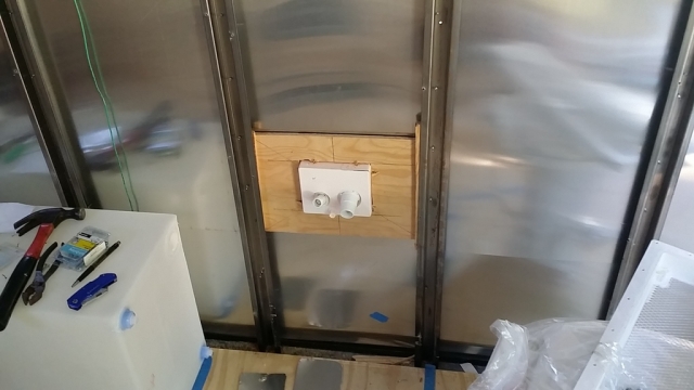

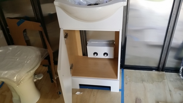

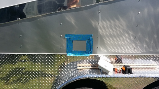

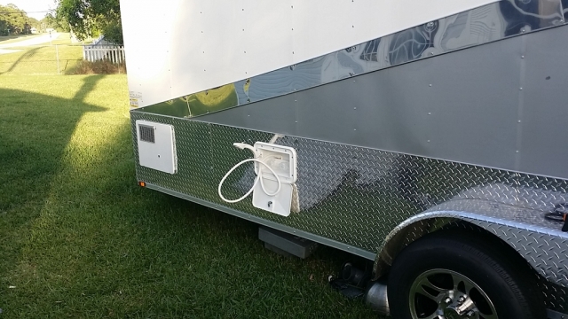

I got home tonight with the goal of spending an hour and a half on the build. The outside shower is installed. The cargo hauler is starting to look like a camper with all the stuff on the sides now. I have three more holes to cut on this side. One for the water inlet, one for the AC Vent at the top near the wheel wells and I bought a 13 inch Portal Window for the bathroom. My wife wanted some natural light in there and I really didn't want to cut in a skylight. The exhaust fan I bought is a 6 inch diameter stack type and does not really let light in.
This will be handy for cleaning up outside if I get real muddy riding... or just to rinse the salt off after the beach. :thumbsup:
This placement was something I needed to be sure lined up. The vanity will hide the enclosure sticking through the wall, but will also tap off the same Cold Water and Hot Water supply as the sink.

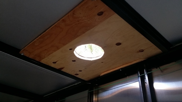

Postby flboy » Tue Apr 19, 2016 8:40 pm

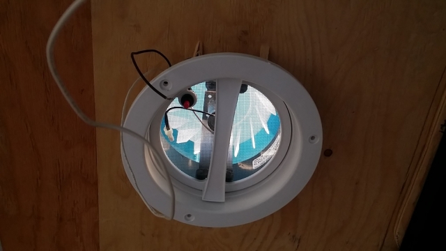

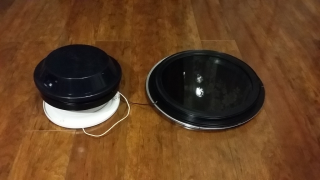

This is the vent and Port hole window I bought for the CTC. I really did not want another crank up vent on the roof since there is already one in the main area. The fan in this vent is a 200CFM fan, so I imagine it will do a good job of venting the steam from the shower and whatever other gases may be present. :shock: The window is something to let some natural light in. I have limited options on where to install the window on the wall; however, I want to make sure the lines on the outside look good also. We''ll see. :thinking:

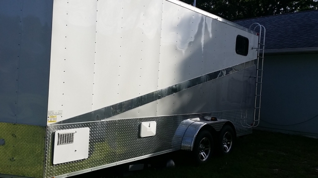

Re: 7'*18' V-Nose Cargo Trailer Toy Hauler Conversion
Postby flboy » Mon Apr 25, 2016 6:57 pm

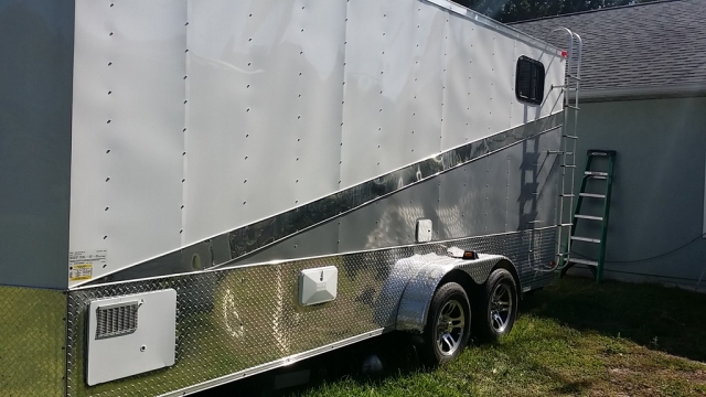

I was able to get the other side loft window in tonight. I still have bracing to do on the inside and to screw it all down well, but the hard part is done. I have another large window for this side to install, but I want to wait to get the dinette built on the inside or at least roughed in so I can be sure the window is centered on it and hung at the perfect height for looking out while setting at the table.

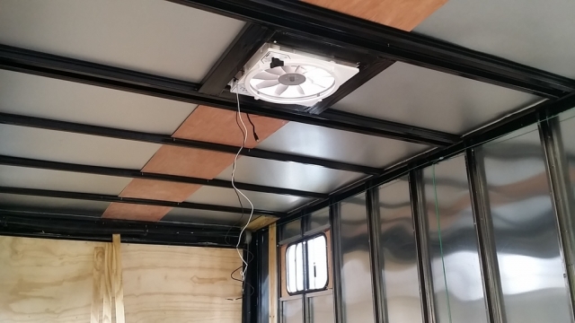

Postby flboy » Thu Apr 28, 2016 6:29 pm
I installed the bathroom vent fan after work tonight. Of course it needs to be wired and trimmed once I have the ceiling installed. The fan specifications state it pulls 200CFM. We'll see. In any case, it should be adequate for the bathroom to draw out steam from the shower and etc.. :applause:

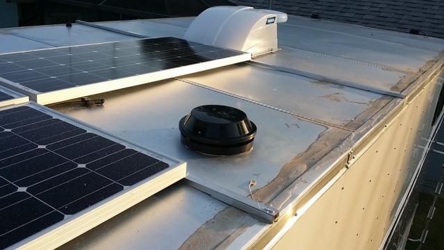

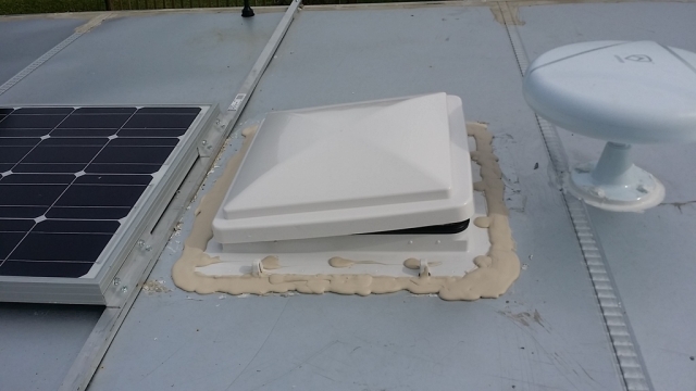

Postby flboy » Sat Apr 30, 2016 4:37 pm
Well, I didn't get the AC Vents cut in yet this weekend, but it's not over yet. :D

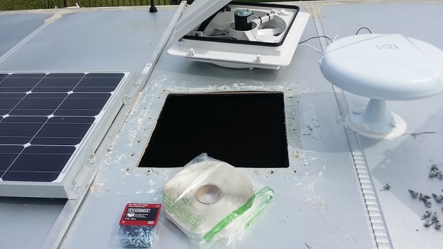

I did get the old vent out and installed the new Maxxair vent with fan. This is going to pull some air. It has a real hefty motor in it. The Dicor is still leveling... so I expect that to look a little better when cured.. I gues it don't make any difference when it is on the roof... as long as I have no leaks.. I'll call it a success.
Running down to Home Depot to get a few things I need to start building the A/C sidewall bracing and roof Vent hole. I'll post some pics if I get it all done. :-)

I ran out of time this weekend for the AC Vents, but I did get one more thing done today. I got the left side gravity fill and city water inlet cut in. I have a gravity fill for the other side tank that needs to be installed also.
