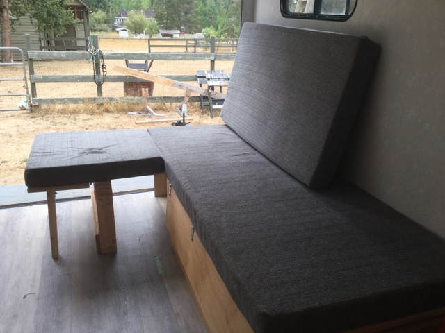

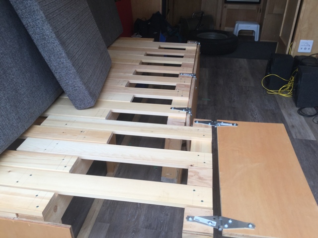

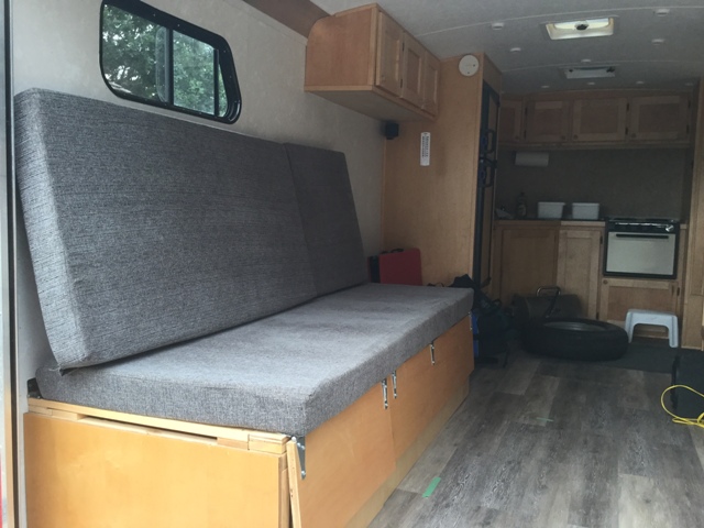

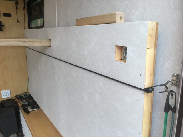

Bed Construction pretty much complete.We have a full queen and a single. When all down the whole back of the trailer is a bed. During the day the single if folded up to the wall and the queen is in an L shape and can also be used with the table if eating indoors. The wife cut the foam and sewed the covers for the queen, the single is next for padding. The addons in plywood are hinged with folding legs so when tucked away they all close up flush inside the storage area.
QueenSize Bed.JPG (114.85 KiB) Viewed 1523 times
Bed Construction.JPG (113.53 KiB) Viewed 1523 times
As Couch.JPG (111.99 KiB) Viewed 1523 times

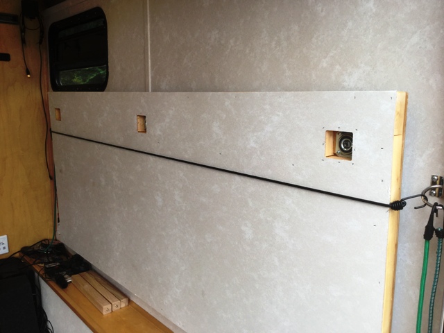

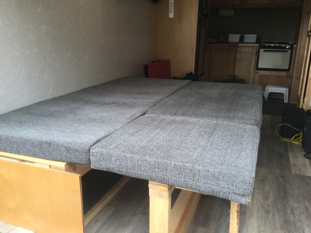

A few more pics of the bed
Single Legs.JPG (99.34 KiB) Viewed 1522 times
Single Bed Folded.JPG (104.51 KiB) Viewed 1522 times
Table Setting.JPG (122.23 KiB) Viewed 1522 times
cdub
Posts: 46
Joined: Wed Apr 20, 2016 3:50 pm
Re: New to Forum New Project
Postby cdub » Tue Sep 05, 2017 5:05 pm

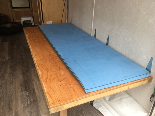

And the single when in the down position.
Single Down.JPG (107.46 KiB) Viewed 1521 times
